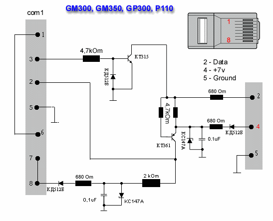

    Hello colleagues!
    I have to "talk" with the Motorola Gm 350, for this purpose I am asking my esteemed colleagues for some RIB diagram and working soft, I know that the topic has already been discussed more than once because I looked at the posts, but not everything is probably up to date, I am interested in your equipment on which you support the GM 350, thanks in advance. (2m version of GM350)
  • #2 1511752
    yes2mike
    Posts: 3054
    Help: 258
    Rate: 322
    RIB on transistors - works, checked:
    And soft ...
    • Gm350.zip (554 KB) You must be logged in to download this attachment.
    • Find Solutions for Motorola GM 350 on Expert Electronics Discussion Forum rib.gif (15.67 KB) You must be logged in to download this attachment.

    This is how I see that the Rib to which Jacek gave the link in the Max 232 part is almost identical to mine to fth, it is tempting to make a rehearsal in a free moment, but maybe it's wrong and it won't go, you can always do it then " neat "on transistors, which will fit in the plug and will be ok. Thanks a lot for your help.

    Hello, I have made it on 7 transistors and this on max232 and they work without any difference

    Hello, I have solved the problem, the system works on Max 232 and works fine, best regards.

    on a max of 232 SN 7407 there was once an interface scheme for gp300, I tested the gm 350 and it was flawless, from what I remember when I was flown on the pages, these programmers were recommended for GP, it was all based on this diagram above, included in this post, but for example Mc2100 I was not able to erush to the maximum, I also want to make two programmers, especially that their cost is not high

    Gm and Gp 300, 350 etc. have only two wires: BUS and GND ... I use RIB on transistors for such motorcycles ;)
    transistor ones fit this type of equipment (two linines), but I am struggling with BUS +, BUS- and GND ... The voltage seems to be the same.
    A. The exception is GP640 (I have not checked on another one) - I don't want to talk to this RIB ... But I will ;)
