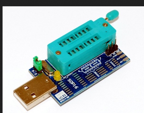

    Hello, I would like to read the bin file from the MFD2 radio, I just don't know which programmer to use?
    #2 16211962
    Piotr520
    Posts: 1186
    Help: 68
    Rate: 243
    It depends on what layout you have there. I don't do radio, but 24CXX, 24XX, 93CXX are popular circuits and sometimes you just need a simple programmer. First you need to know what you want to read.

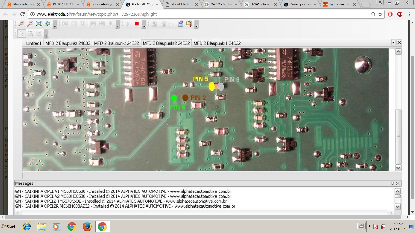

    #3 16212005
    coperfild
    Level 35  
    Posts: 2760
    Help: 291
    Rate: 1697
    Power supply for p6 SDA, p2 SCL, p5 VSS radios memory is 24c32
    MFD2 Radio: Seeking Suitable Programmer for Reading BIN Files MFD2 Radio: Seeking Suitable Programmer for Reading BIN Files
    Hello. The memory is FIS, and it reads like 24c32. Because the author of the post will ask the question that there is no 8 pin memory there, which can be seen in the attached pictures at a friend's coperfild. Best regards.

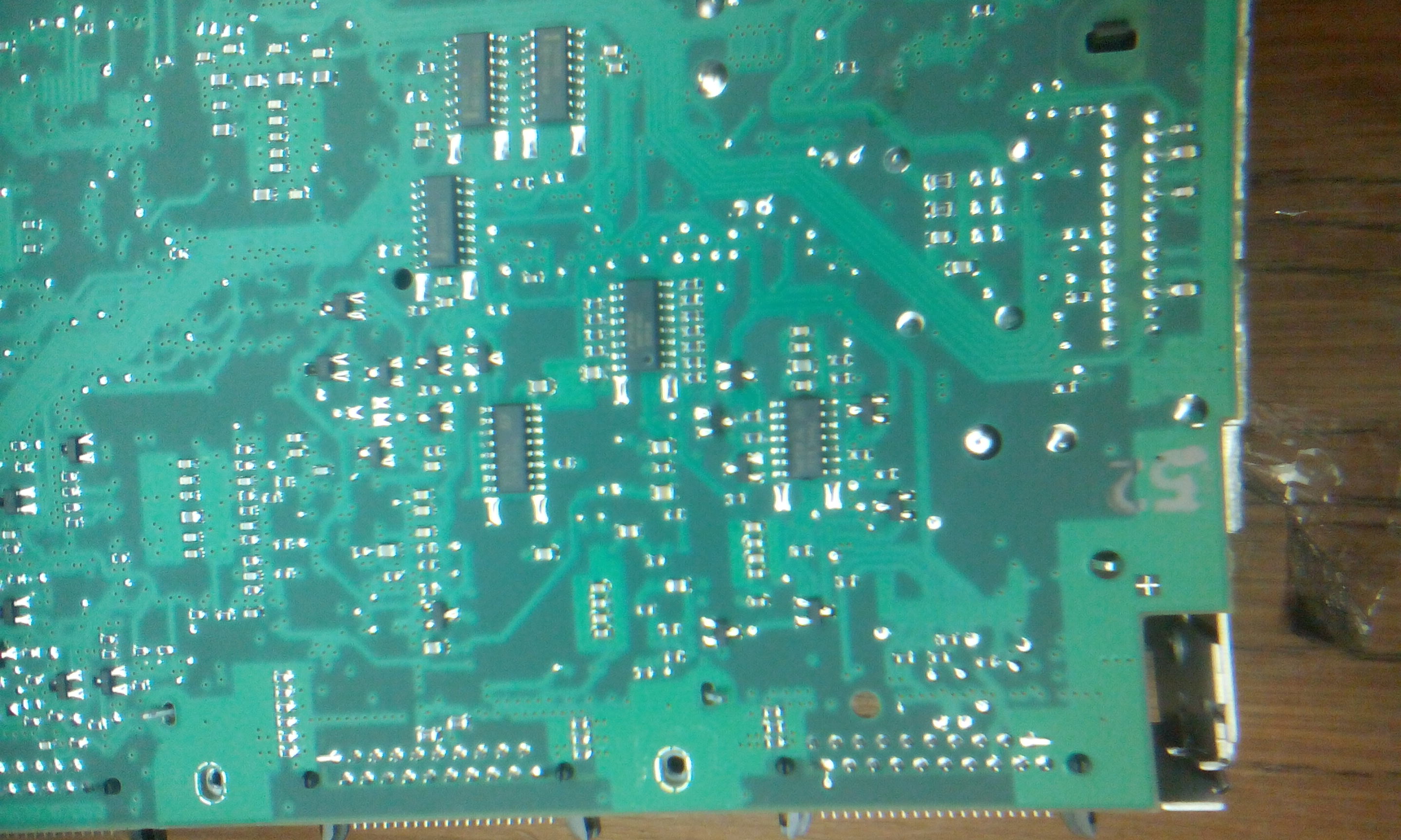

    it means that 4 pins should I connect to the programmer and give power on the radio as it is in the picture ?? I just need a programmer for that?
    what does it plug in there can I buy such contacts for connection?

    #6 16215587
    korek516
    Level 25  
    Posts: 446
    Help: 101
    Rate: 146
    Hello. What 4 pins? after all, you have three pins SDA, SCL, GND. If this programmer reads the I2C bus, you can easily connect. Best regards.

    Okay, I have to connect only sda and scl, i.e. nr.6 is sda and number 2 is scl. nothing more I do not connect to the programmer, only the disc as it is in the picture under 12v ?? or should I connect gnd from the programmer to any of the pins ??
    Hello. Yes you still need to connect GDN or ground. Best regards.
  • #9 16216383
    malimaro
    Posts: 955
    Rate: 159
    Good thanks, now I know vss to gnd

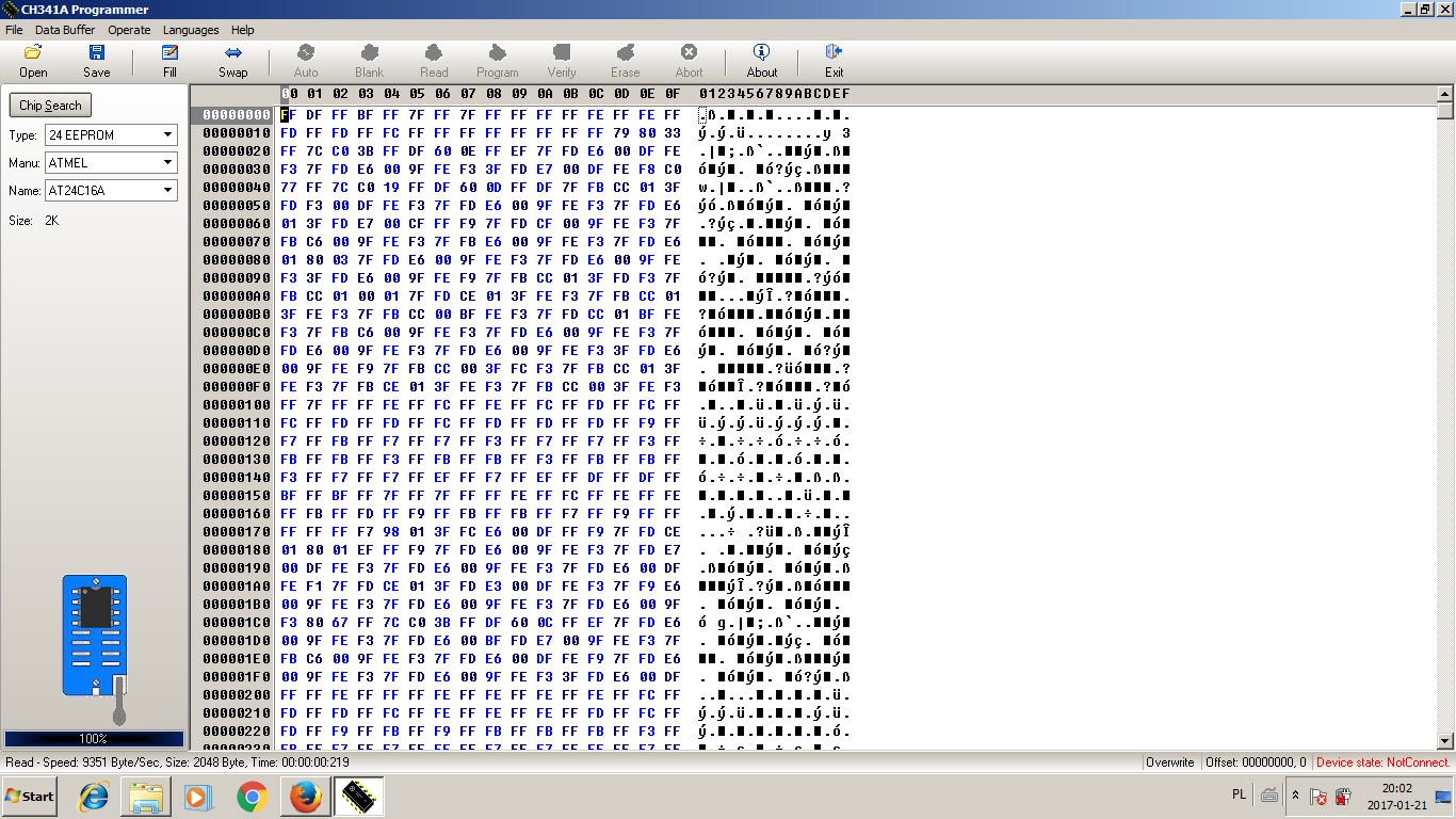

    UFF succeeded, I read ch341a programmer memory, I have this bin file, and now what should I do there exactly ?? Can I change and save it with this program? I upload a file, a picture from the program and ask for help

  • #10 16217468

    #11 16217585
    sanixmen
    Posts: 48
    Help: 34
    Rate: 61
    malimaro wrote:
    I mean, should I find a bin file from another radio and upload or replace lines 20, 40, and 60 from the radio with a known code ?? can you put it in manually ??
    Can it be read with some calculator ??
    bad dump, read as 24C32
