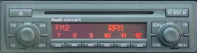

    Hi. I bought a 2003 Audi A3 8P with the original Audi Concert radio and pulled the fuse unfortunately it scrambled and I didn't get the code when I bought it. How can I decode it?

    Remove the radio, maybe the previous owner wrote the code somewhere on the housing.
    Other options:
    ASO, and with the serial number of the radio to them, cheap will not be cheap.
    Magicians what will read the memory from the radio and find the code, or program the radio with a batch with a known code.
    Internet/forums, with the serial number of the radio, maybe someone will generate the code.
    On Elektroda no one will help you with generating a no based on SN, the rules prohibit it as I remember.

    Sorry to link to the topic. The eeprom has been read and is the data correct. Any chance of a hint as to what the code is, or which cells to look for it in? . Many thanks for your help.

    Western forums have helped, thanks. Ours make sure to read the regulations. For those willing, the data is correct and the code: 1567, maybe useful to someone.

    In my case. At first I had to read the EEprom and then I left it on the forum https://radiocodez.com and someone gave the correct code. However, when I got a little interested in it, supposedly the code is coded according to the algorithm anyway. However, I didn't go into it because I had one radio anyway. Besides, you don't even need to know the conversion just upload the file that I left and the code is known. Some people can even read the code from the radio's factory numbers. I don't know how to do that.
