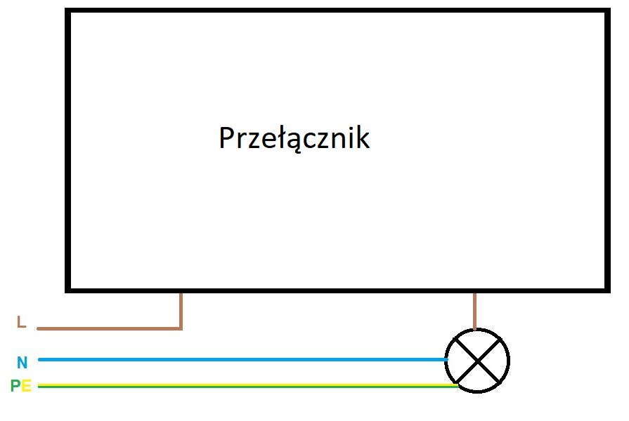

    I'll add my 3 cents for posterity, because I've been thinking about it myself, and as it turns out, you have to encapsulate in levels of abstraction and the problem becomes simple
    i wanted to combine a staircase circuit with the Philio or PAN06
    Diagram of Fibaro Dimmer FDG211 in a staircase installation with bistable switches
    in an earlier staircase asked by colleague @Tomasz Koc
    we can imagine this arrangement as a simple switch
    we just don't think of a staircase switch with 3 wires + bulb + yellow.... let's look at it this way
    and then it is simple - you have to remove the light from the circuit but leave the connection between the two switches (we treat them as one unit so they stay connected)
    Then we supply the switch and PAN06 - line L
    the other end of the switch (remember, we are treating the system as a whole - so the end goes via other cables to the box) is connected to s01
    we feed the bulb with N01 line
    the other end of the bulb is connected to the N of PAN06 and our N (usually blue) in the box
    it works, but yes there is a delay of a few seconds from the key on the wall - from the phone it works immediately
    sorry for reheating the chop - but if anyone needs help then write, I'm using the help so I'm throwing in there too
