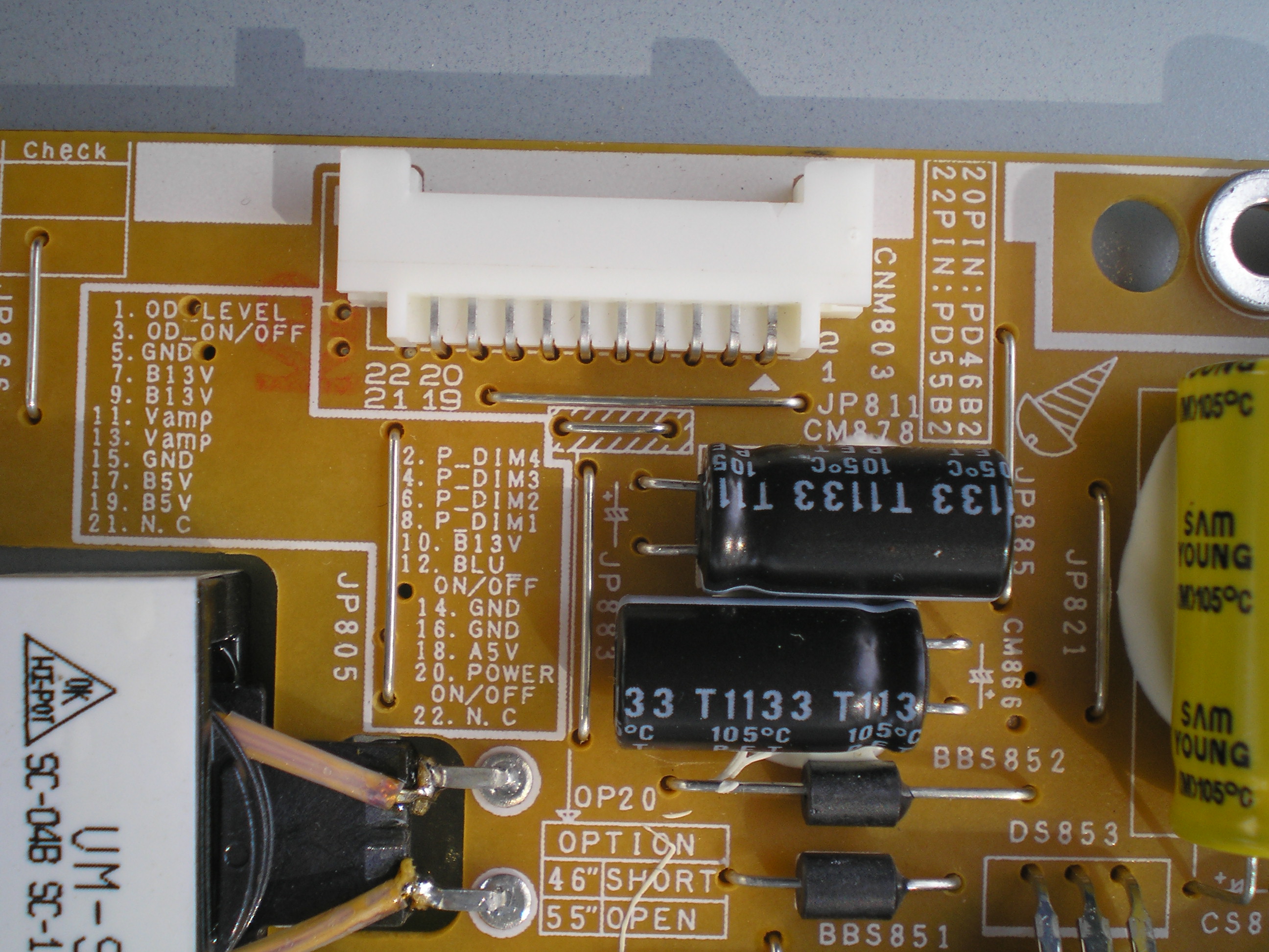

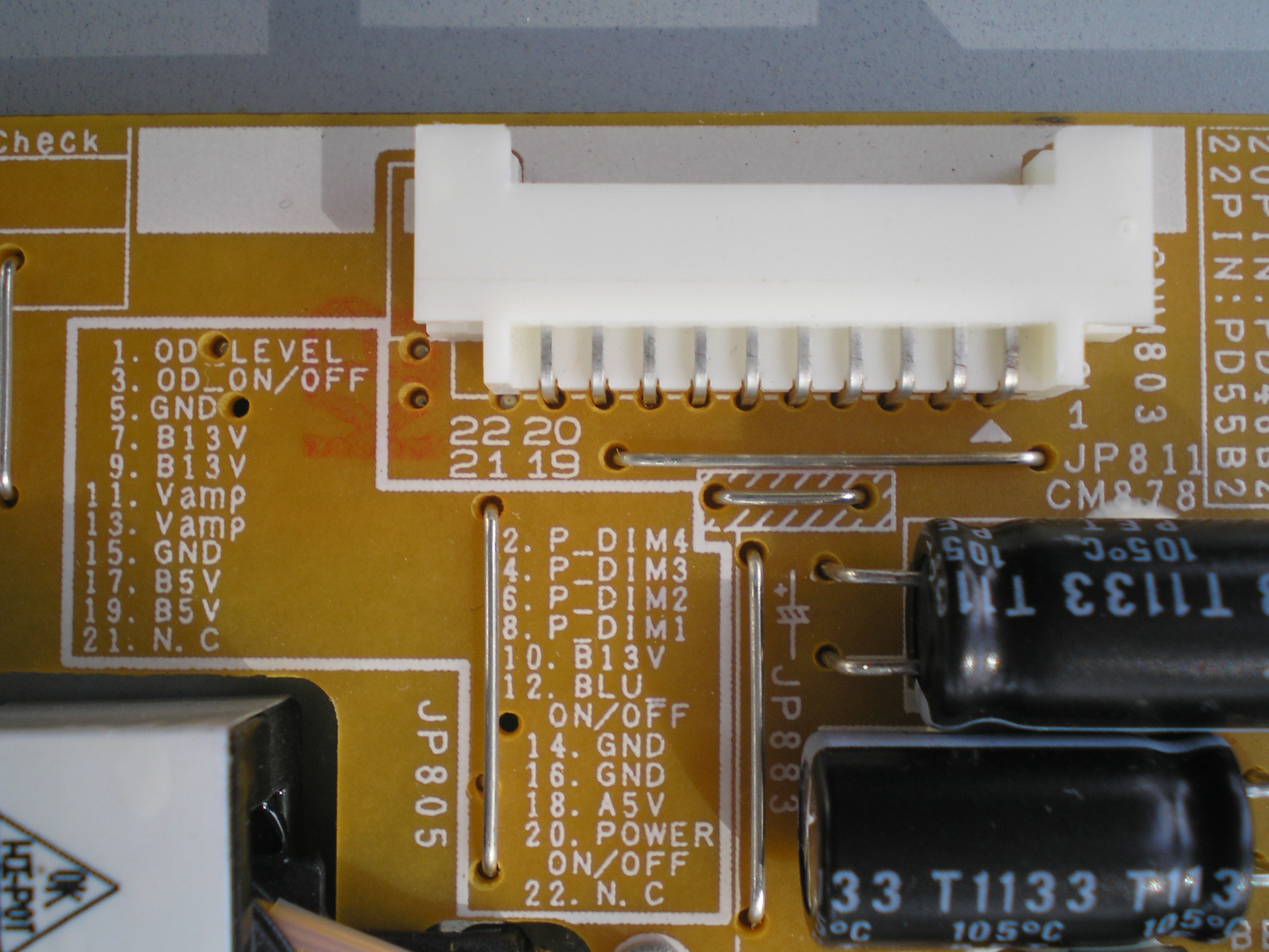

    Hello. Tv Samsung UE46D6500VSXZG Version No.03 after switching on the normal matrix backlight for a while, after a while it dims to about 50%. No picture.
    The St-By diode reacts by blinking on commands sent from the pilot. Power supply BN44-00427A,
    MAIN BOARD BN94-05105Q. After unplugging the Main-SMPS connector from the CN201 socket and turning on the TV, the backlight does not dim. The main board was based on the efficient BN94-05105E (w / g ASWO Samsung-replacement) without a positive result.

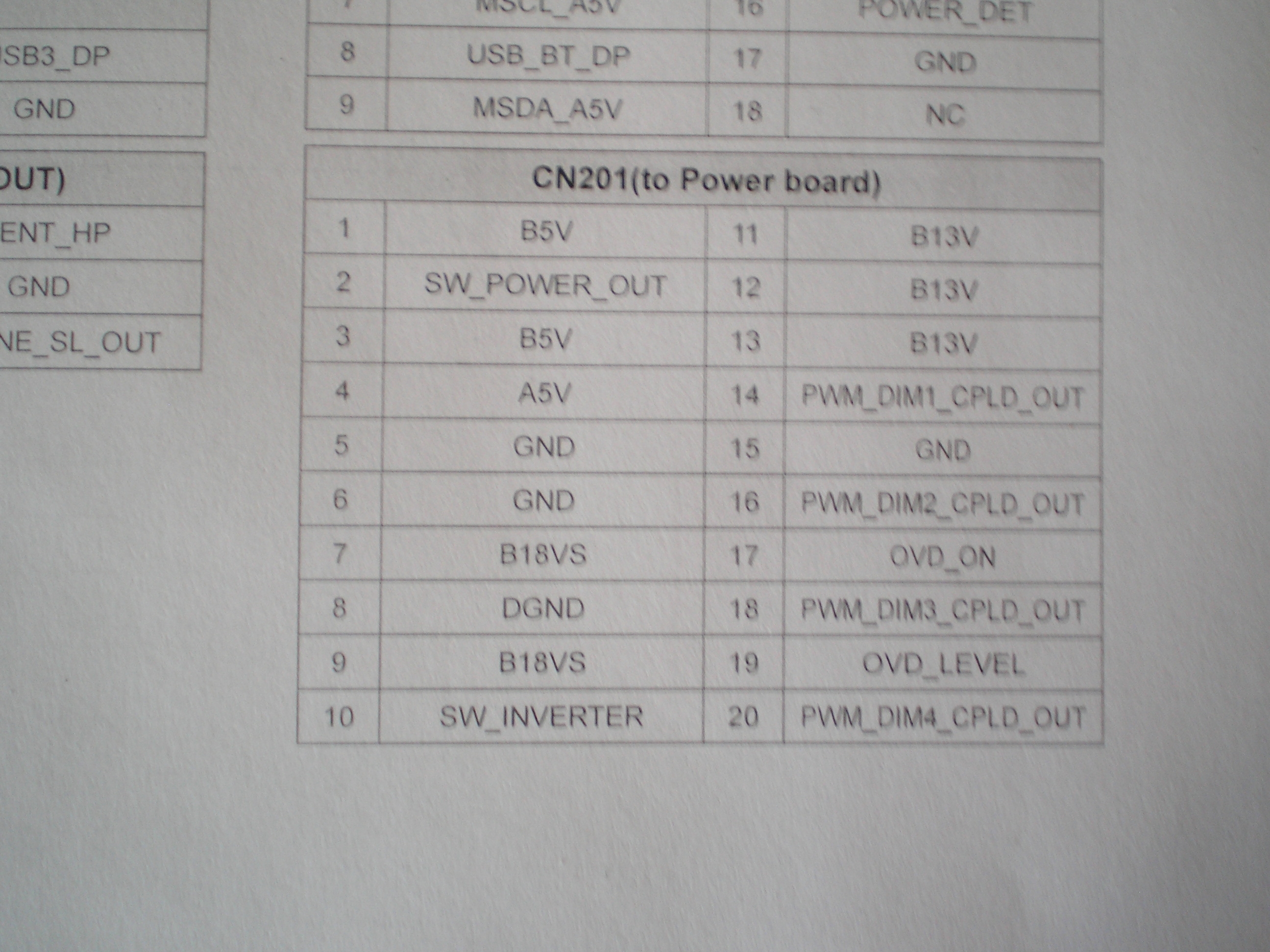

    The substitution of T-CON SH120PMB4SV0.3 also did not help. In the service manual there are pushes the voltage on the CN201 connector but it is quite different than on my power supply board,
    other signals and values. Probably these are the indications for 32 ", 37" and 40 "TV, and others are for 46" and more. I have measured the pins of the CN201 connector with the connector pinned and unplugged, there are differences but I have nothing to compare them with . Help needed. greetings Andrzej

    The service manual is pushing the voltages on the CN201 connector but it is quite different than on my power supply board,
    Unfortunately, the information from which documentation the repairer uses, and also why can not use another, more appropriate, lack.
    Because in my opinion it is the same, although in fact other letters are marked. ;)

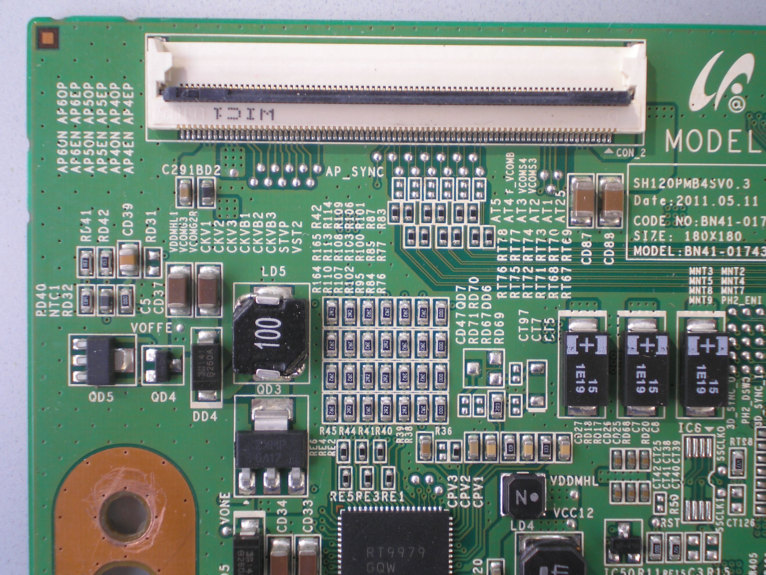

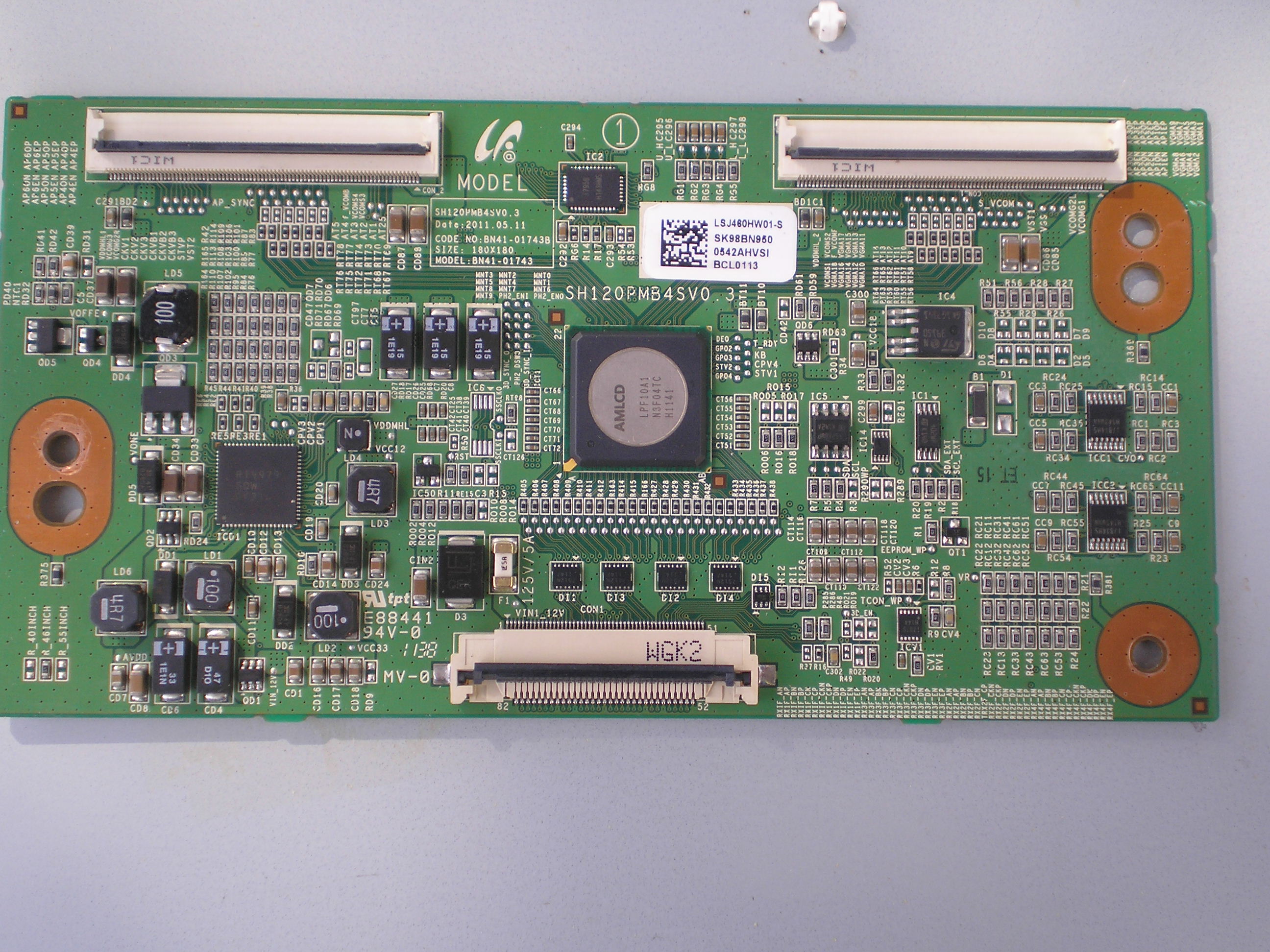

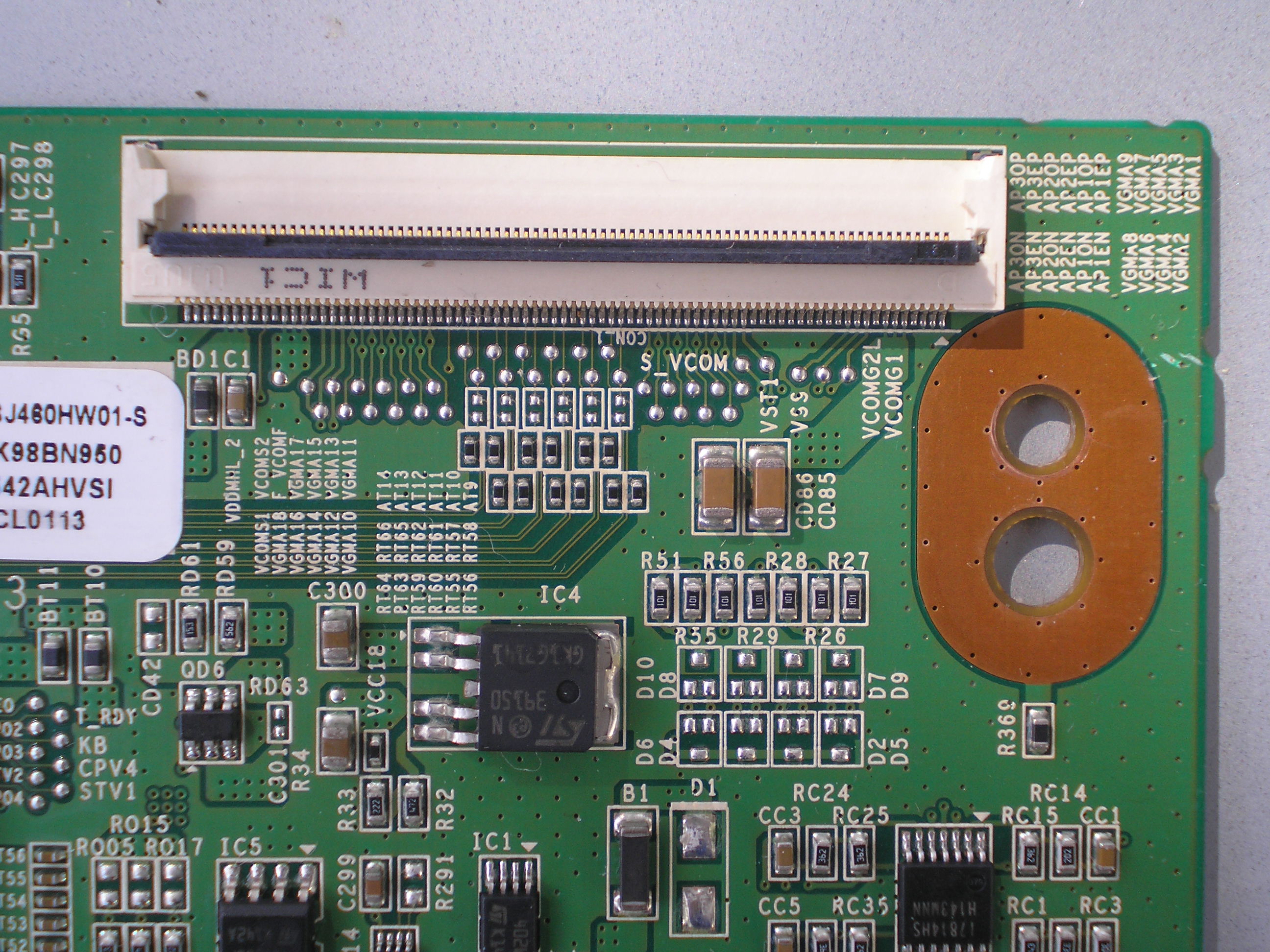

    Kol.mirex I enclose the promised photos in the first place. Samsung UE46D6500VSXZG: Dimming Backlight & No Picture - Tested Main Board & T-CON, Seeking Advice Samsung UE46D6500VSXZG: Dimming Backlight & No Picture - Tested Main Board & T-CON, Seeking Advice Samsung UE46D6500VSXZG: Dimming Backlight & No Picture - Tested Main Board & T-CON, Seeking Advice Samsung UE46D6500VSXZG: Dimming Backlight & No Picture - Tested Main Board & T-CON, Seeking Advice Samsung UE46D6500VSXZG: Dimming Backlight & No Picture - Tested Main Board & T-CON, Seeking Advice Samsung UE46D6500VSXZG: Dimming Backlight & No Picture - Tested Main Board & T-CON, Seeking Advice Samsung UE46D6500VSXZG: Dimming Backlight & No Picture - Tested Main Board & T-CON, Seeking Advice Samsung UE46D6500VSXZG: Dimming Backlight & No Picture - Tested Main Board & T-CON, Seeking Advice Samsung UE46D6500VSXZG: Dimming Backlight & No Picture - Tested Main Board & T-CON, Seeking Advice Now, to Zbyszekskibinski, as you can see in the picture T-CON, there are no marked values about which the friend says in his answer. Secondly, if I had the option of substituting the Main Board with the efficient IC1001i IC601 that are responsible for the VIDEO, why not take advantage of the quick change and the same
    with T-CON ??? The Service Manual I have is terribly trimmed, there is not even a fragment of the diagram. Suspicion falls on the matrix, but how do you check it? greetings Andrzej
  • #16 14664536
    ANDRZEJ DOMARADZKI
    Posts: 297
    Rate: 37
    Hello. Column T-CON = SH120PMB4SV0.3, BN41-01743B, and on a white sticker:
    LSJ460HW01-S, SK98BN950, 0542AHVSI, BLC0133. Label on the plate of the matrix:
    LTJ460HW01-J, D6000-46 "DE82, BN-080344 # 4, SESK. And all made in slovakia.
    greetings Andrzej

    By. my opinion should be to do finally measurements as indicated by kol.SZ in his reply from 27 Apr 2015 01:48.
    This T-con (AMLCD controller LPF10A1) has well-described counterpoints. on the plate what can be seen exactly on Link_ click on the photo.
    VIN_12V 12.3V
    VCC33 3.26V
    VCC12 1.2V
    VCC18 (t_con) = VDD (for drivers) = 1.76V
    AVDD (t_con) 17.1V
    VDDMHL = VDDMHL1 = VDDMHL2 = 8.6V
    VONE 31.8V
    VOFFE -12.2V (* with minus )
    VR 9.9V
    VSS -7.4V * with downside
    It is then necessary to compare these tensions with those of its counterparts on the left and right sides of the matrix
    VDD 1.77V
    VCOMS 6.9V
    HAVDD 8.6V
    AVDD 17.1V
    SVCOM 7.7V
    Or, for comparison, disconnect: the left and then the right matrix tape .... see the effects on the screen
