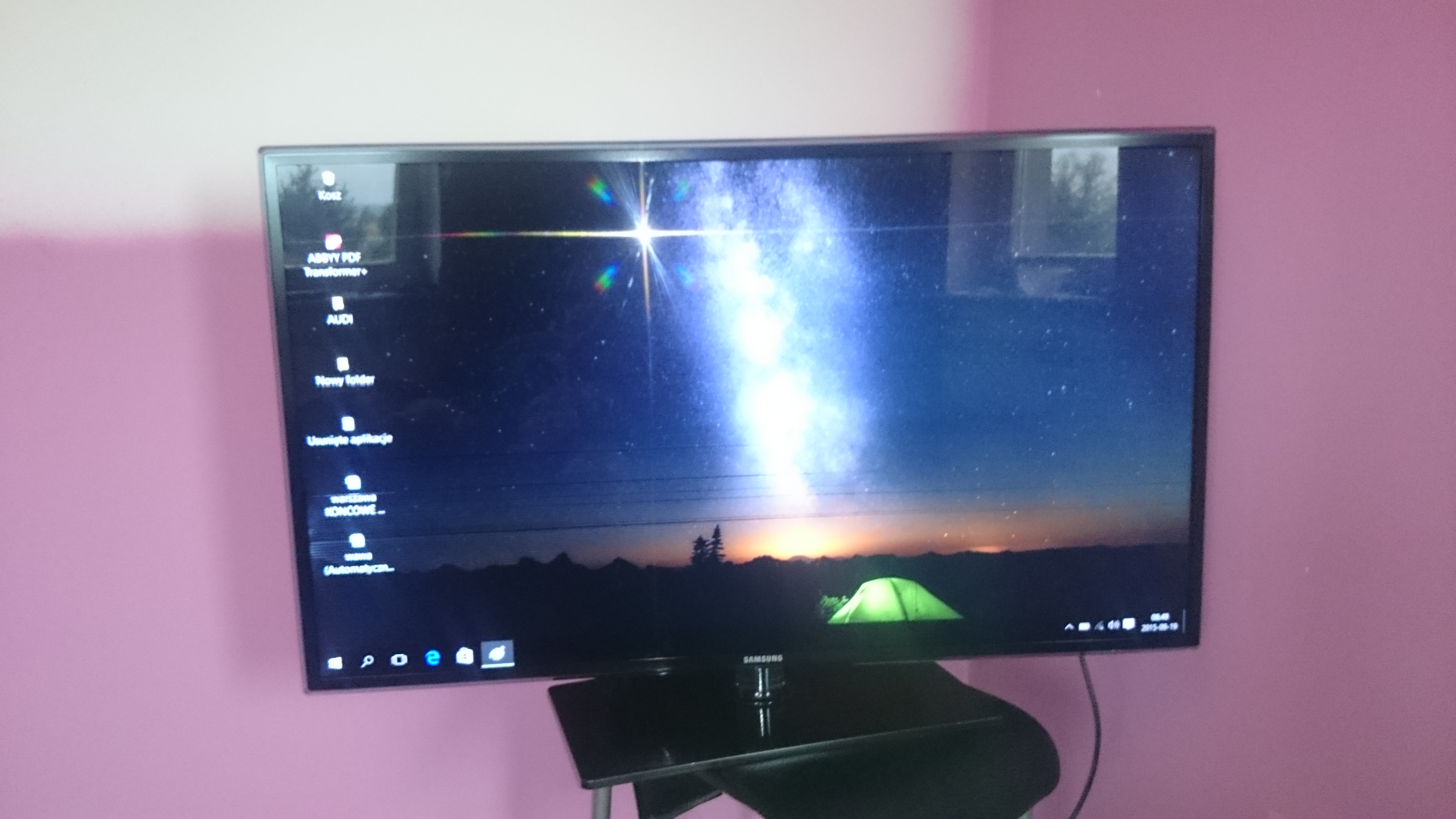

  • #5 15031764
    lolomen
    Posts: 21
    the TV has started but you can see the black horizontal bars from left to right
    the left side where the matrix starts is hot or the matrix is damaged

  • #7 15179544
    5krzych
    Posts: 27
    Since I have a similar problem with this tv model, I decided not to set up a new topic and ask for help here.
    The problem with my TV is the following, after sealing the pin on the flex tape marked in the picture from the t-con plate, the TV started to display the image, unfortunately half of the image is covered with stripes as on the next photo attached, unfortunately I have not found a service manual for this tv and the scheme of this -con, please help or some tips on how to solve this problem, or maybe the problem lies on the matrix side?
    I wanted to add that now the t-con voltages look correct and at the moment when I remove the tape I secured this pin I have only 12V voltage that powers t-con. The voltage on the marked pin, after insulating it with tape, is about 7.58V, when the insulation is not 0V.

  • #8 15670891
    amigos
    Posts: 309
    Rate: 131
    Hello!
    5krzych coped with this problem? Was it T-ton's or matrix's fault?
    In my UE46D6000, it highlights the matrix but does not display the image. If I leave only the right tape connected / looking from the back of the TV / it shows me the picture on the left half of the TV with stripes as in the above post. As it is connected only on the left tape the left side of the TV is bright and the right side is dark but the picture is not there.
    Maybe someone has any suggestions for damage?
    I would like to add that when I plug in both tapes I have the right voltage only on VIN_12V. I do not have any tensions at the other points. Both tapes work. I suspect that the matrix is damaged, but someone can make me :) that way :)
  • #9 15672010
    5krzych
    Posts: 27
    After a few weeks of work, the TV died, the matrix damaged, at least one half, the t-con replacement did not help anymore.
  • #10 15674990
    amigos
    Posts: 309
    Rate: 131
    Thank you for your response. I have identical symptoms to you, so probably it is a specific fault occurring in these models.
    Or maybe in that case someone knows where to buy such a matrix and what price can it be? For me there is the matrix LTJ460HW03-J. Or maybe there is a replacement?
    For me, the matter is resolved. A fake matrix in the upper right corner.
    Greetings!
