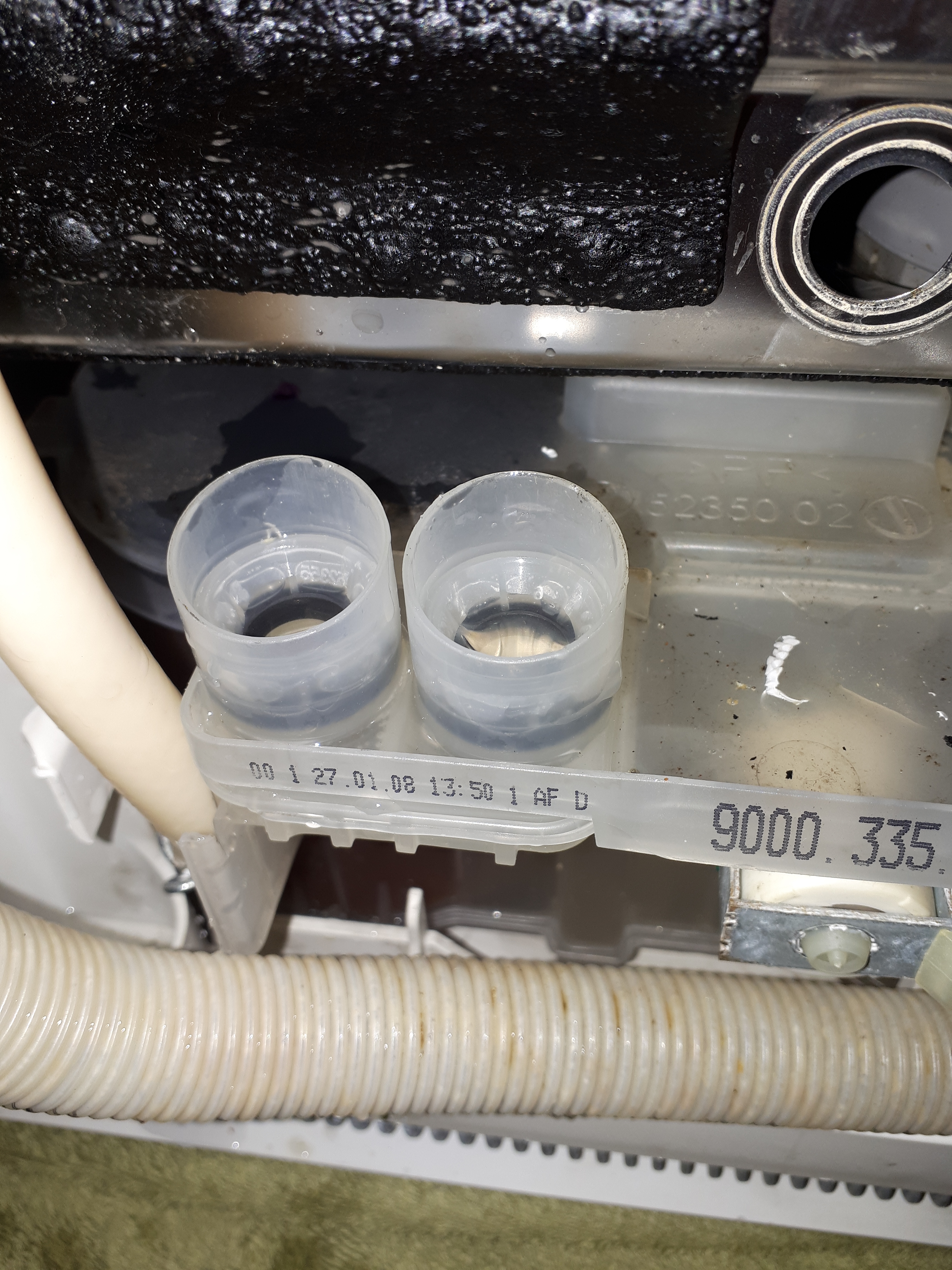

    The bottom of the dishwasher is not fully pressed in and the salt container is too low. At the back, in the left corner, the tank plate is not folded.
  • #32 17660506
    FoQs14
    I considered this option when reassembling the bottom, but the salt tank is rigidly mounted to the bottom of the washing chamber A and the jacket has no clearance for adjustments, so it falls off.

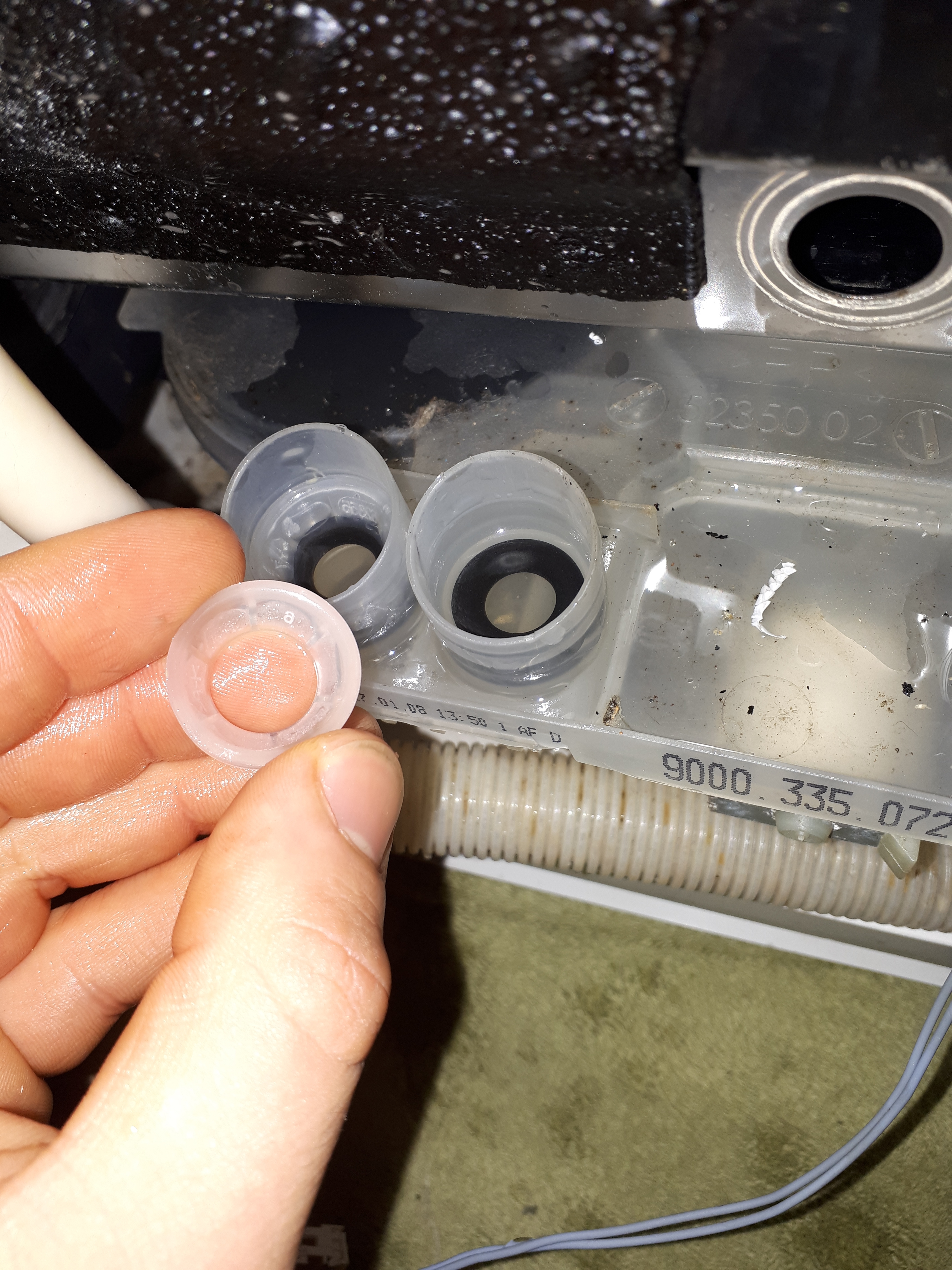

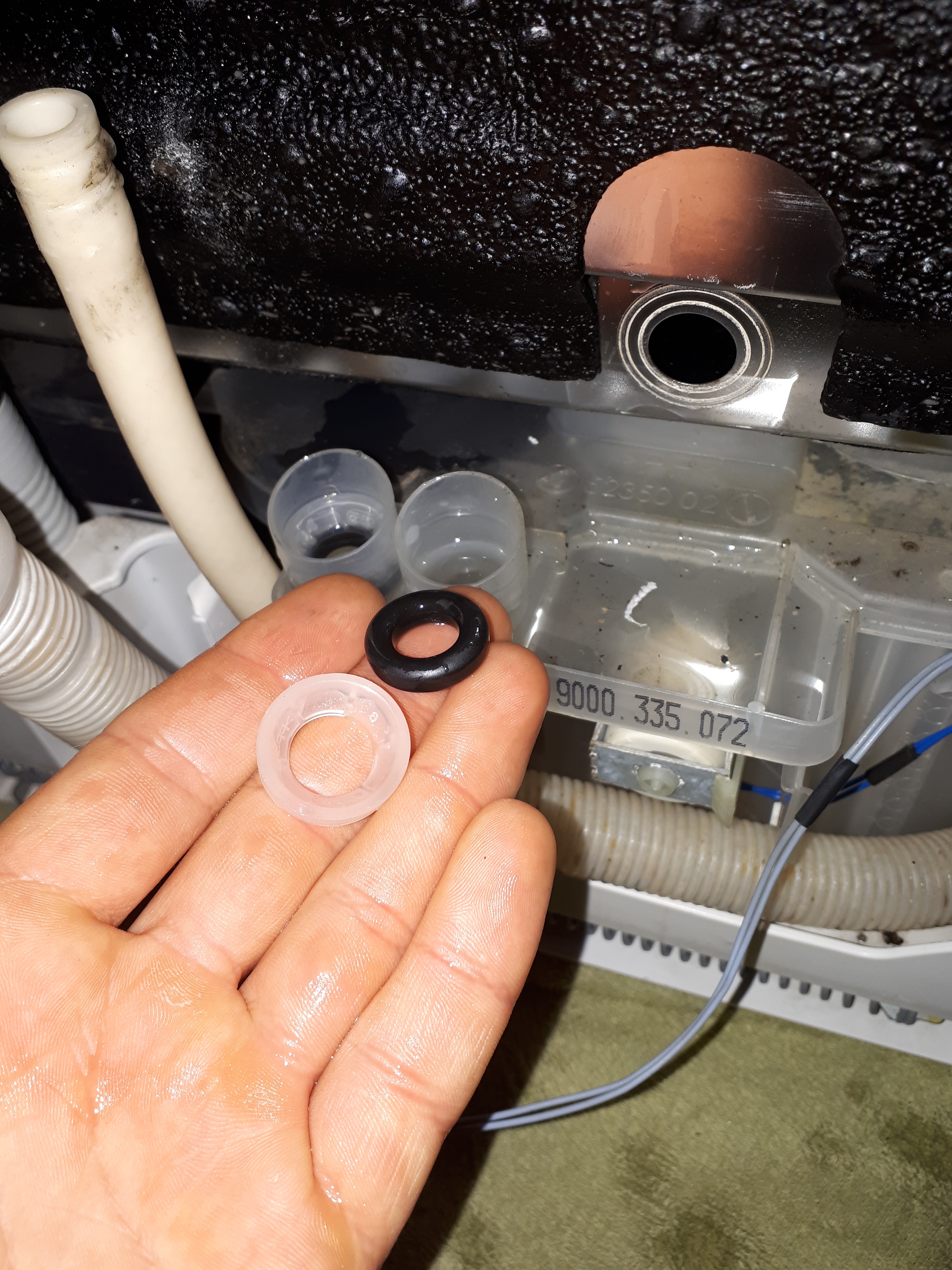

  • Loose plastic ring on tank outlet caused E15 leak
    #34 17660692
    FoQs14
    I don't really know what you mean. Both plates holding the underside of the dishwasher blew off properly when reassembled.
    I started taking the coat off. I already know what the seals of these joints look like. There is an O-ring tightened by a plastic ring mounted on an interference fit. Mantle steps are included in the whole.
    Bosch SMI40M35EU Dishwasher Error E15: Affordable DIY Solution for Leakage & High Temperature Bosch SMI40M35EU Dishwasher Error E15: Affordable DIY Solution for Leakage & High Temperature
    Installed correctly:
    For me, the plastic ring in the left outlet of the tank was loose / insufficiently tightened, which made it float freely together with the O-ring and from this place water spouted, which quickly activated the sensor at the bottom of the dishwasher and the error e15 popped up.
    All that's left for me to do is clean my coat and put everything back together, praying that everything will be tight :)
    But I'll do it after him ..

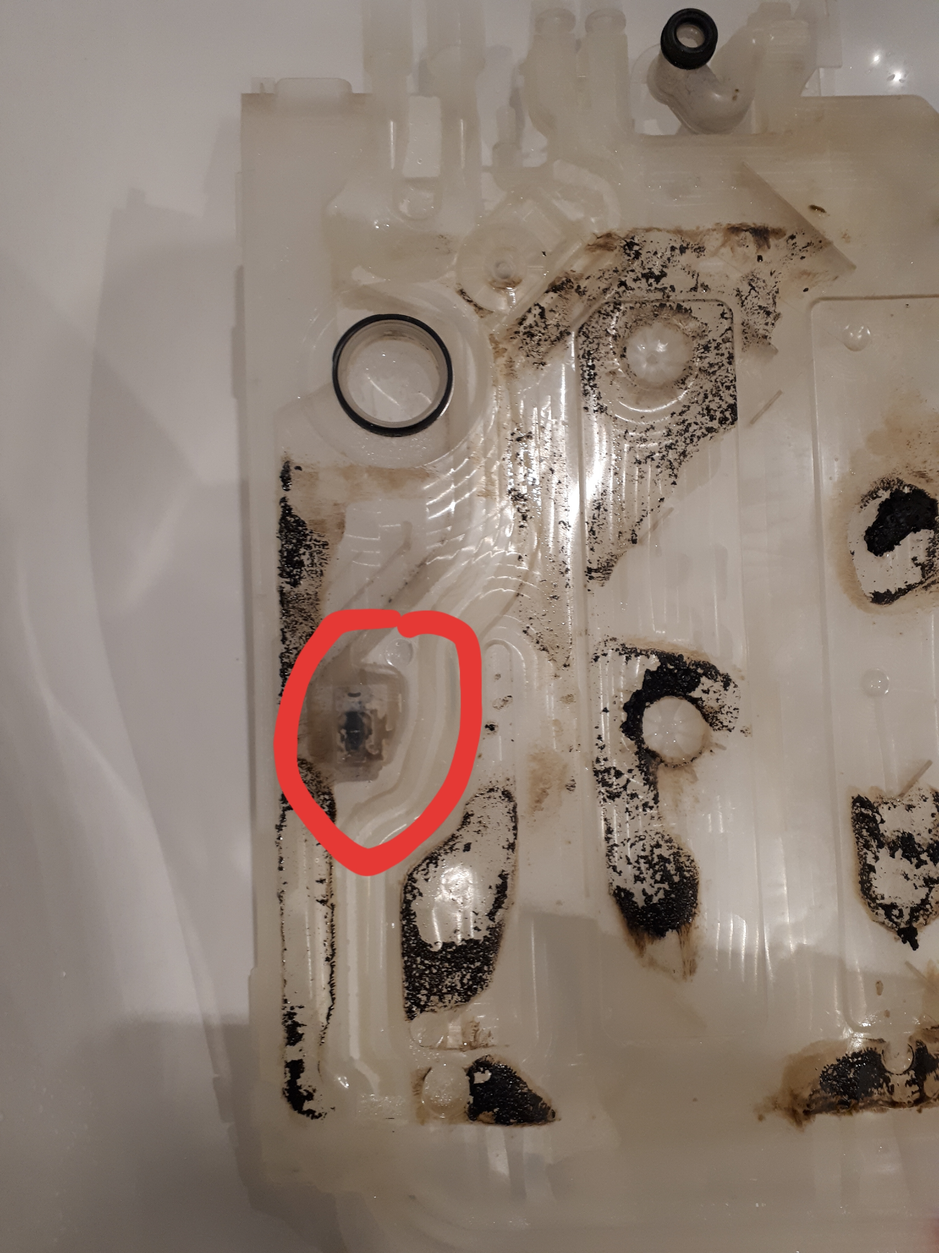

    Maybe someone has an idea how this ring could be loosened? Let me add that the coat was heavily contaminated at this point:
    Could that be the cause? Any suggestions are welcome!
    Edit: Dishwasher folded back, run on the 70 ° C program, everything tight, works as it should.
