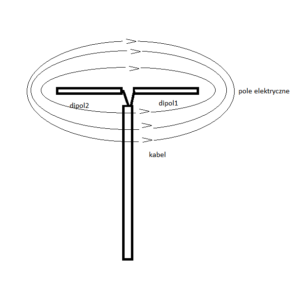

    AND)
    Understanding Antenna Functionality: Comprehensive Explanation Beyond Wikipedia
    What I drew above is this, I understand from what you tell me about a simple dipole.
    We supply power to the dipole and since the dipole is interrupted, the current does not flow and an electric field arises around the dipole. So an antenna with a straight (broken) dipole is an electrical antenna.
    Okay??
    B)
    And I understand well that the loop dipole creates a magnetic field because current flows through it, so a magnetic field must be created. So an antenna made of a loop dipole is a magnetic antenna.
    Okay???

    The electric field leaves the dipole and enters it - not like in the picture, where the line at the top has a right-hand arrow and a left-handed arrow at the bottom.
    A) Yes, it is an electric antenna.
    B) Good.
    C) The "straight dipole" antenna reacts to the electric field - the current flows because the dipole bars are being charged.

  • Correcting dipole field arrows and questioning induction explanation
    #22 14898116
    bombaatomowa2
    Posts: 229
    Rate: 31
    How left-handed? After all, the arrows at the top and bottom point in the same direction.
    Alternatively, draw as you think.
    Does not understand. After all, in school they were breaking that in order for electricity to arise, there must be an alternating magnetic field.
  • Correcting electric and magnetic field node explanations
    #23 14898536
    _jta_
    Electronics specialist
    Posts: 49144
    Help: 3212
    Rate: 4259
    Unfortunately, I do not have how to make a drawing now - but in the figure in # 18 the arrows on the lines contradict each other.
    After all, at school they cracked that in order to generate electricity, there must be an alternating magnetic field.
    That there is a current in a coil connected to a closed circuit. And in the open, it is created in an alternating electric field.
    If you put an electric dipole in a node of a magnetic field, you get a current like in an electric node - no.

    A - If you follow the drawn lines as shown by the arrow, you will hit the arrow in the opposite direction - it shouldn't be like that.
    But I was the one who drew the field arrows at any given moment in time. You know when the field changes, the arrows will be in the other direction. It is like a magnet, when you sprinkle it with filings, they are arranged along the field line between the poles.

    A - And you drew the field lines wrong - for the dipole antenna the electric field lines go into the conductor, see it in Wikipedia.
    Where in Wikipedia?
