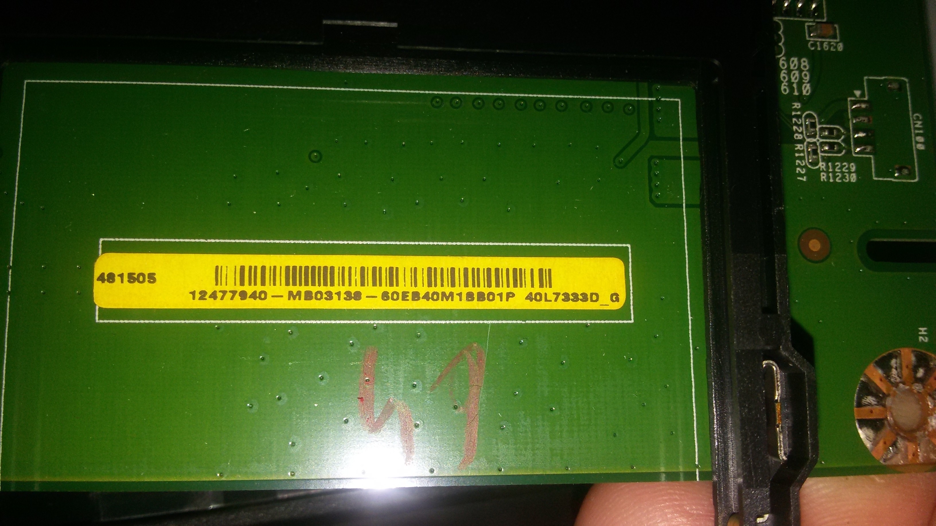

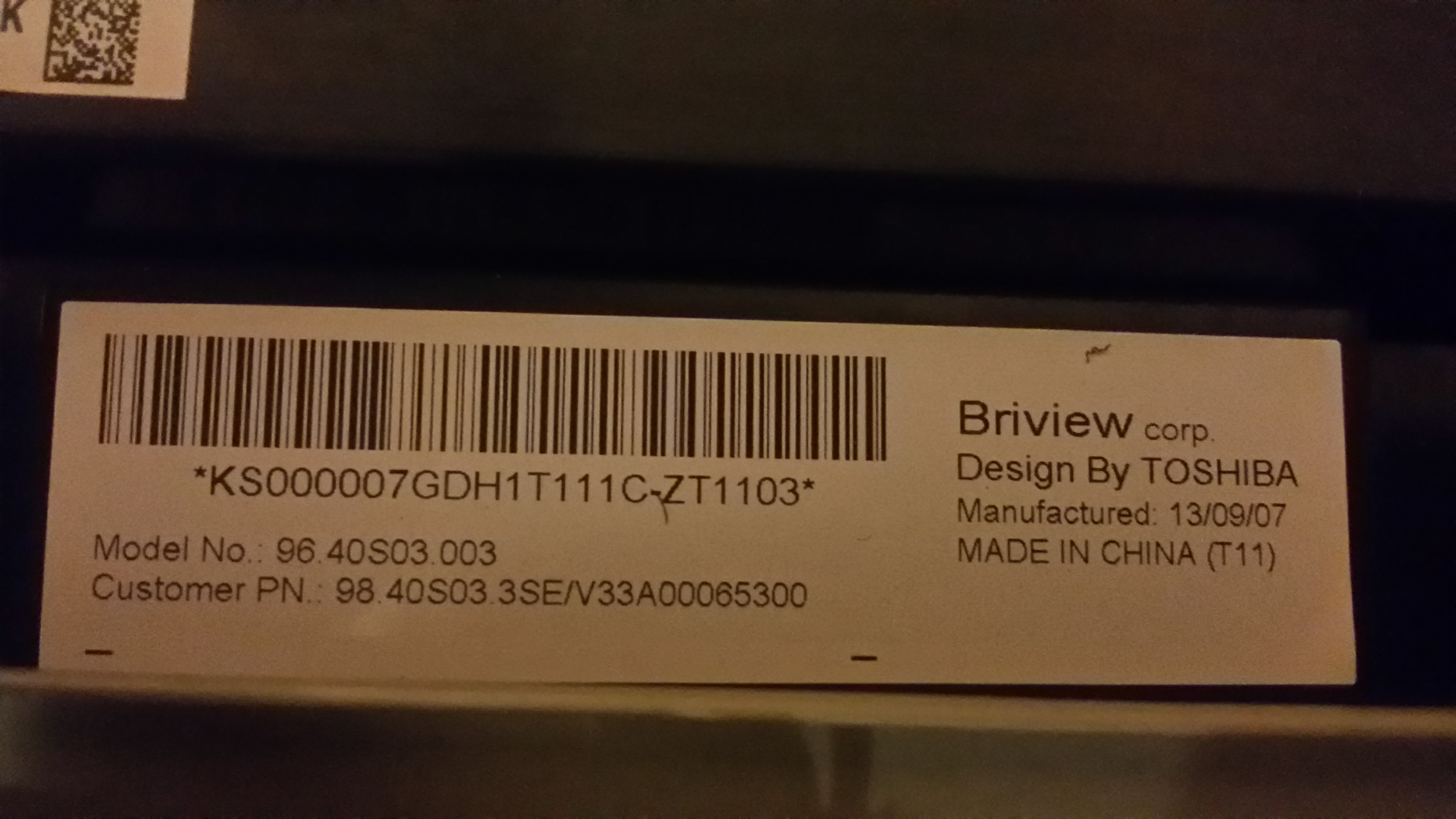

    TV as in the subject, the fault probably occurred after switching off the network, now after switching on it starts with the Toshiba logo and darkness follows, a light matrix backlight is visible, the LED lights up green, no response to the remote control and the local keyboard. According to me, the software has been downloaded, the Toshiba website has no software for this model and I do not know what to do? Perhaps the matter would help load IC122 25Q16CVSIG, a problem with getting. Maybe someone from my friends will help?

    What is the record? What matrix?

    Plate 32l4300 REV: 1.02A, matrix for the moment I do not have it written down, as will be necessary tomorrow I will write.

    The photo of this sticker does not apply to the matrix model, although it is placed on it. Look around because it may be useful.
    In addition, the same image for the search engine is nothing if you do not describe it with letters. ;)
