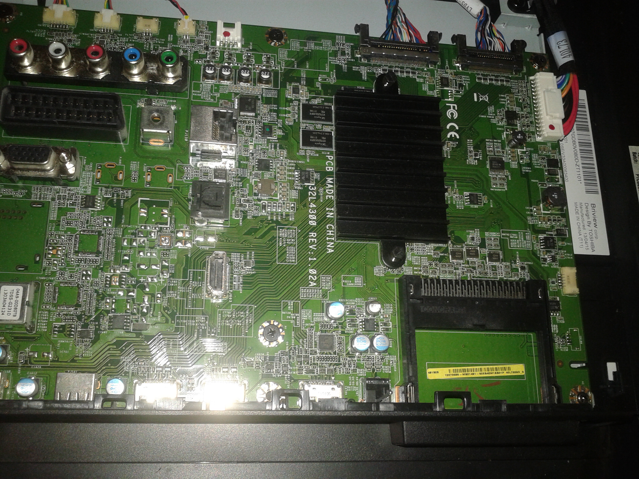

    Hello. The TV set broke during a few days' absence of the householders and he was probably on the watch. They claim that there was no storm and they like main rain after the storm. After switching on for ten seconds, the ST LED lights up green, then the backlight turns on and the LED turns red. Zero reaction to local and pilot. I tried USB batch from this post . With no effect.
    After switching on, the diode on the main flashes once quickly, a short pause and a long pause, and after a longer time, three short and long pause. The plate is not available for it (they are at Zalewski's but without 3D - no second Tcon connector). Is this disc repairable (charge? - is it for USB or dice replacement - or other methods)?
    Because as I mentioned there could be a storm and the main sensitive to it :cry:

    Darek.S wrote:
    Is this album
    Specifically, number and photo.

    Darek.S wrote:
    So now I can easily see that there are little yellow stickers. On the original album:
    12194136-MB03288-60EB40M1BB01P 40L7333D_G
    It's from the one from two years ago. After returning, there will be a photo. I will only add that the disc signals as if two errors, one is "once a short break and a long time", i.e. a dot-dash and the other (a few minutes after turning it on) is "three short and long break", therefore three dots. As far as I remember "... --- ..." is an SOS :wink:

    GanCegall wrote:
    I am so sorry that I forgot about this repair from just two years ago :-) and I demand details, I have to work on it because the rest probably know exactly what you were fixing two years ago :-) well, I'll wait for the details.
    But I absolutely don't blame it :wink: . I did not require anyone to remember and I gave it for that Link to this repair and because it blends in with the text, it is true green, it could escape attention. Speaking of the repair from two years ago it is my friends and if they have not thrown all the time to do). And above all, thank you very much for your interest (and it's not the first time :please: ).
    And here are the promised photos
    Toshiba 40L7335D - Does not work. After ten seconds, only the backlight
    because the yellow sticker in the photo is so legible I rewrote it (the turbinate dictated :D ). Another thing is that the print is not very clear even under a magnifying glass.
    12270689-MB01491-60EB40M1BB01P 40L7333D_G
    It is interesting that the yellow (sticker) at the end is 40L7333D_G and the TV type is a bit different :|
    I am due in a week :D
  • #8 17062606
    Darek.S
    Posts: 6683
    Help: 215
    Rate: 973
    Uploading the charge healed the receiver, just like the one from two years ago (but a friend "brought" it to me much longer than a week ... :wink: .
