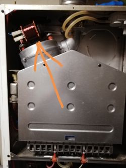

  • #8 18265818
    rafaelmichalak
    Hello, I`m not an expert, but I can use a screwdriver, a hammer and a caliper. Here`s what happened to me. Error E03, the stove is not working. I removed the casing (white) and then the other one that protects the combustion chamber. There is a fan in the chamber, on the left side. It turned out that the fan was... jammed, stuck. I started the fan, it runs smoothly and the stove works.
    Now the diagnosis. Or a bird flew in and blocked the blower. Or the engine seizes/runs out. I still need to clean the boiler elbow and the entire chimney. Brotje Energy TOP 24 CE - The stove stops working on the display - error E03 Brotje Energy TOP 24 CE - The stove stops working on the display - error E03
