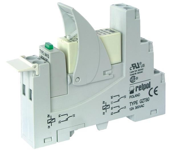

    This will be my first post in this section. I am looking to find out if there is any chance of my fancy ideas coming to fruition. I'm getting ready to renovate my flat, where the plan is to upgrade the power installation - from aluminium to copper.
    I would like to add a mechanism to this installation that would check for the presence of occupants in the flat and, if not detected, switch off the power.
    I would like to realise this with the help of a developer board ( RPi ) connected to the ICT network in the flat. The question is whether there is a relay that accepts 3V on the control and is capable of switching 230V at a maximum of 16A.

    First of all, it's better to use a socket; 16A contactors are delicate devices, which can break down, and I don't know what kind of load you're expecting.
    Attempting to upgrade the electrical installation with a control module.
    There are contactors for such sockets for 5V, 12V, 24V.
    You need to have 5V for the Tiny, so not a problem. Rather powering directly from a pin is asking for trouble. You need a transistor + diode, e.g. like this:
    https://www.elektroda.pl/rtvforum/topic1323874.html

    I don't know what sockets you are writing about. Could you stick a link to an example?

    Well, the picture I pasted is just such a socket, the contactor is that bright white cube.

    Ok, so it is possible to connect the 5V RPi to such a socket and, by changing the state on the GPIO pins, switch the socket on/off so that the 230V power supply is switched on or off?

    Yes, only it has to be a transistor as I wrote, don't power the contactor coil directly from the GPIO.
