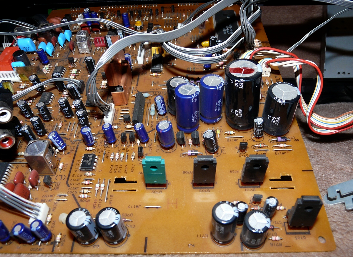

    I have a SONY TC-K520 tape recorder, which soon after switching on (2-6 minutes) starts "crazy electronics". Symptoms: fading display (partial / full), previously incorrect display of the tape counter, automatic activation of "MEMORY" idt. After starting the playback, when it is "mad", the tape recorder continues to play despite being turned off by the main power switch. Only pulling the plug from the network interrupts this "suspension". I also have a second SONY TC-RX70 tape recorder, in which similar symptoms have appeared recently. Reading the posts in this topic, he concludes that such ailments are typical of the disease of the equipment of the company, after all, 25 years of operation is still good durability. Unfortunately, the posts do not have a specific solution for this state. Maybe, however, someone managed to dig deeper into the topic and solve this problem?
    From a layperson's point of view, I would replace the electrolytes (aging), which only because there are over 60 items in all?
    Thank you in advance and best regards.

    Hello, there is another method for people who deal with electronics from time to time, I am a watchmaker myself, but with electronics I'm from elementary school, but back to the topic - thermal method; maybe weird but it's a topic for those who can not locate the damage in a standard way. Check which of the elements heated up after a certain time and then you can cool it, you need to buy a freezer in the aerosol, occasionally cool the various regions of the plate, of course, at intervals of time

    Hello, each method is good if it has a specific effect. I will try instead of a freezer (moisture and water is an adventure with the current) to use a cool air. For this occasion, I used an 8cm computer fan connected to an external 12V power supply. Blowing in the area of the power supply on the recorder's motherboard definitely delays the "advent of the fault". Therefore, he will remove the main deck of the tape recorder (unfortunately, demolition of the whole, including the mechanism, panel / display). And what's next? Measure the power transistors, rectifier diodes ?. It plans to prophylactically replace the power supply electrolytes. By the way I bought occasionally the second identical Sony TC-K520 (damaged). I will have a pattern for connecting a tangle of cables from the board. It is a pity that no one on the forum has ever worked on this topic before, fell on amateur :)

    Thank you very much, my colleague cookie cookie for the service. If I am still able to identify this transistor on the line of the IR-microprocessor receiver on the record, it would be a small success (if the exchange of electrolytes in the power supply does not help, you can try and ultimately castration). Magical Q and three digits, oh knowledge that tends to me (as hell)

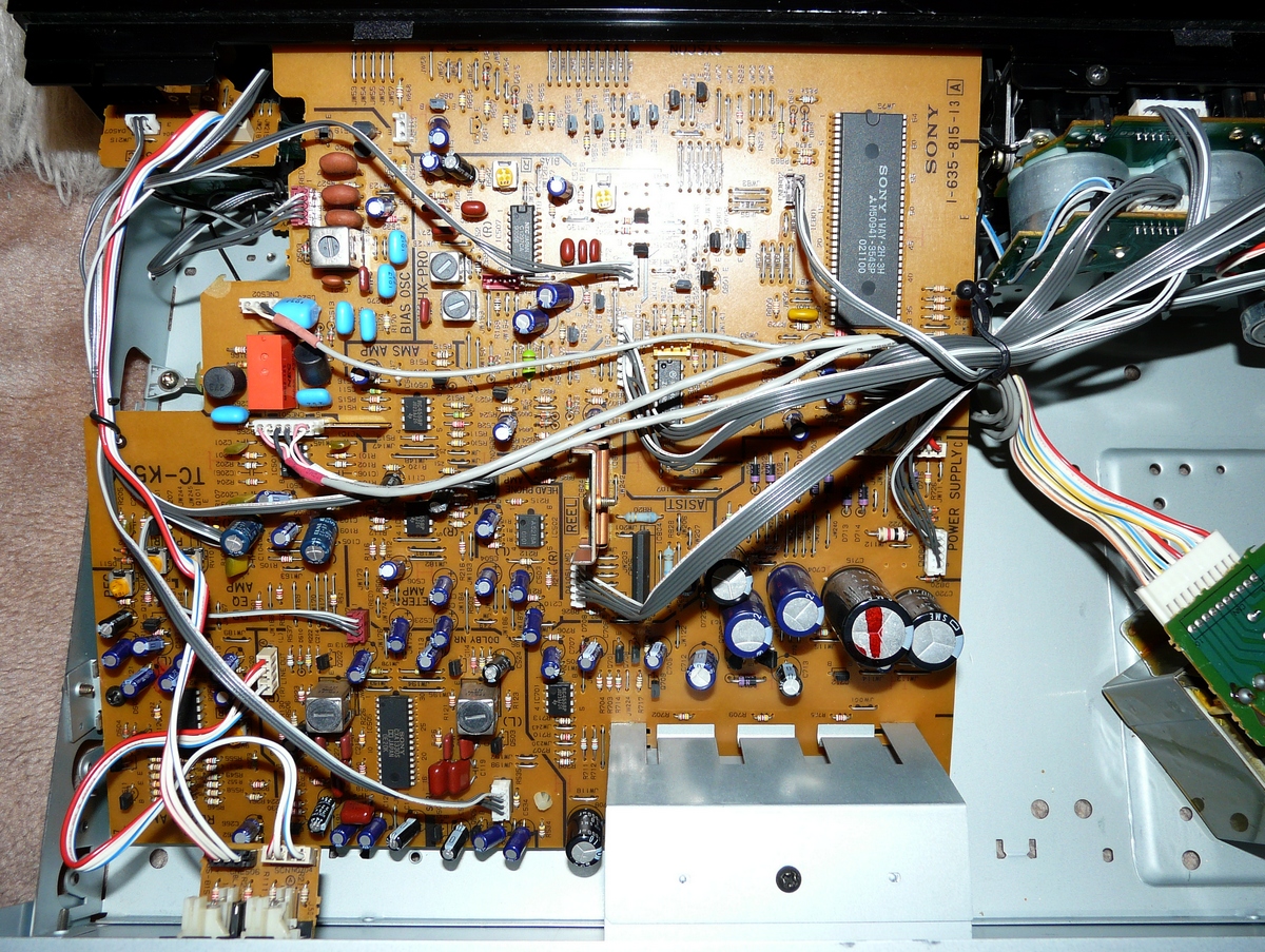

    Colleague1 showed me the way of locating the fault (thermal), I used a fan because I had it at hand, and the freezer in store :) . In addition, these three transistors (they look like transistors - I am an amateur) were covered under large sheets of the heat sink (transistors in the middle between two sheets) and it would not be very much a "trick". SONY TC-K520 - Electronics is going crazy soon after inclusion / strange behavio SONY TC-K520 - Electronics is going crazy soon after inclusion / strange behavio

    Admittedly, I will not answer which element is the one you are looking for but you can still turn the plate over and watch it under the account of so-called cold solders, it would be useful to have a magnifying glass

    At the moment I have replaced all electrolytic capacitors in the power module on the recorder's mainboard - unfortunately it did not do anything. Replacing everything in a tape recorder (about 70 electrolytes) would be time-consuming and unprofitable, especially since there is no guarantee that it will help. There is a malfunction.
    I would like to thank my colleague Andrei, who advised me about the number of the transistor (Q811) removed in the IR system (Sony TC-K520 tape recorder). Castration will be a "B" plan, for the time being a few more times, maybe some of your friends will suggest some sensible solution. It would be a shame to lose service with the remote control.

    Just the right note, I watched the 25 years of desoldering, no symptoms of electrolyte crystallization. I also made a "short circuit" check with the multimeter - ok (I can do that). They look better visually than the new ones bought. Of course, I do not throw it away, put it away in the bag. I still have a second tape recorder (damaged) maybe one day I will be able to do something.
    I do not have technical knowledge in the matter of repair, and it is unprofitable to give service (it will exceed the value of the same functional equipment). I treat it as a hobby, recently I "revived" the LCD monitor - it helped to replace five electrolyte fused in the converter. So why am I taking it if I'm green? I hope that someone has successfully fought this problem and may want to share the solution. Maybe...?
