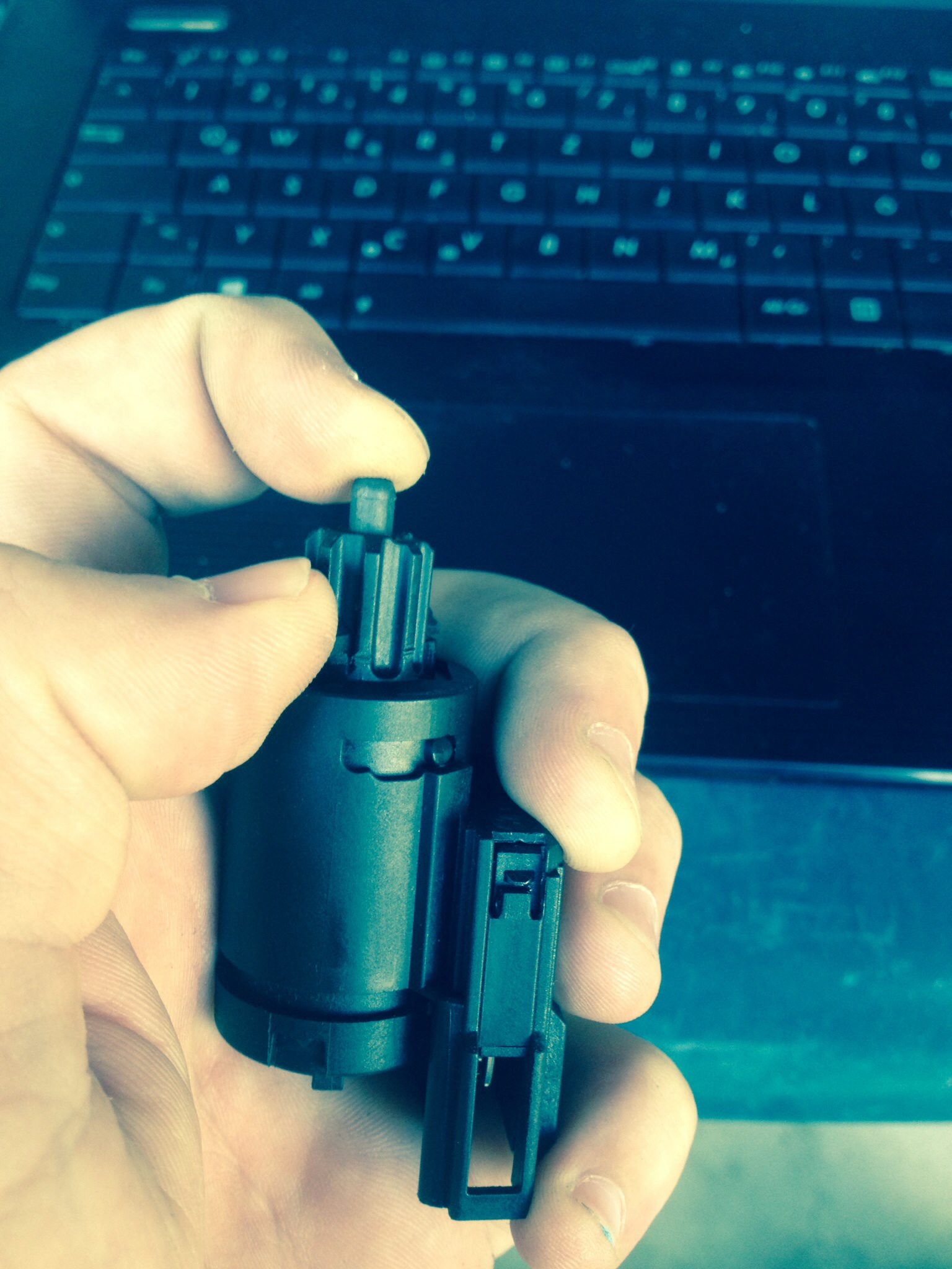

    I removed this contact, it looks like it has 3 positions in the photo

    Have you tried to replace? Or re-set?
  • #8 15027393
    Szatan00
    Posts: 15
    Rate: 27
    There are no replacements from anyone, but now the question is which of the 3 options is the right one ... when I pulled it out, this rod was extended to the max when I tried to move it as if the gear (Sound) tried and went down. It can be moved but when I press it, it falls to the bottom and comes back on the spring only a little

    Inside there is a blue dinks, as he regulates these positions, he moves from right to left, moving forward more and more

    Pull this disk to the max and press the brake pedal to mount the sensor in its place. Check if the feet work and if the work of both sensor circuits is visible in the diagnosis. Or just replace it. They pounce like tabby cats.

    The lights work as they should, but I ordered a new one tomorrow I will replace it and see what will be the effect I will clean it for now and an extra red brake light has appeared :D Breaking the head ... Still, it all came down to this switch but can it really be the culprit of all these errors?

    I'm after replacing the brake light switch, on the way to the shop in the morning abs / esp was shining informing all the time that there is a problem after the replacement I drove and nothing appears (with my luck lately it's hard to believe) you think that the errors described in the first post could cause this small switch?

    It's hard to believe, I'll go again and see if the problem actually disappears, it's not my first Audi, that's why I'm always looking for an alternative solution than the service, the more that sometimes it just turns out to be crap, unfortunately, electronics shows a million other elements and a person goes crazy :( I'll let you know in the evening if the error still appears and I'll check the car thoroughly with a vag, I'm waiting for a new cable
