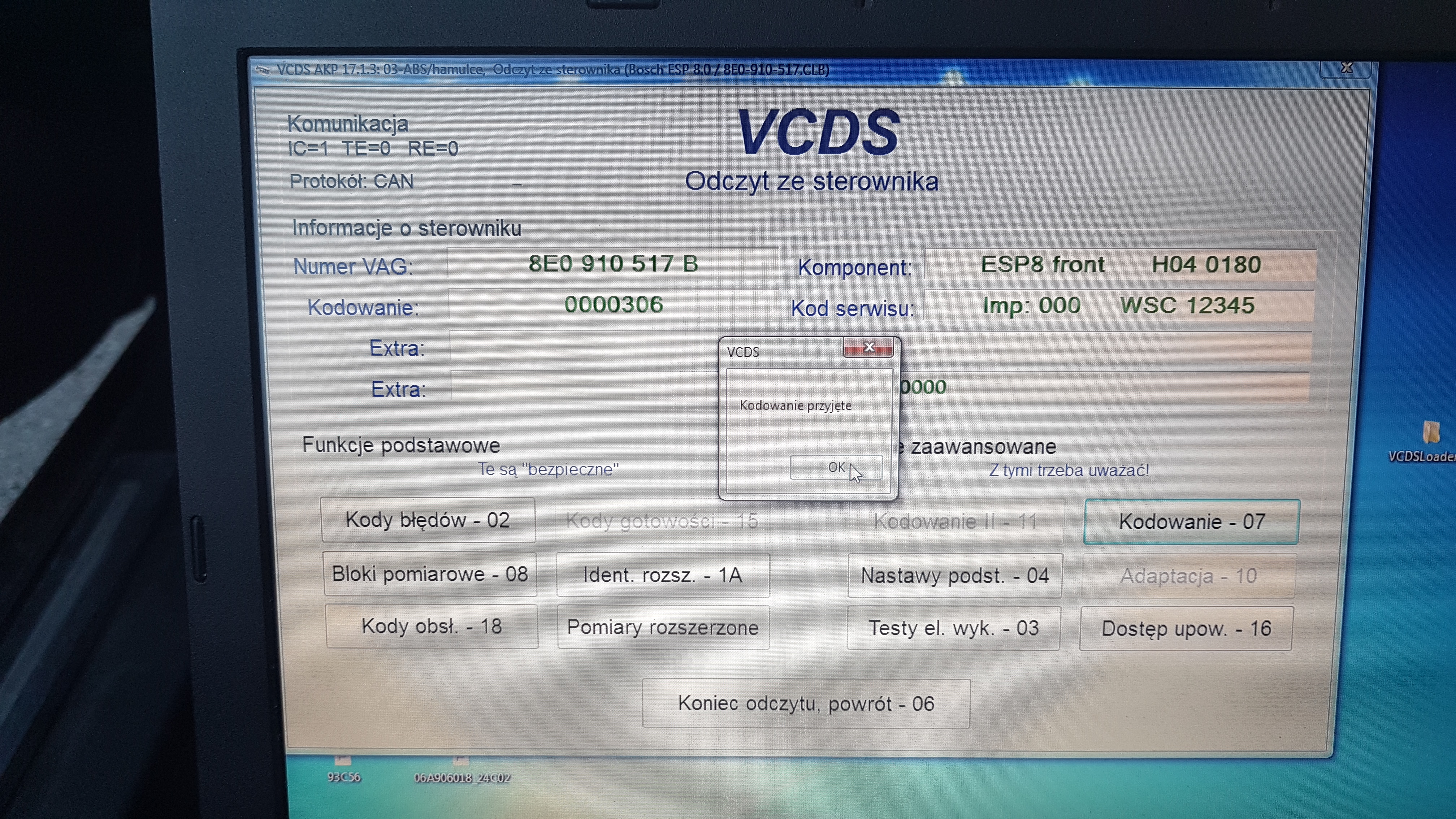

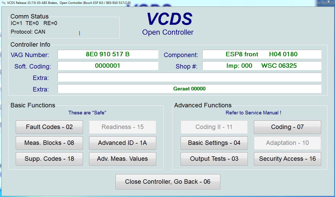

    I am asking for help, namely after replacing the steering module with another one, the ABS coding crashed!
    - please write me what should be the encoding and what login?
    - the current encoding is 0000001
    Audi A4 B7 2005 1.6 petrol manual transmission with brakes code (1LZ)

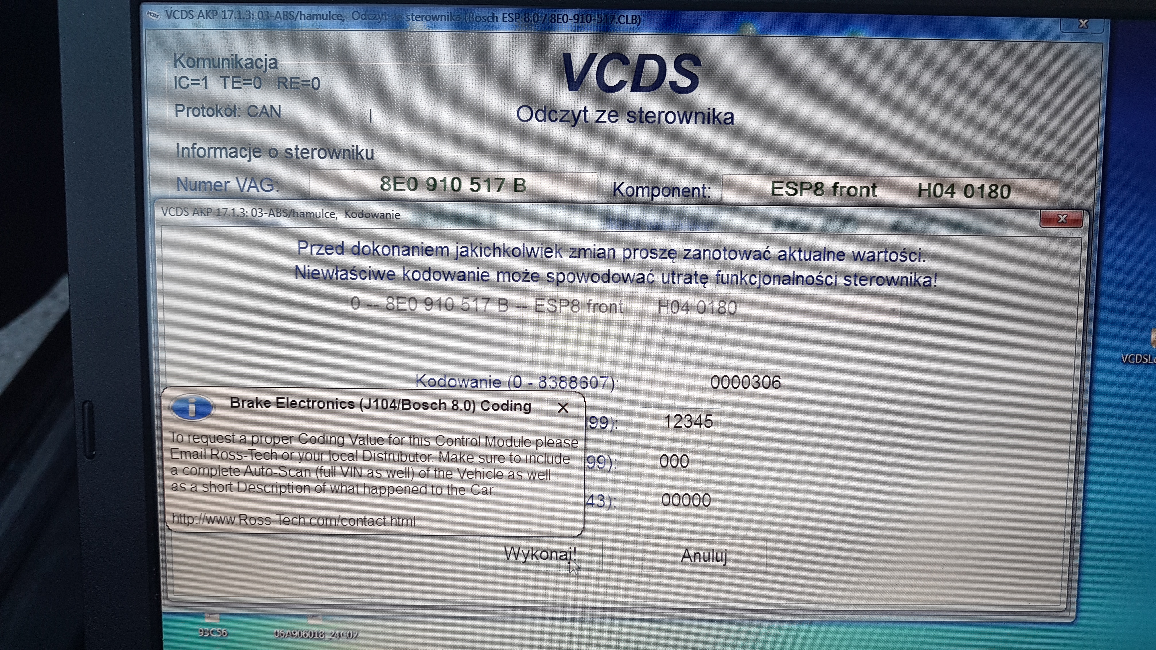

    See 0000306. Login is not prompted by vcds?

    I checked encoding 0000306, encoding accepted.

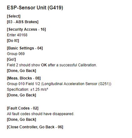

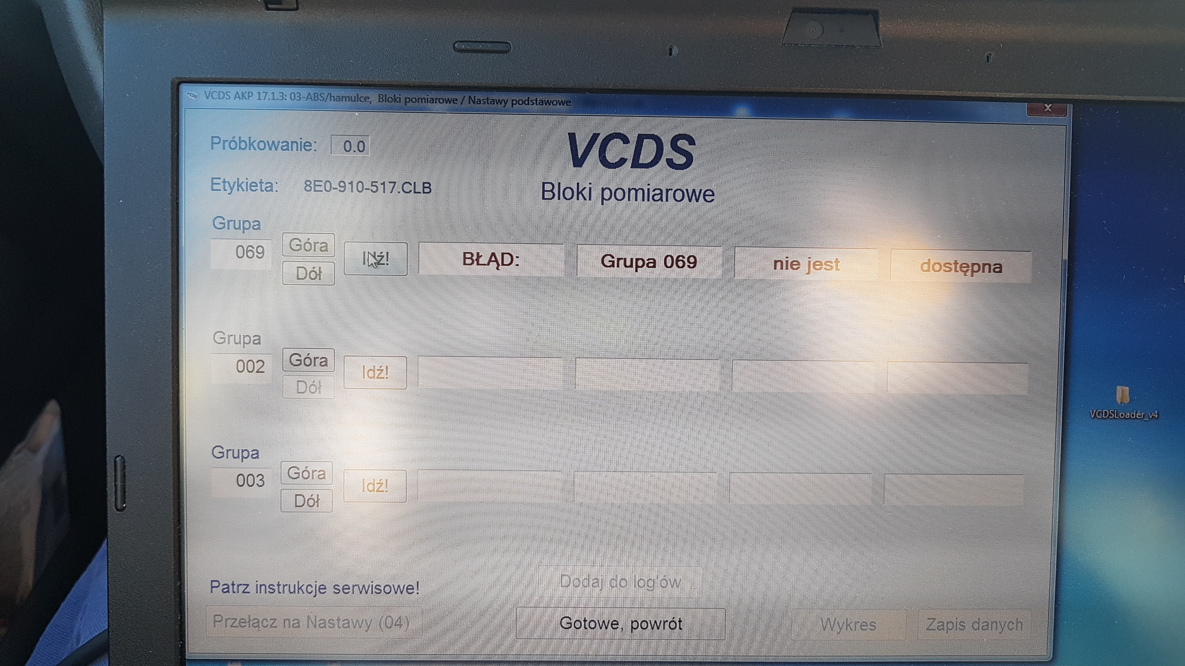

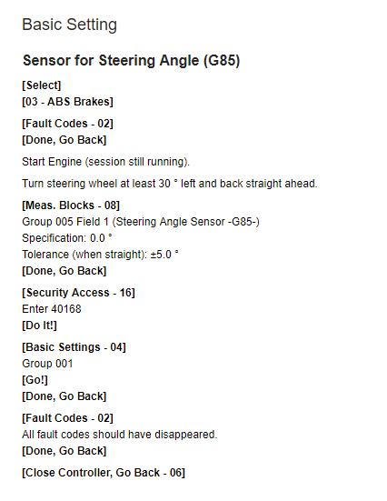

    - The problem is with the sensor module (G419) that the measurement block 069 is not available, no setting possible.
    - 000001 re-encoding accepts no problem and you can follow the procedure according to Ross-Tech recommendations
    Audi A4 (8E) Brake Electronics (Bosch 8.0)
    • Audi A4 B7 2005 1.6 Petrol: ABS/ESP 8.0 Coding After Steering Module Replacement (1LZ) 2.jpg (5.28 MB) You must be logged in to download this attachment.
    • Audi A4 B7 2005 1.6 Petrol: ABS/ESP 8.0 Coding After Steering Module Replacement (1LZ) 3.jpg (4.71 MB) You must be logged in to download this attachment.
    • Audi A4 B7 2005 1.6 Petrol: ABS/ESP 8.0 Coding After Steering Module Replacement (1LZ) (G419).JPG (33.53 KB) You must be logged in to download this attachment.
    • Audi A4 B7 2005 1.6 Petrol: ABS/ESP 8.0 Coding After Steering Module Replacement (1LZ) (G85).JPG (40.27 KB) You must be logged in to download this attachment.

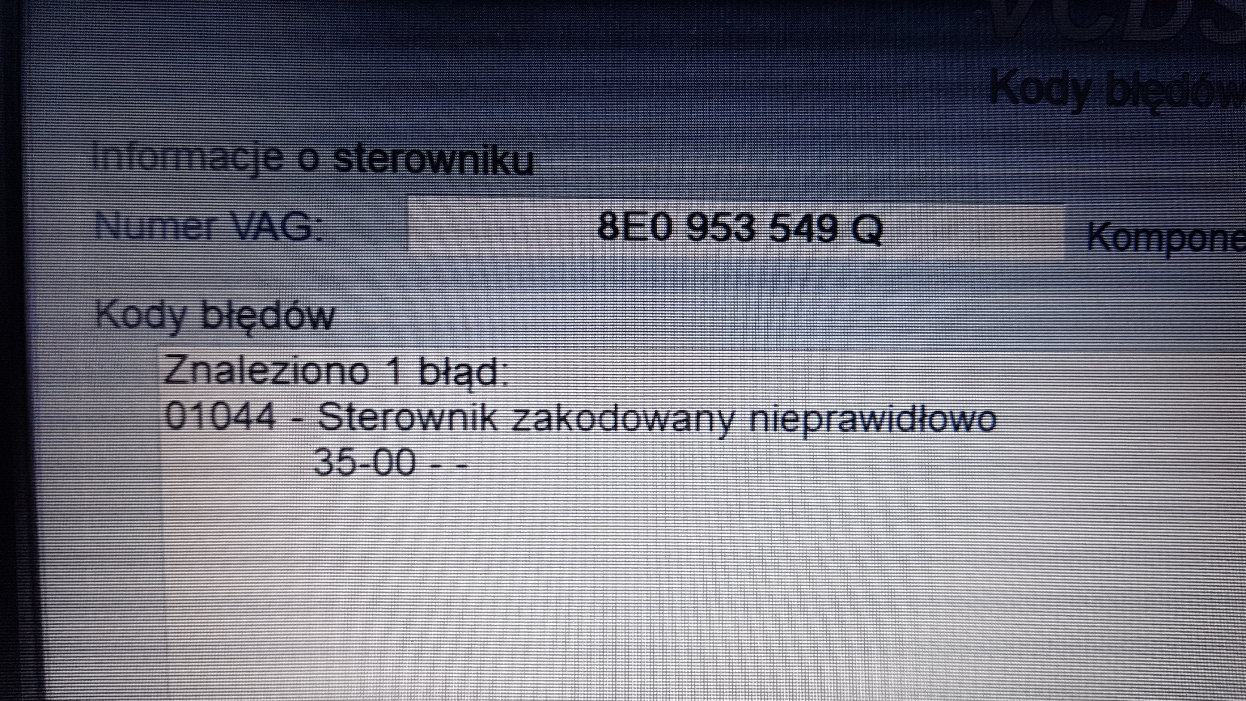

    Module 8E0 953 549 Q
    Modified module and cruise control shifter coding set according to the hints vcds 00042
    - coding on the standard steering wheel without multifunction and tiptronic, Avant, Cruise and BC.
