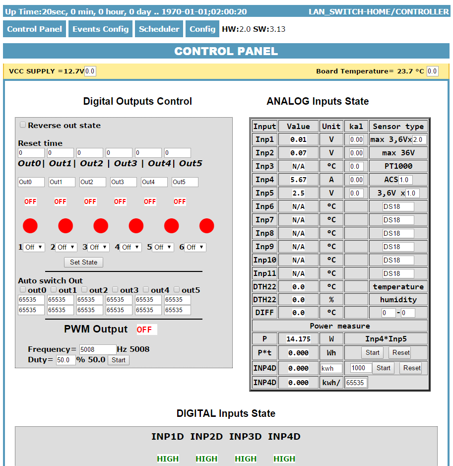

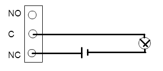

    Hello, I am just trying to connect the LAN Controller 2.0 (tinycontrol.eu) to light up an LED connected to the battery via the relay output OUT 0. Here is how I connected it:
    Here I just connected to NC and C but I also tried NO and C.
    The power supply is from the battery
    LAN Controller - Output OUT 0 - Sends only a single pulse instead of switching on
    When logged into the controller panel, trying to change the ON/OFF state of the OUT 0 relay fails, and clicking on the red circle or trying to reverse the default state of all relays causes the LED to light up momentarily (single flash). I don't know how to make it light up continuously. I would appreciate your help.

    Buddy, give us screenshots of control panel and events config something is switching the state of this output to the previous one.....

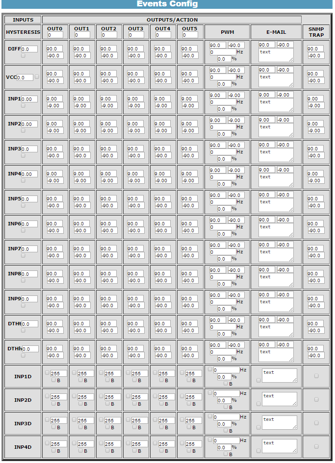

    Thanks for the reply, below are the snapshots of the panel and events:
    LAN Controller - Output OUT 0 - Sends only a single pulse instead of switching on LAN Controller - Output OUT 0 - Sends only a single pulse instead of switching on
    Now to take snapshots I have connected as in the diagram in the previous post. That is, it lights up permanently, and switching to the opposite state should turn the diode off. Instead of going out permanently it goes out for a fraction of a second and then goes back to the default state again. Neither by changing the ON/OFF nor the reverse out state am I able to change this. Clicking the red/green circle also causes a momentary flash.

    The settings look correct. Please provide a diagram of the connection of your diode to the lan controller module. What is your power supply and what are its parameters?

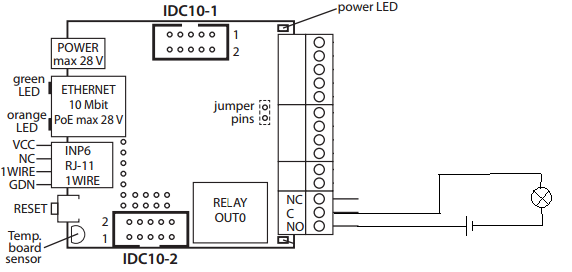

    Sorry for the quality of the diagram but this is the only way I know how ;/
    Power supply from Siemens phone:
    230V AC/50Hz/50mA
    9.3V AC/210mA
    Added after 6 [minutes]:
    OK! Thanks a lot! It was all about the power supply. I gave it 12V, 2A and it's OK....
    Many thanks again!
