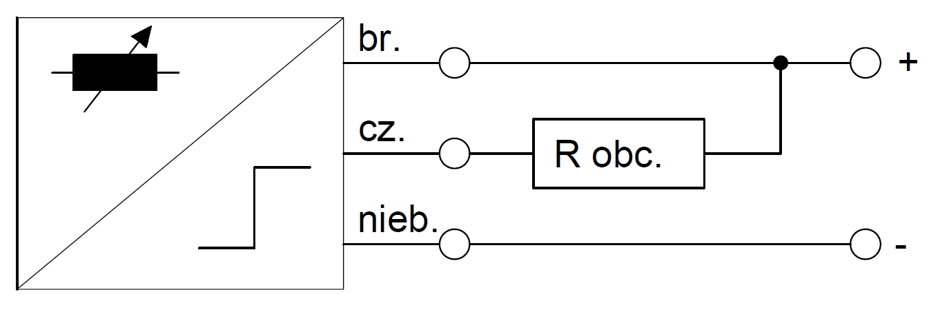

    Why does connecting an inductive sensor change the state. The sensor has 3 wires one is connected to +24V the other to the input ground, while the third is connected to the H dry contact input. When the ind. sensor is triggered, a voltage of +24V appears on the third wire and the input state changes from 1 to 0

    Please specify the model of this sensor.
  • #8 15135728
    izeusz
    Posts: 29
    The sensor is marked IMPOL ICZ-D5 CNP3

    izeusz wrote:
    Why connecting an inductive sensor changes the state. The sensor has 3 wires one is connected to +24V the second is connected to the input ground and the third is connected to the H dry contact input. When the ind. sensor is tripped, +24V appears on the third wire and the input state changes from 1 to 0
    The issue is quite simple. As I mentioned above ...
    Polon_us wrote:
    connected only to Dry Contact input - usually NO - Normally Open .
    Please consider the situation (and this is actually the case) that the sensor is equipped with NC contact - Normally Closed i.e. Normally Closed.
    How then will the Dry Contact input behave? Connecting the sensor and tripping it.
