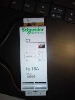

    I do the protection on a PCU-511 time relay and a contactor as shown in the photo (switching off after a set time).
    Can anyone help interpret the purpose of the contacts in the contactor as pictured ? Because I don't think I understand something.
    I am applying voltage to contacts A1 and A2 and the coil is working. However, I try to ring the transitions between contacts R1, R2, 1 and 2 (in various combinations) and .... silence. The contactor straight from the shop.
    What am I doing wrong ?

    R1, R2 normally closed NC contact. - Connected when no voltage is applied to the coil.
    Contact 1, 2 - NO - Normally open. Connects when voltage is applied to the coil.
    Diagram on the housing!

    I wanted to make sure. Relax.... I am not so a fool :-) .
    Something is therefore wrong with this contactor.

    If, with no voltage on the coil, R1 and R2 are not shorted then it sucks.

    R1-R2 is OK. There is no 'expected' transition between 1 and 2 when voltage is applied.

    Fidelis wrote:
    R1-R2 is OK
    This means that when voltage is applied to the coil, R1-R2 opens?

    Exactly right.

    Well, that's a faulty NO contact.

    If it is as you describe, there is nothing left to do but to complain about it.
    I have used Schneider modular contactors more than once (the iCT series to be precise), and I have not yet had a problem with them.
    Maybe someone has already used it and returned the faulty one to the shop.

    Maybe. The contactor looks new, but one edge (just above the Schneider lettering) was "oddly" scuffed and dirty. Maybe it was actually returned and got misplaced as damaged, as I don't suspect the shop of bad intentions.
