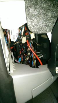

    Hello. I couldn't find the answer to my question in this forum so create a new topic! Namely, I have a problem with finding the fuse from the cigarette lighter socket. I had a problem with this in the previous year and it was necessary to go to the service station because it was not possible to find the right fuse. Seemingly simple and in this car it was an unsolvable problem.

    Unfortunately, somehow I cannot locate the place you are talking about. I am sending photos of the car in the vicinity of these places and please indicate the location where it is located.

    Then you looked poorly. Personally, I posted a list of fuses for the 906 model on the forum, you should also have this list with your vehicle:
    https://www.elektroda.pl/rtvforum/topic2274331.html#10822365
    I checked: the cigarette lighter fuse is described (even in two languages) and is located in the main fuse box. The main fuse box is under the flap shown in the first photo you posted.

    In my car, the fuses end at number 24, and in this diagram the socket is responsible for fuse number 25. So where is it hidden?

    Then make up your mind: you mean the LIGHTERS socket, or the so-called "power take-off socket" on the bottom of the dashboard. The lower one is essentially intended to power the wheel pumping device. Which, of course, does not preclude its use for other purposes.
    vedos wrote:
    In this diagram, fuse 25 corresponds to the socket. Where is it supposed to be hidden?
    If you don't notice the biggest "bull" fuse on the box, wear glasses 8-)
    Anyway, in the diagram I gave it is described as 25

    The corner is unscrewed to replace relays. There is enough access to the fuses under the flap with a plastic cap - you can see it in the first photo.

    The discussion is far from the topic, but please:
    access after opening the flap:
    Sprinter 316 CDI 2012: Locating Cigarette Lighter Fuse, Socket Replacement, and Service Station
    access after removing the triangle:
    As you can see, access to the fuses through the flap is sufficient and you do not need a hand with three elbows. If we try to replace the fuses through the hole after the removed triangle, unfortunately we have to do it blindly - after inserting our hand, there is no chance to see which fuse we take out.
