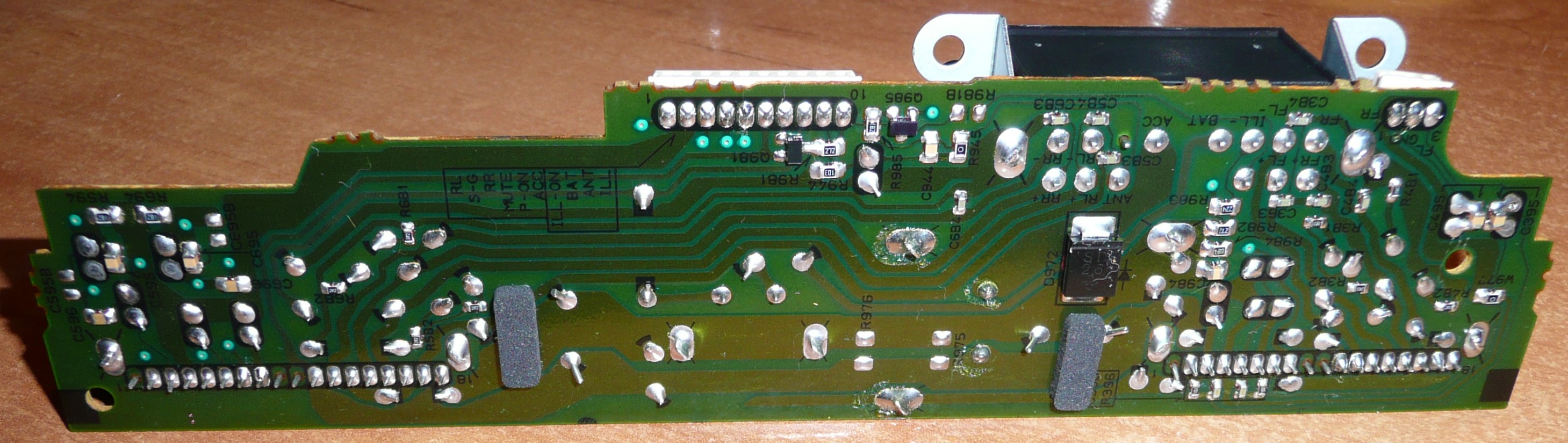

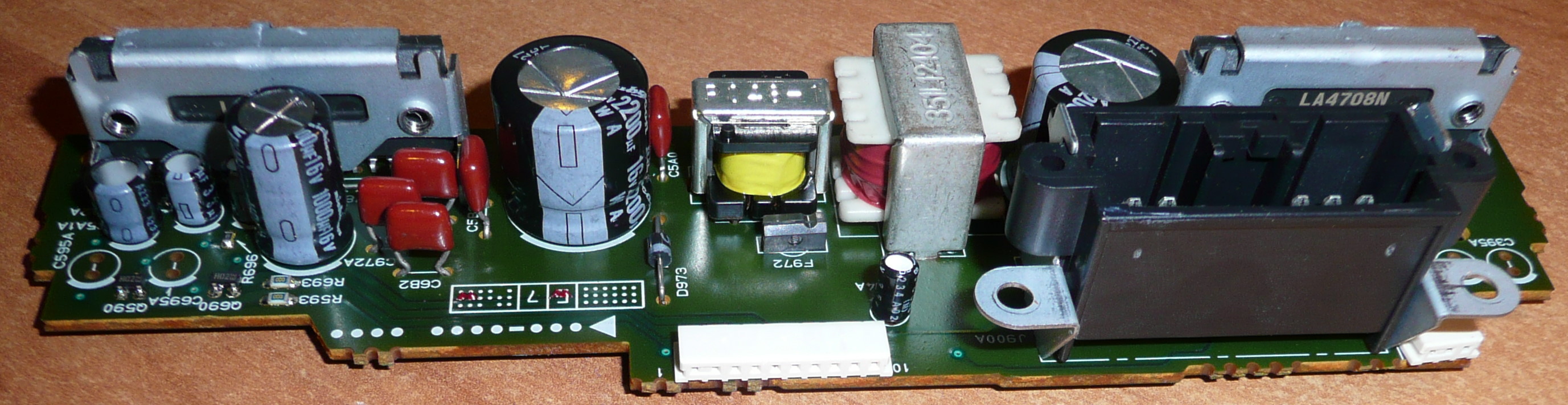

    I would like to take the RCA output from the factory radio to a 4-channel amplifier.
    Power tips (2 pcs) LA4708N Specification
    The main unit: LC75385Y (replacement according to SANYO is LC75411ES ) Specification
    A few pictures:
    Mitsubishi W142 Factory Radio: 4-Channel Amplifier Connection with RCA Output & LA4708N Power Tips Mitsubishi W142 Factory Radio: 4-Channel Amplifier Connection with RCA Output & LA4708N Power Tips Mitsubishi W142 Factory Radio: 4-Channel Amplifier Connection with RCA Output & LA4708N Power Tips Mitsubishi W142 Factory Radio: 4-Channel Amplifier Connection with RCA Output & LA4708N Power Tips
    I would ask for more experienced advice:
    I have a dilemma with the place where 4 RCA sockets are connected.
    All help is welcome :)
    Greetings,
    Michael

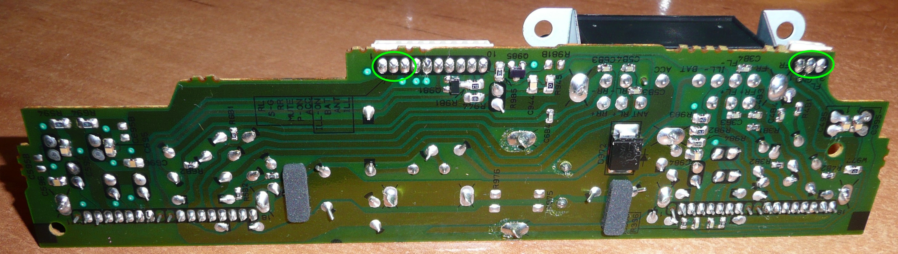

    I can not hear anything, I checked on the receiver, on the loudspeaker and on the speaker with the amplifier. The capacitors were delivered by myself, I followed the diagram and in accordance with it I chose the value of 2.2 uF.
    Perhaps you should connect to these places on the board (I greened):
  • Marked points identified as signal connections
    #6 7951266
    cichy lis
    Level 28  
    Posts: 1779
    Help: 113
    Rate: 94
    This is marked on the left - is not GND? I can barely see but these points are as if they are connected - unless the record is two-layered.
    Buddy, and it's not better to construct an adapter or buy it? combining should work - I do not understand why the signal reaches the tip do not work - As you have the power to work it can take out the capacitor (so that the signal does not reach the tip) and hook up with a handset without a capacitor - the signal should be!
    I watched the photo on the magnification and You're right - those marked points are the signal handle - a nice description of this cube is on the disc. Get stuck - it must work

    From what I've read, all adapters affect the sound quality. Moving outside is a temporary solution, as soon a new headunit will be purchased. I will try to stick to the place marked above.

    Unfortunately, I tried, I stopped and I continued to silence.
    I noticed that when I touch the rca plugs, the radio will turn off the right or left channels, or both, so it makes a short circuit, so it's definitely not the place to hook up.
    Any ideas ?

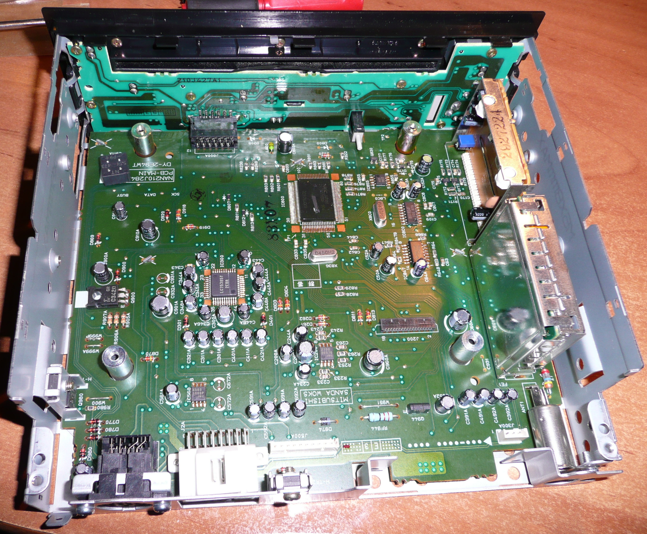

    In the end, I succeeded, I joined the signal directly in the legs of circuit LC75385Y on the board:
    front, right loudspeaker signal - pin 13
    front, left loudspeaker signal - pin 22
    I pulled the mass for RCA from the housing.
    Such a procedure gives us 2 rca to go out to the amplifier.
    I did not use additional capacitors.
    greetings,
    Michael

    I do not need other photos than I have above, but if I wanted to, should not connect with signal directly into the legs of the LC75385Y system on the board:
    rear, right speaker signal - pin 14
    rear left signal speaker - pin 21
    RCA mass - radio housing.
    greetings

    Below I present to you the solution checked by me , working both in car , under the external amplifier, and in home conditions .
    Required, after outputting a signal from each channel from the LC75385Y system, using the appropriate capacitor.
    Correspondingly for the front speakers (2 RCA), in the LC75385Y system find pin 13 , which is responsible for the signal in the right front speaker . It is soldered to a positive electrolytic capacitor foot with a value of 0.22 uF 50V . The negative foot of the capacitor to the RCA signal.
    The same operation is carried out for pin 22 responsible for the signal in left front speaker .
    Mass for both
    pull from the radio casing.
    When it comes to outputting the signal for the rear speakers, the principle of operation is almost the same, with the change that we use capacitors with the value 1uF 50V , and solder them accordingly:
    rear left speaker signal - pin 21
    greetings,
    Michael
