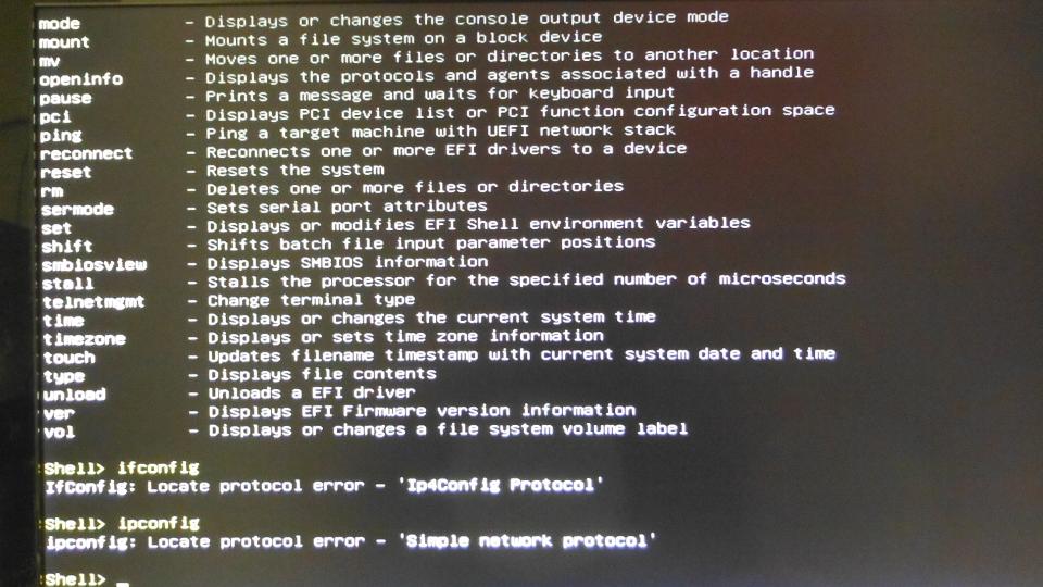

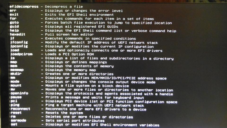

    But can this Brix boot from LAN or not? This UEFI on Brix has some 'ifconfig', 'ipconfig' commands, but I don't know what to do to get them to work.
    Somehow I didn't notice that there was a 'lanboot' command in help, mentioned in this first link, but maybe I missed it - I'll check it at the earliest opportunity.

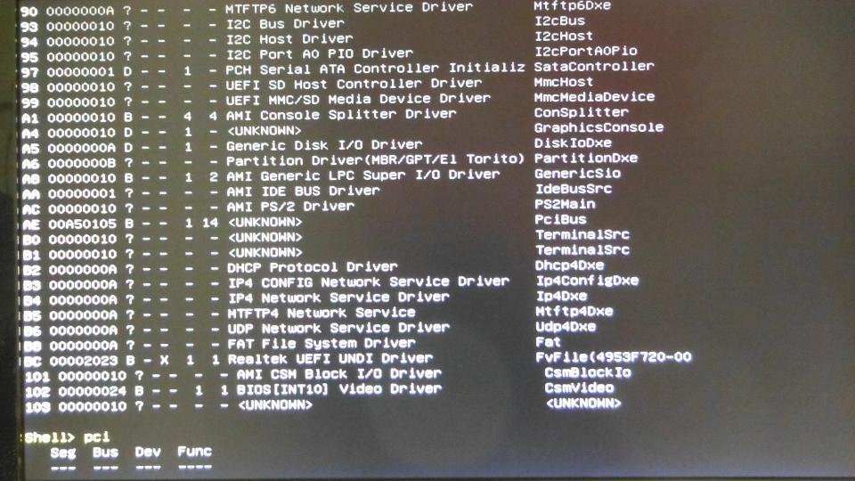

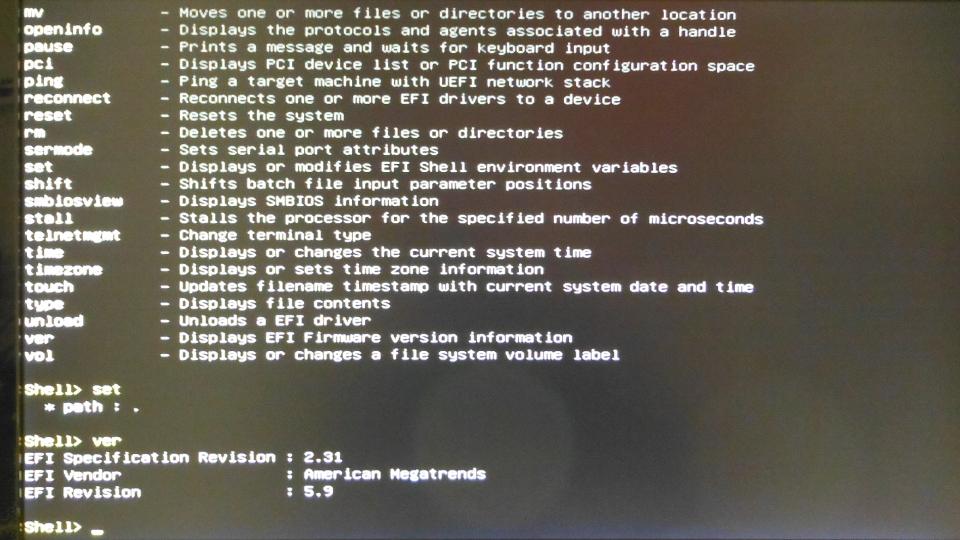

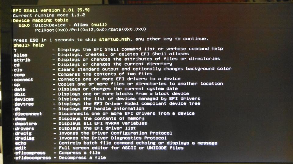

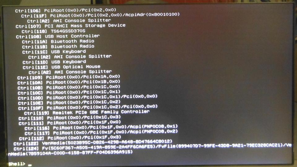

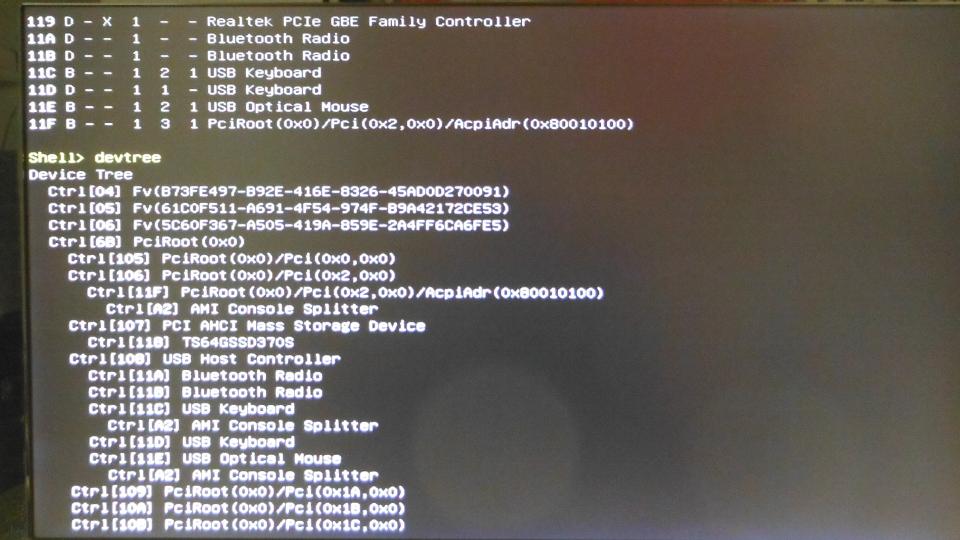

    I looked through all the BIOS settings and it turned out that you can boot from the network - it looks like it works, anyway it gets information from DHCP and looks where it can boot from - it doesn't, because I haven't configured it yet. However, I am curious what UEFI can do, I took some pictures of the screen.

    If you have a DHCP server, I suggest you also set up a PXE server and run PXE Boot via UEFI Networking (UEFI Boot). On the server computer, you must properly configure the DHCP server, PXE and TFTP (or HTTP) communication.
