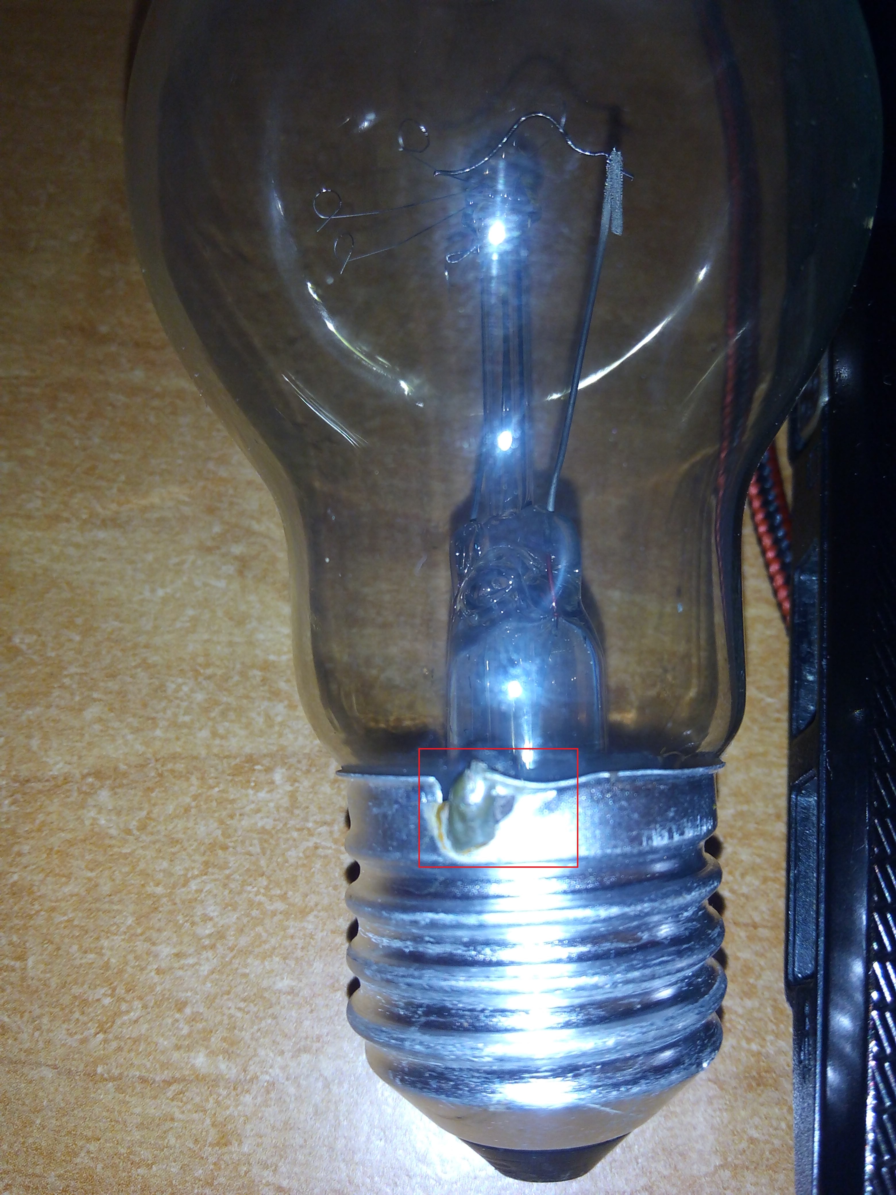

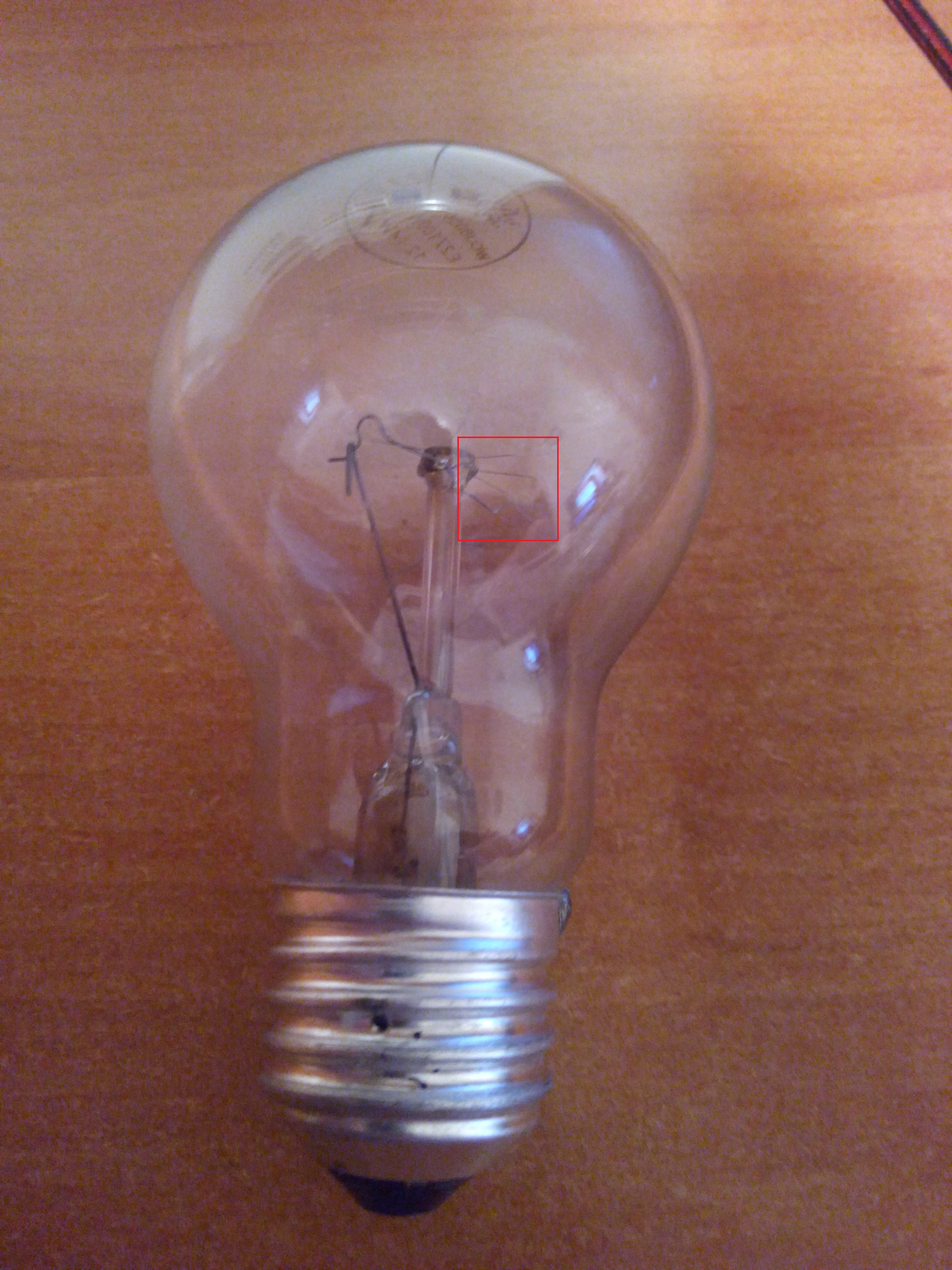

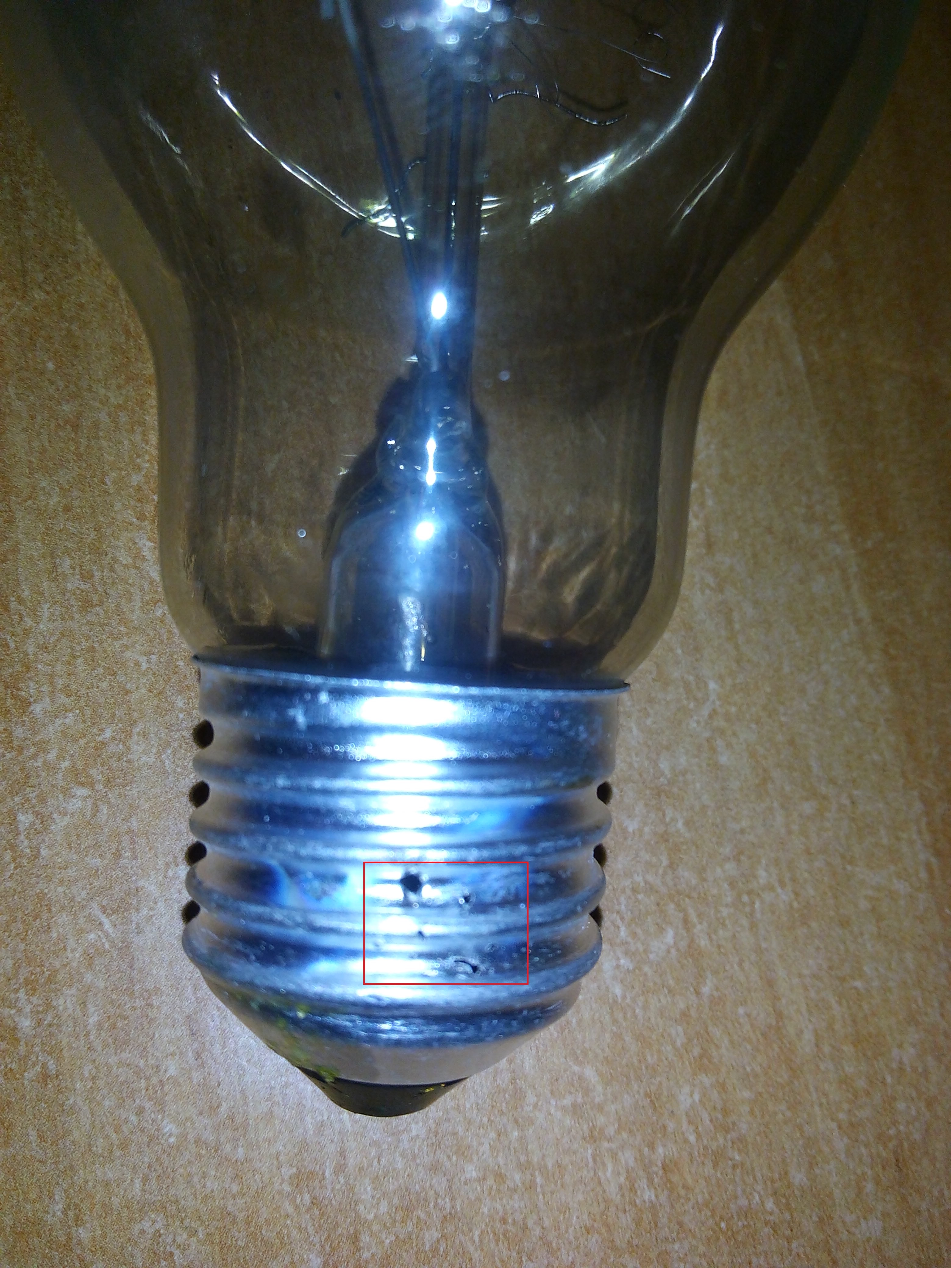

    What I managed to read from both fuses is:
    at home - S191 B16,
    in the corridor in front of the counter - S191 25A
    Below for scientific purposes or as a curiosity ;) I present photos of the bulb, I will add that after replacing it, the light in the bathroom is on, so everything is OK :D
    • Frequent Light Bulb Explosions in Bathroom: Electrical Installation Issue? IMG_20151129_203134.jpg (1.91 MB) You must be logged in to download this attachment.
    • Frequent Light Bulb Explosions in Bathroom: Electrical Installation Issue? IMG_20151129_203047.jpg (2.51 MB) You must be logged in to download this attachment.
    • Frequent Light Bulb Explosions in Bathroom: Electrical Installation Issue? IMG_20151129_203019.jpg (2.28 MB) You must be logged in to download this attachment.
    It also looks broken.
