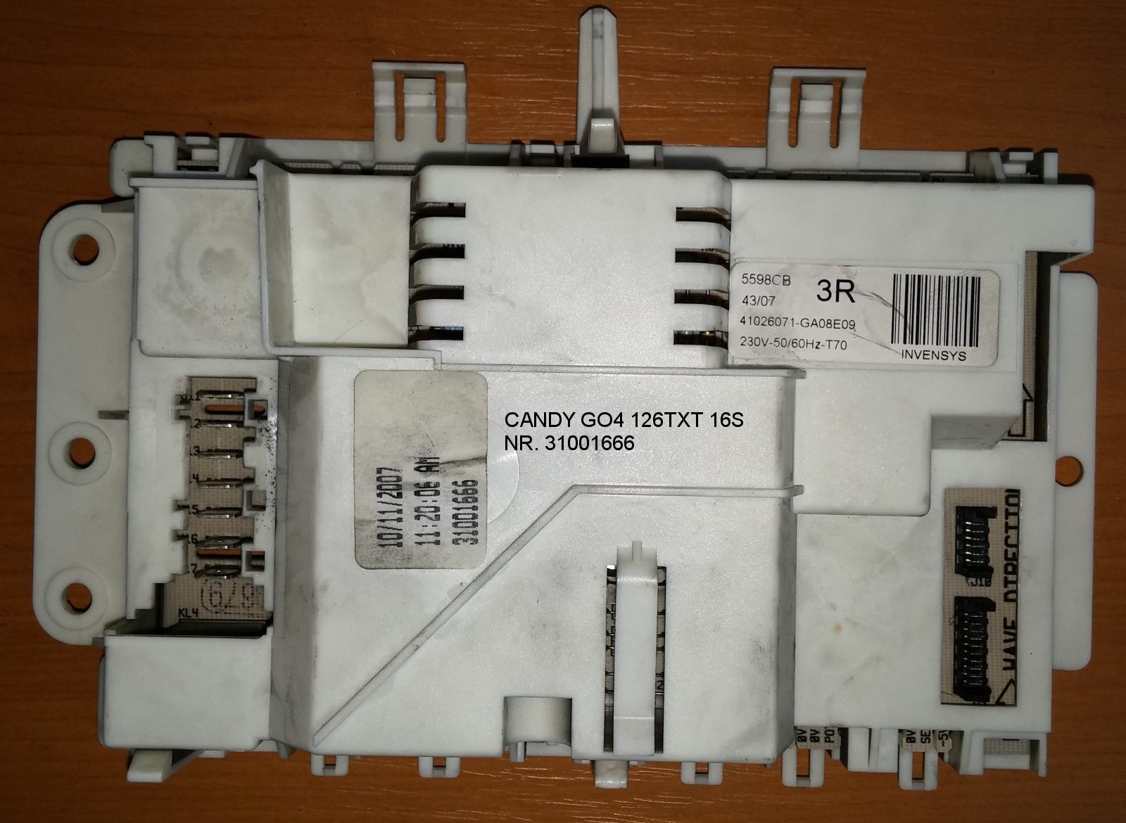

  • #9 15232318
    Meendoo
    Posts: 8
    I left the control module and is burned in one place. Does it make sense to a repairer? Can you buy kup?
    Give a photo from the other side of the CD.

  • #11 15235885
    Meendoo
    Posts: 8
    Picture of the control module.
    Aaaaa, it's only now that I'm sure I want a photo of the panel without a cover.
    I need to find such a screwdriver.
    • Candy GO4 126TXT message "close the door" even after replacing the loc Candy_modul_panel.jpg (445.28 KB) You must be logged in to download this attachment.
    • Candy GO4 126TXT message "close the door" even after replacing the loc Candy_Modul_front.jpg (228.7 KB) You must be logged in to download this attachment.

    Meendoo wrote:
    the control module.
    Good joke :)
    Meendoo wrote:
    it's only now that I'm sure you want a photo of the panel without a cover.
    Bingo :idea:

  • #13 15236499
    Meendoo
    Posts: 8
    Is. Red marks on elements around which is black.
    I am an electro-illiterate.
  • #14 15236648
    Paw_el
    Home appliances specialist
    Posts: 3503
    Help: 592
    Rate: 1551
    It's black leave alone and the whole module also :(
    Meendoo wrote:
    I am an electro illiterate
    Give it to an electronics technician, he should handle :)
