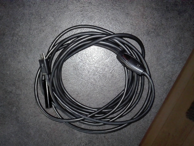

    Micro USB connection
    Camera without brand and model
    It was supposed to be connected to an android phone and work, but as it turned out, not all of them.
    I've read that not all phones have OTG
    I made the root, but still after connecting in the USB otg helper program, a message about the lack of drivers is displayed.

  • #4 15281865
    TomekxD
    Posts: 1666
    Help: 62
    Rate: 191
    These phones do not support OTG and nothing can be done about it.
  • #5 15281875
    kamo0501
    Posts: 12
    Rate: 16
    Even if you buy an OTG adapter, it will probably not work because of the settings in the phone system?
  • #6 15281878
    TomekxD
    Posts: 1666
    Help: 62
    Rate: 191
    Not settings and no hardware support.

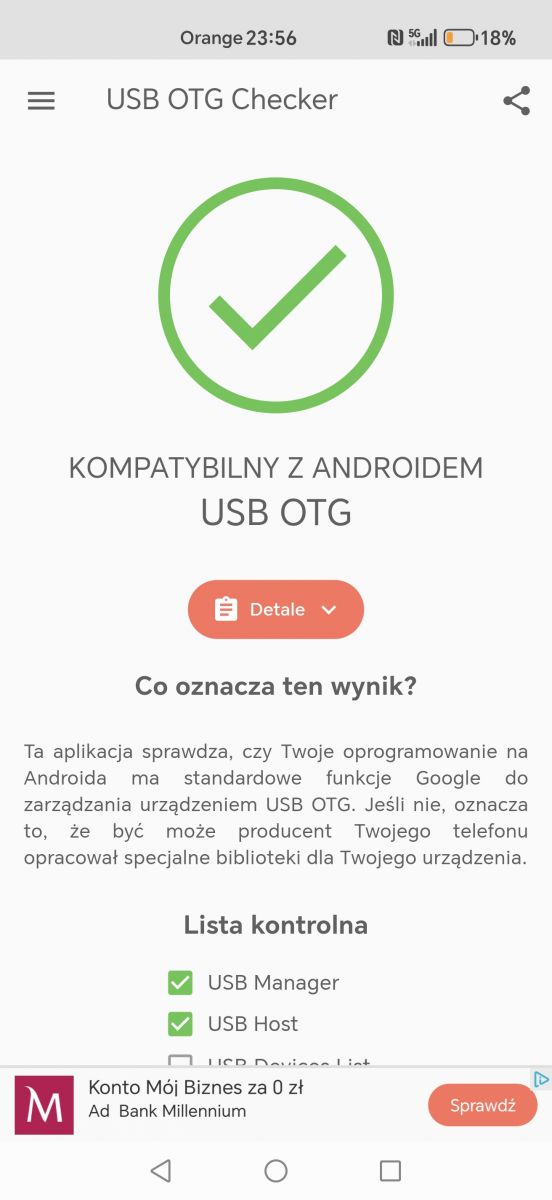

    https://obrazki.elektroda.pl/4526329200_1738018823.jpg
    I am refreshing the topic for a moment. I have an Honor Magic 5 Pro and according to the USB OTG Checker app (image above) the phone is OTG compatible and unfortunately the endoscopic camera does not work and no message appears to me, system Android 14, MagiXOS 8. On the other hand, on the other phone Huawei P20 Pro after installing the Inskam app (the same as on the Honor) the app automatically detected the connected camera, system Android EMUI 12. Anyone can figure out why this is happening? Thank you in advance for your reply and best regards
  • #14 21413965
    krzysiek_sw
    Posts: 526
    Help: 65
    Rate: 104
    >>21413366 Hallo,
    try going into the USB settings and checking them (on your Magic 5 Pro phone), it is possible that you have --> charging only set.
