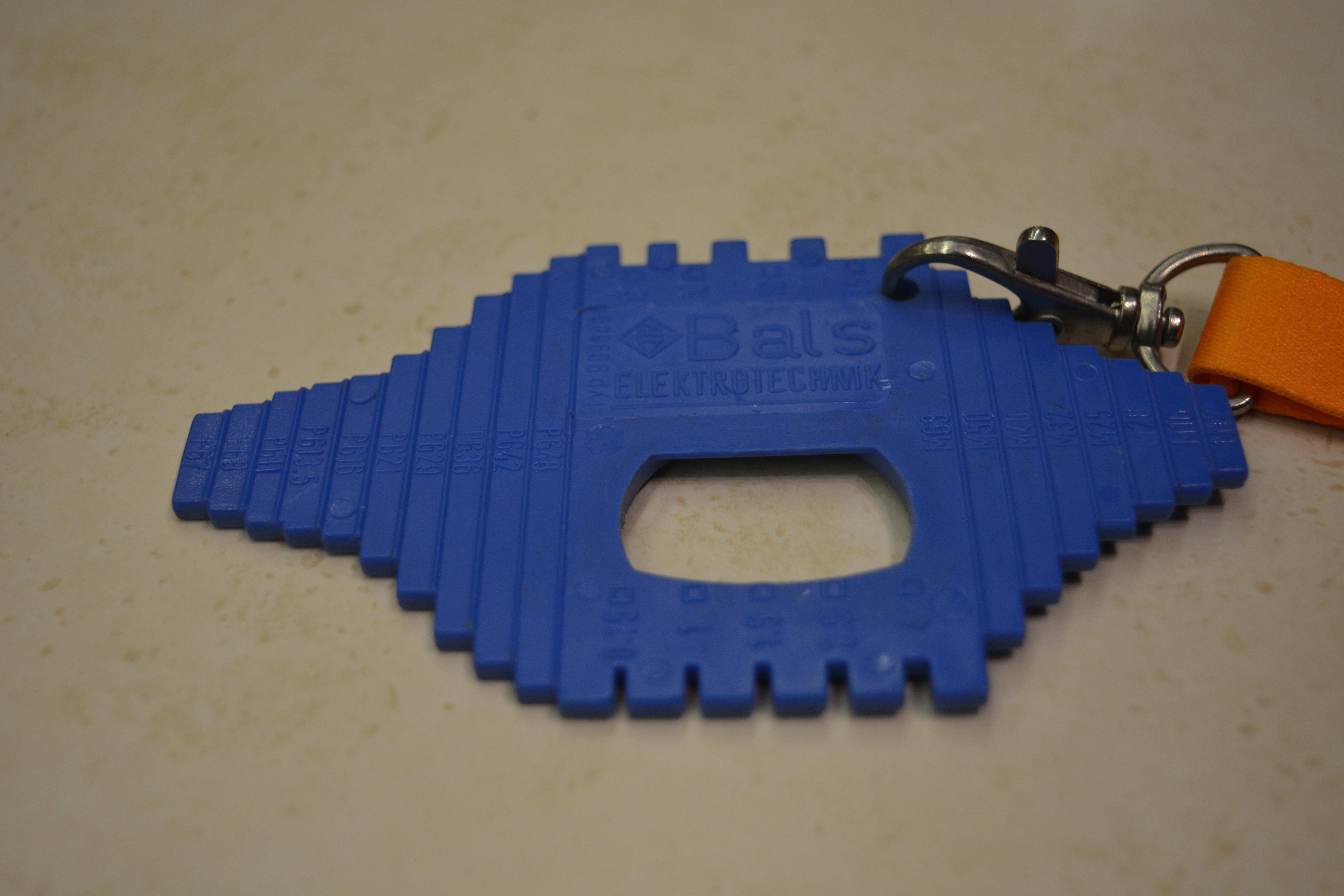

    Probably a friend means such a "comb" -
    Diameter / cross-section - What is the diameter of the LGY conductor.

    Where can you buy such a "comb"?

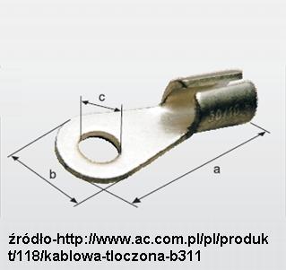

    Then measure the diameter of the cable you have, and then order the tip. By the way, you'll either use a press or solder the tip, so a little slack will be lost.

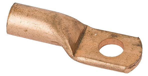

    It is better to let it go with this soldering.
    Pressing recommended.

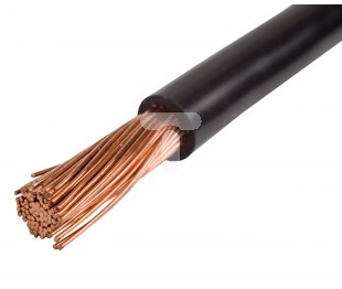

    How to convert the cross-section of a conductor of bare copper (stranded) LGY 1x25mm? and 1x16mm? into diameter in mm. There are some tables or ordinary geometry for this. Will these patterns be correct for stranded wires. Diameter / cross-section - What is the diameter of the LGY conductor.
    The patterns you give are true for single wire only. Cross-section in the line
    total is the sum of the cross-sections of individual wires. However, the diameter is also influenced by the size of the space between the individual wires. Black in the picture
    The size of this space depends on the way of weaving the wires that a given producer chooses. Therefore, diameters cannot be calculated uniquely, only measured.
    As for the method of connecting the tip with the wire, the best solution is to crimp it while soldering and additionally pull a heat-shrinkable sleeve over the tip tube.

    NOWY_UCZEŃ wrote:
    And the oxidation of copper. However, when soldering, the wire - tip tube contact is permanently secured and the contact is concrete.
    You can never be sure that the solder is completely distributed inside the tip.
    Press the end, before pressing, put on the heat-shrinkable tubing and shrink it after pressing.

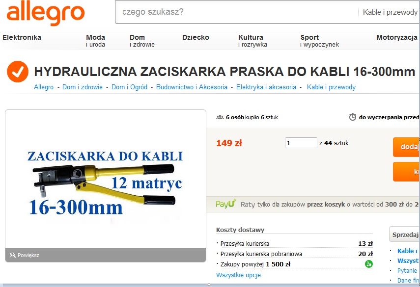

    NOWY_UCZEŃ wrote:
    I feel a bit cynic in this suggestion that as a crimper it is only available for
    professionals with a very thick wallet.
    I don't understand at all where cynicism is. I just wanted to make a statement that the Praga is a suitable tool even for inexperienced hands, while proper soldering is not easy even on a laboratory table, let alone in the field. With this technology, you must have experience, appropriate tools and auxiliary materials. In addition, you should know the technology of manufacturing, what materials are soldered with, so this is not a topic for students.

    NOWY_UCZEŃ wrote:
    Well, it is not so for hobby work
    NOWY_UCZEŃ wrote:
    about 70V DC but high currents.
    High currents are probably not a hobby anymore, and Praga for PLN 150 to 300 mm2 is probably a laugh in broad daylight.

    Apparently, my friend did not have it in his hand, and only suggests the price. It's a good crimper for the price. In workshop conditions, you can clamp in a vice using appropriately shaped dies.
