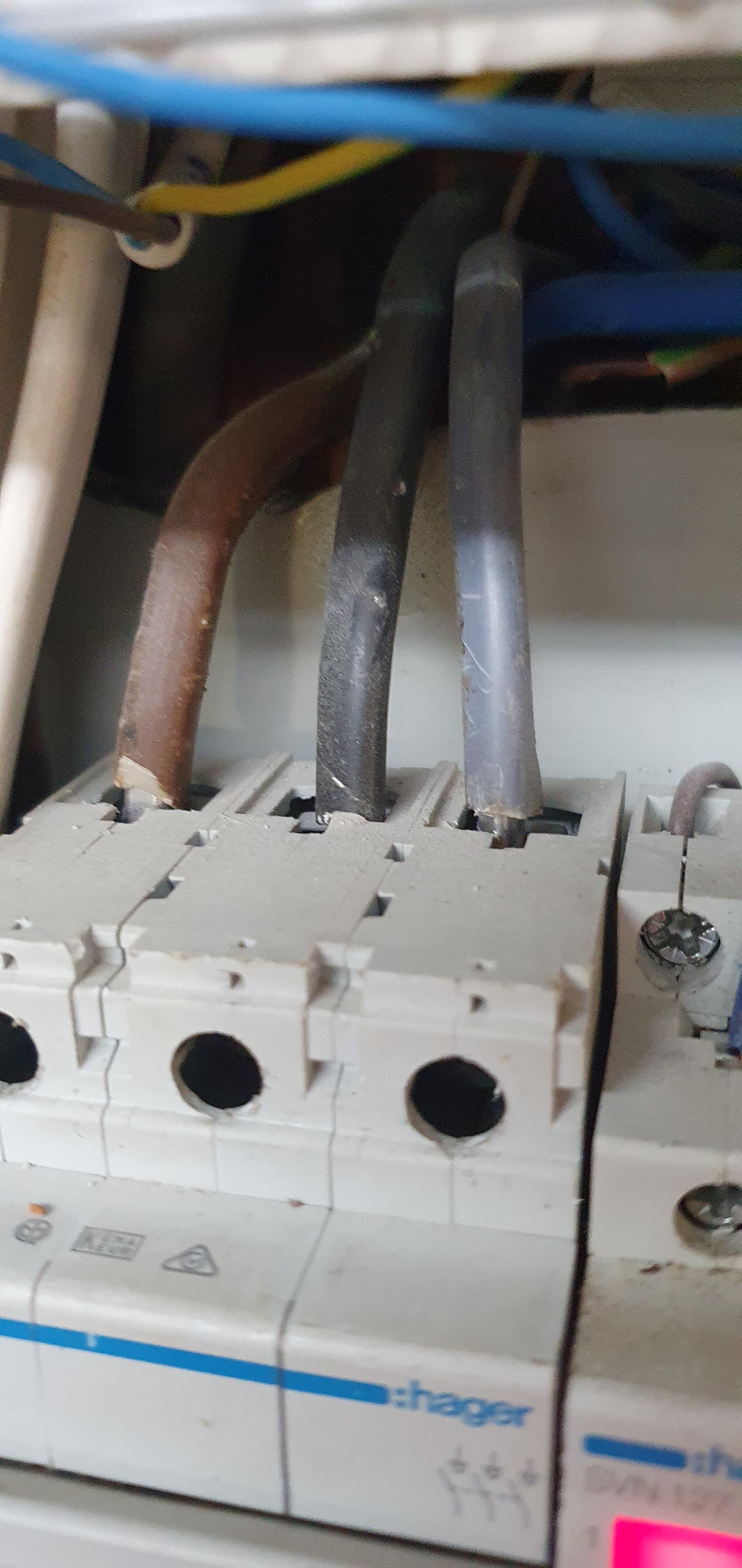

    I am still asking for help in determining the cross-section of the cable at the connection to the house.
    The cable is aluminum 4x? but its cross-section is close to a triangle. I measured with a caliper and it is about 4mm at the widest point.
    Will it be something around 4x10 or maybe due to the triangular shape not round it will be 4x16?

    Personally, I have never come across a 10 mm square sector, and 16 definitely. If the connection was made not long ago, 10 is not realistic. For many years, the minimum cross-section of an AL conductor has been 16 square mm.
  • #23 19020303
    pejan 123
    Posts: 18
    I thought so too. This is good news for me. Thanks.
