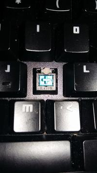

    Hello, I have a Tesoro Excalibur RGB keyboard with Kalih Blue switches. Yesterday I flooded a few keys with cola, I immediately cleaned what I could. Today, when I got home, the keys were flooded and hard. The sugar cola had dried up in the switches and it was just fine. I cleaned it with a drop of water but it helped for 2 hours. I tried again and it rather broke for amen. The switch under the K key does not have a characteristic click, when you press it and let it go, it writes K a few more times. When I press J it writes "JK" to me.
    Can it still be repaired?
    Flooding is unlikely to be covered by the warranty. Is there any mechanical keyboard service (I didn't find anything in googles), a switch shop or anything else that I wouldn't have to pay for a new keyboard PLN 400?

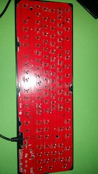

    I did as you said, I sprinkled the switch for half an hour, then air - it helped for a few hours, I left it to dry completely overnight. In the morning, when I clicked, J works fine, but not too well (there was less cola there), and K, after a few presses, again there is no click and resistance. I'm afraid it will stick again after a few hours. Well, I saw that I also had to clean H and I because they stuck together after a night. Previously, they worked well, so she probably caught the cola now.
    I also attach photos of what it looks like "from the back". Zero access. Only the one I showed before: /

    Well, one more idea came to my mind. Swap (if possible) K with another, least-used button, or deeper disassembly and thorough cleaning.

    I had the same idea yesterday, but I have switches so that I can't take them out. I mean, you can probably do it, but I don't have the tools to do that. The switches are soldered to the board just like in this keyboard

    You probably need to disassemble it more, separate the red plate from the rest, and the button itself looks detachable and is soldered. If you got there from the top, it would probably do without a spout.

    These are CherryMX switches and I have Kailh. I was just trying to disassemble them just like Cherry, but mine have a slightly different structure and I don't even have anything to approach (4 holes with a thickness smaller than a paperclip) and whether they can be taken apart from the top at all. All guides on YT are for the switches in the photo and they can be easily opened and if someone has mounted on the board, they write it like I do to unsolder, but I don't know if to replace it completely or just to open it.
    However, I decided to use spirit and I am in the process of cleaning, after a few clicks they were like new, but we'll see how it all dries up and if it won't be like water after the colon's hours.
