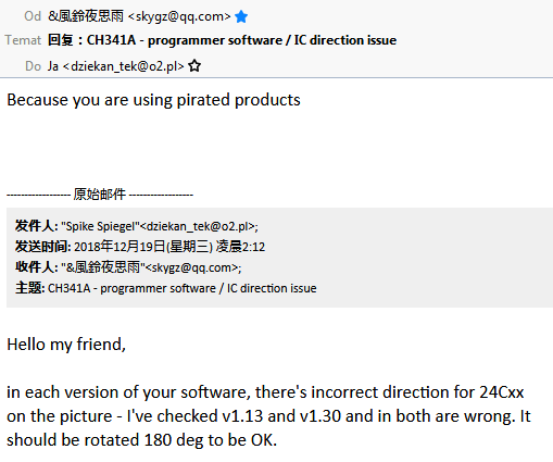

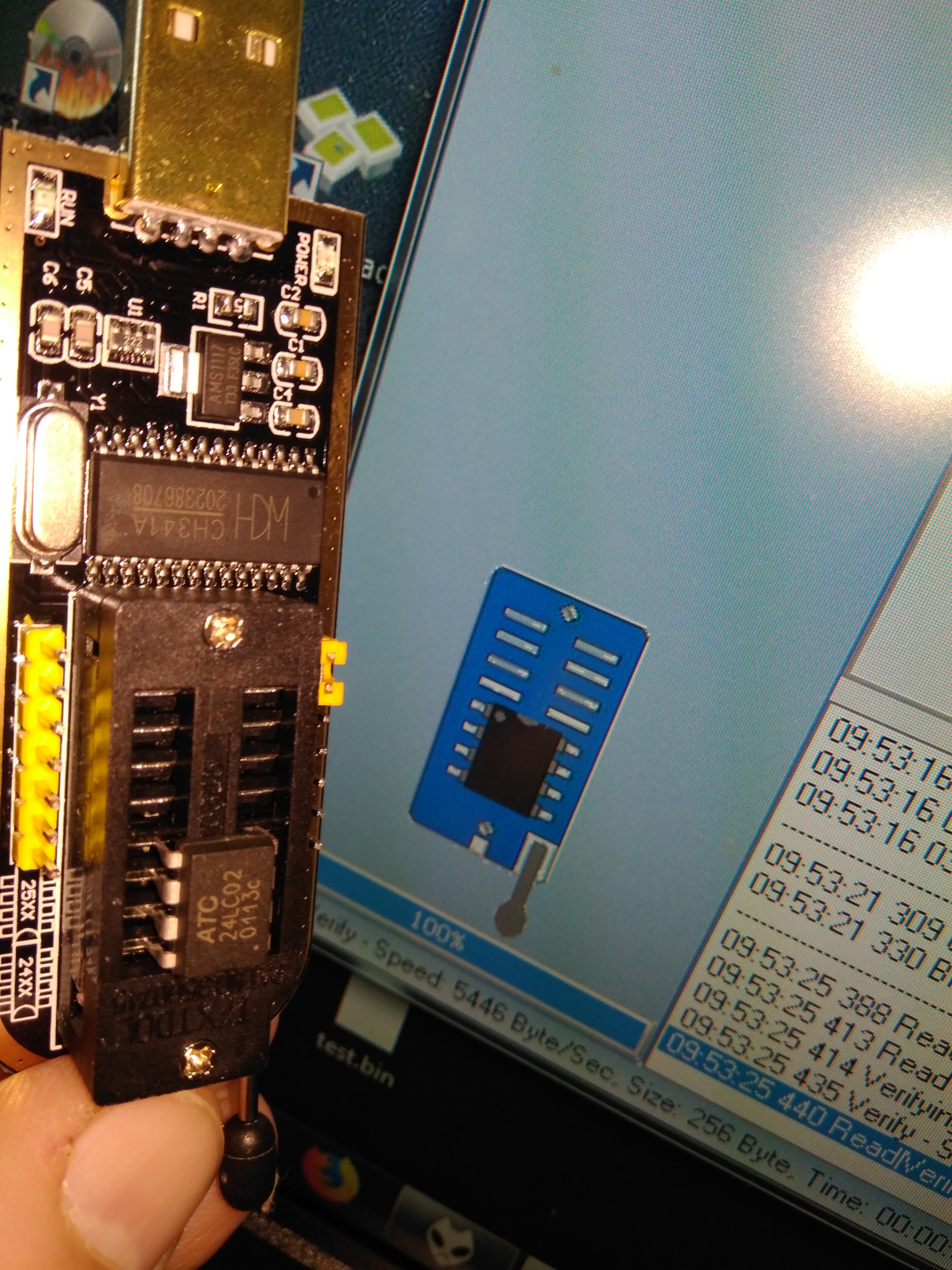

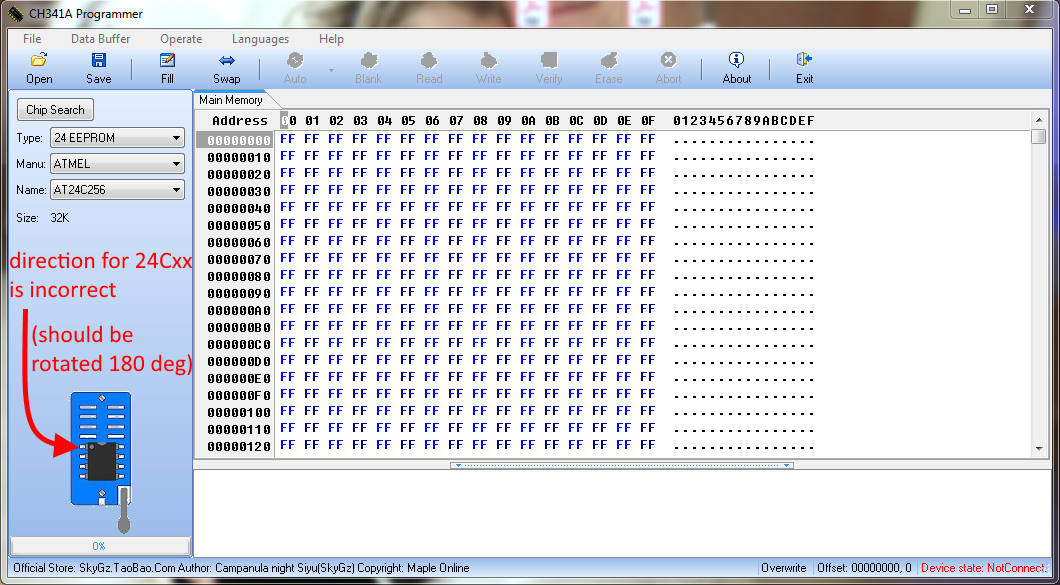

    I don't know if anyone noticed, but in all versions of this software for CH341A, the wrong IC direction is indicated, i.e. in the case of 24Cxx it should be rotated by 180 degrees ...
    In mine it is yes, of course, for the first time I put the system in the opposite way.

    Exactly. For me, exactly the same situation :)
    I do not know what the author of this software meant when he uploaded a picture of how to connect the system ...

    Version 1.4 does not have this picture anymore, I looked at 1.3 - with each layout, the notch is in the opposite direction.
