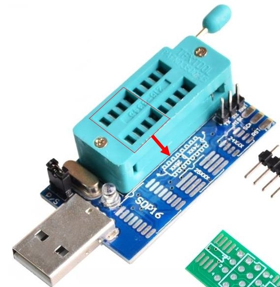

    Hello, I have a mini CH341A programmer and a board for it, I want to program a 25x16 winbond bone and I do not know how to embed it in the programmer and how to set the board in the programmer. I am asking for some instructions because there is absolutely nothing where the bone should be attached.

    How is "there is nothing where the bone should be attached"? Even the attached picture shows where and how (the cut in the bone) insert the bone from the 25xxx series.
    Mini CH341A Programmer Guide: How to Set-up, Embed & Use with Winbond 25x16 Memory Chip
    If it is SMD memory, you can solder it directly to the programmer board - on the right side there are solder pads marked as 25xxx.
    greetings

    It is true that the Chinese "bushes" supported by the "pictorial" script.

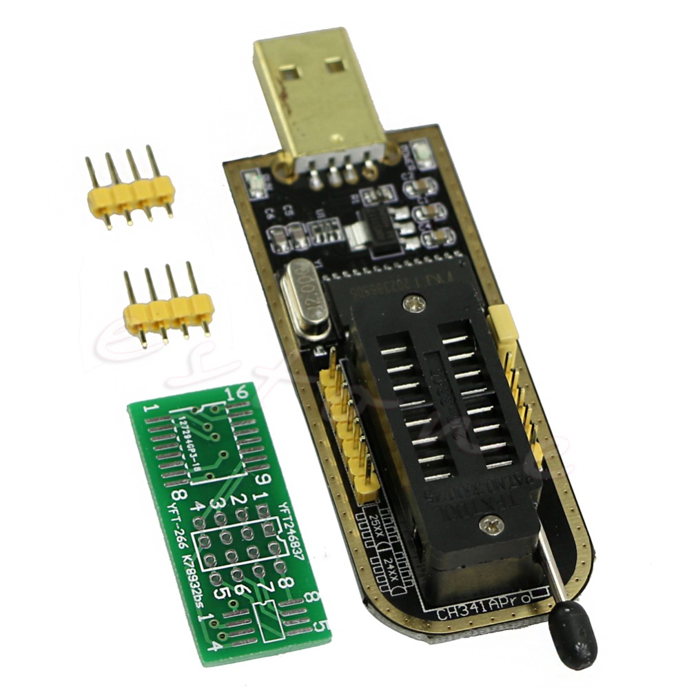

    This marking on the programmer can be confusing.
    There is a small arrow in which direction the beginning is drawn though the opposite. :) In the version 1.30 appendix, after selecting the correct memory, it will show you how to mount the memory in the slot.

    In my humble opinion, I will not agree with you. Depending on the version of the program, there are other instructions for mounting the memory in the "slot" and all are incorrect. I have a CH341APro programmer, and so for Hecy I inserted the ST24C04 memory (and what I have, I have a lot of them) according to program indications, contrary to the description put on the programmer and after such treatment it became a "souvenir".
    Proposal.
    Mount the given memory as described on the PCB of the type of programmer.
    Greetings.

    I know that the programs also show badly but this marked description on the pcb for the layman is equally "accurate." As for memory damage, I did not even have time to put in a special way.

    Maybe someone translated the jumper into communication pins?

    @gumisie I have the one you recommend, and the problem was as it was written @ E8600 bad jumper, I put it on correctly and it went
