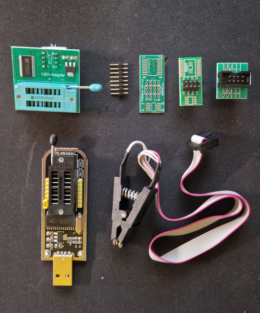

    some versions of the CH341 programmer may use 5V voltage levels on the SPI lines, which SPI flash chips may not expect, so if you have concerns, consider buying the latest CH341 version or making a 3.3V mod for the older version (just switch the power supply and mode to 3.3V ).
    The matter is even more complicated with systems that require 2.5 or 1.8V, and for some time there are more and more of them even in quite unsophisticated electronic devices.
    The programmer at first glance looks really good, but in practice the adapters for lower voltages are a must at the start.

    Recently I had the need to program Flash to 1.8V. Due to the fact that I did not have any programmer that supports this type of memory, I quickly soldered a makeshift one according to this description: http://rayer.g6.cz/elektro/spipgm.htm
    The memory connected to the spider was easily detected and programmed correctly.

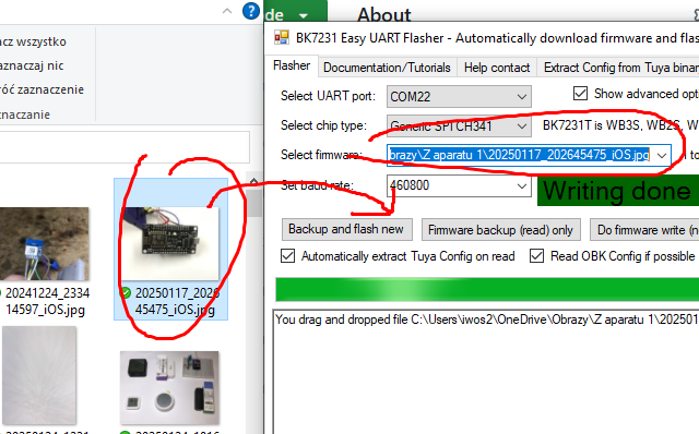

    OBK Easy Flasher has now basic SPI support. Can you check
    Follow instructions from video, but use our flasher.
    Implemented features:
    1. Read flash (detect full 2MB size).
    2. Write flash (you can also DRAG AND DROP file on flasher):
    Screenshot of BK7231 Flasher with incorrect JPG file selected as firmware
    3. Also "Verify" should work
    4. Also "Erase all" (that's a full chip erase) and Blank check.
    You can verify with Neoprogrammer.
    Which flash chips can work well with our flasher and which do not? Which flash chips do you have?
    Extra task: Get A9 camera from Aliexpress and help us support this chip - why it fails to flash even with Neo?
    https://www.elektroda.com/rtvforum/topic4074636-240.html#21707905
