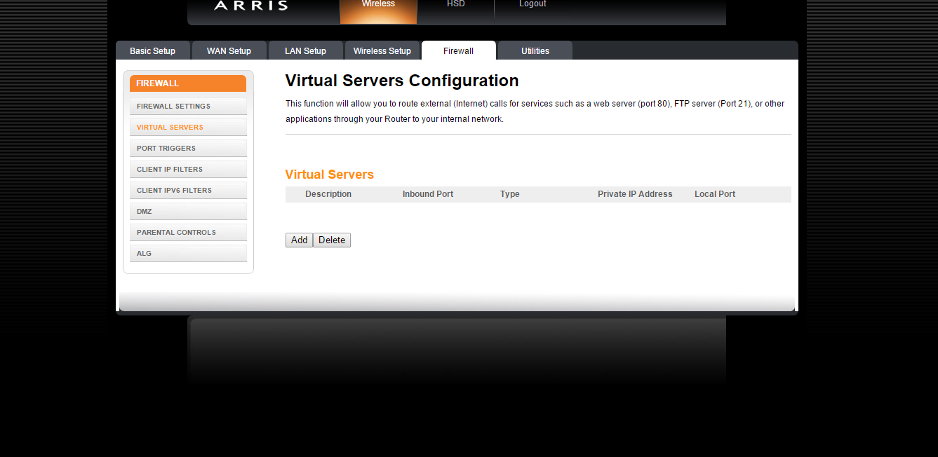

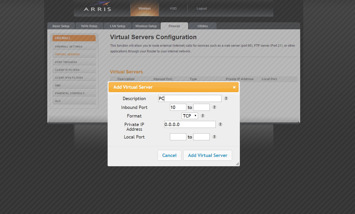

    Or maybe something needs to be set here?

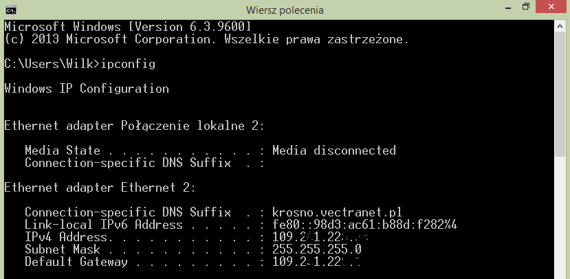

    I called and got it. Now I only have internet on my PC. WiFi devices cannot connect and get an IP address

    They switched the modem to bridge mode - so you have a public address on your computer, and since you have only one assigned, more devices have the right not to work in this configuration.
    In my case, I asked for such a configuration myself, because I have my router (TPLink 1043ND v2 with OpenWrt), on its WAN public address and I can do whatever I want on it.
    Coming back to the topic of discussion. IP in Vectra does not change often (I was one more than half a year), so you can get over it and if you change it, you can change it in the configuration of the camera preview program.
    You can also use an external VPN server (I use OVPN myself installed on the purchased VPS server), but this is a dependency on some external service. I have the same opinion about all types of dynamic DNS - everything works, and suddenly the free account expires and the meatball.

    That's right - not necessarily a bridge, but the lack of WiFi access indicates it (unless they changed something else on the occasion). If it gets a public address on the computer, it will not get to the router's panel if it does not set the address on the network adapter in the same subnet as the router.
    But there is no need to guess - paste the result of ipconfig, it will be known.

    Obtaining a Permanent IP Address with Vectra: Home Monitoring & File Server Setup
    This is what it looks like in CMD
    and as for the router, they denied me access.
