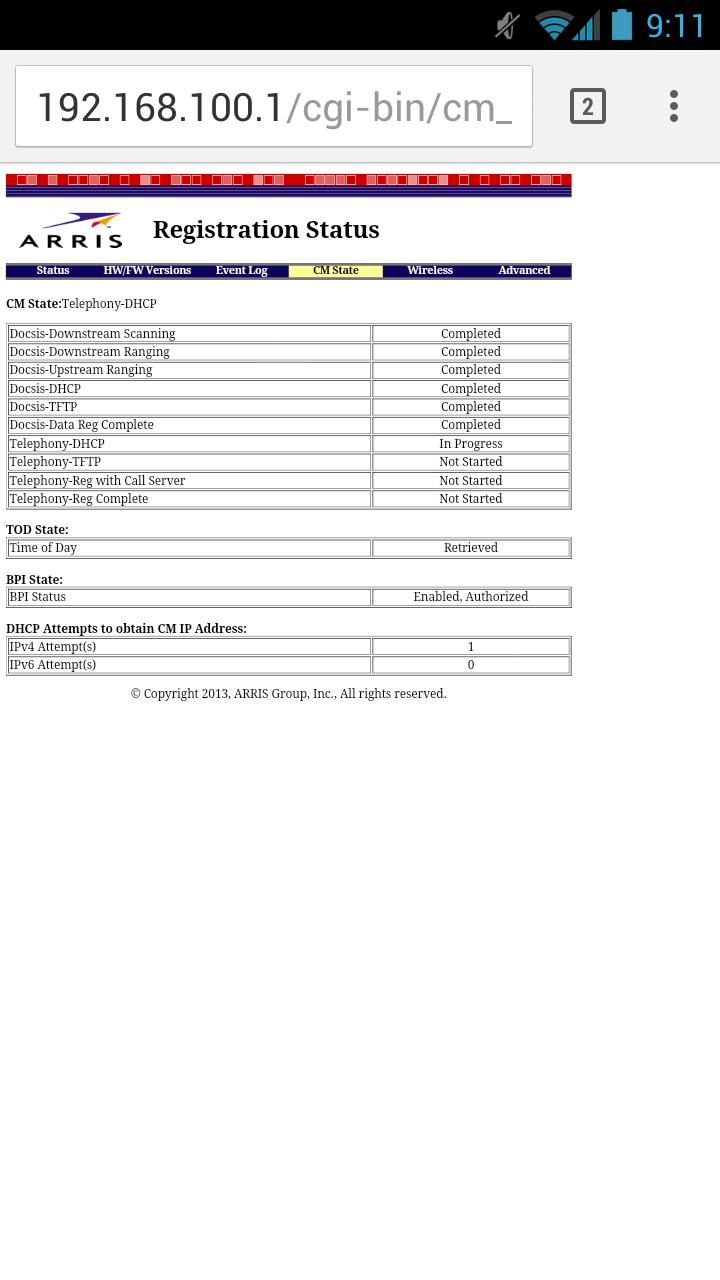

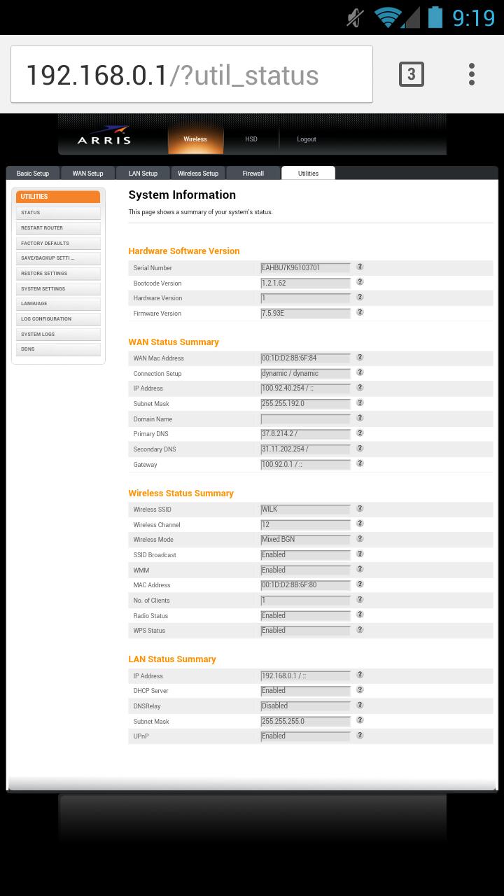

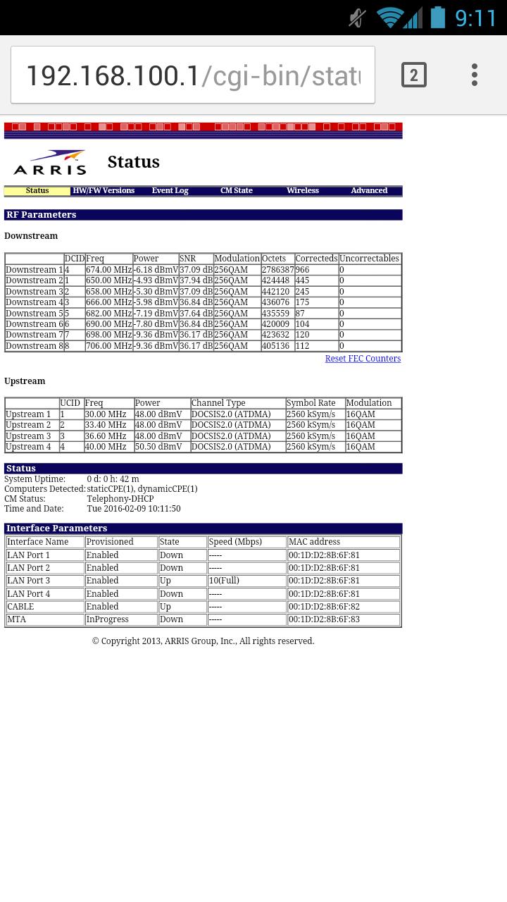

  • #15 15418472
    Assasin74
    Posts: 163
    Rate: 9
    Spoiler:
    Obtaining a Permanent IP Address with Vectra: Home Monitoring & File Server Setup
    #16 15418491
    VooVoo
    Posts: 2177
    Help: 215
    Rate: 266
    First of all, it is necessary to adjust the signal in the downstream. He's too short.

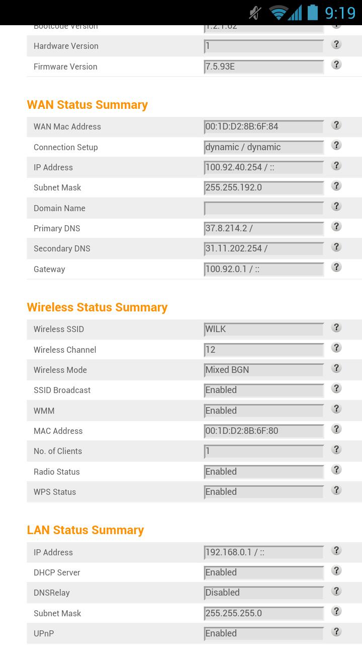

  • #18 15418602
    dedito
    Posts: 4770
    Help: 527
    Rate: 595
    According to the screenshots, the router has a public IP address assigned from DHCP (so it may or may not change).
    When you have full access to the server, you can redirect the ports yourself or set the camera to the DMZ.
    Additionally, it may be necessary to use DDNS services.

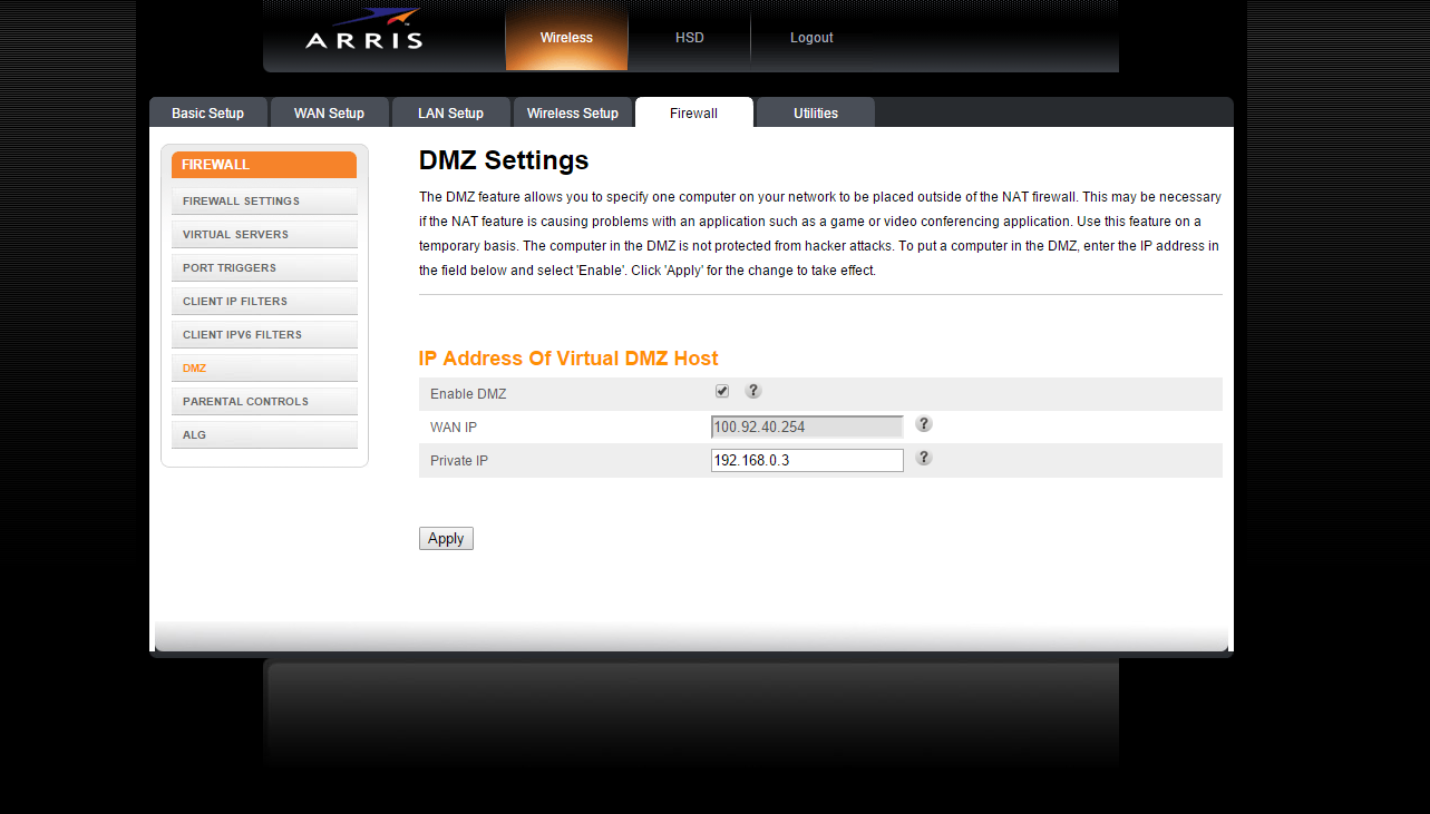

  • #22 15419245
    dedito
    Posts: 4770
    Help: 527
    Rate: 595
    10 screenshot, i.e. Firewall / DMZ Settings, enter the camera address in the Private IP field, save the settings and check the effects.
    Assasin74 wrote:
    The instructions are in English, but unfortunately I don't know the language.
    I also found one in English but there are no configuration pages there.
    UPDATE:
    Well, and enable the option: Enable DMZ.
    ADDITIONALLY:
    DMZ is only for one IP, so to provide external computer and camera (2 IP), you will need to use the settings in the virtual host section to forward selected ports.
  • #23 15419266
    Assasin74
    Posts: 163
    Rate: 9
    Unfortunately it does not work. Maybe the first one with a PC because it's easier to check if it works when it comes out of the PC, I can intuitively deal with the cameras
  • #24 15419268
    dedito
    Posts: 4770
    Help: 527
    Rate: 595
    You have to check it from the outside.
    After making changes, give a screenshot so that you can see what you changed.
