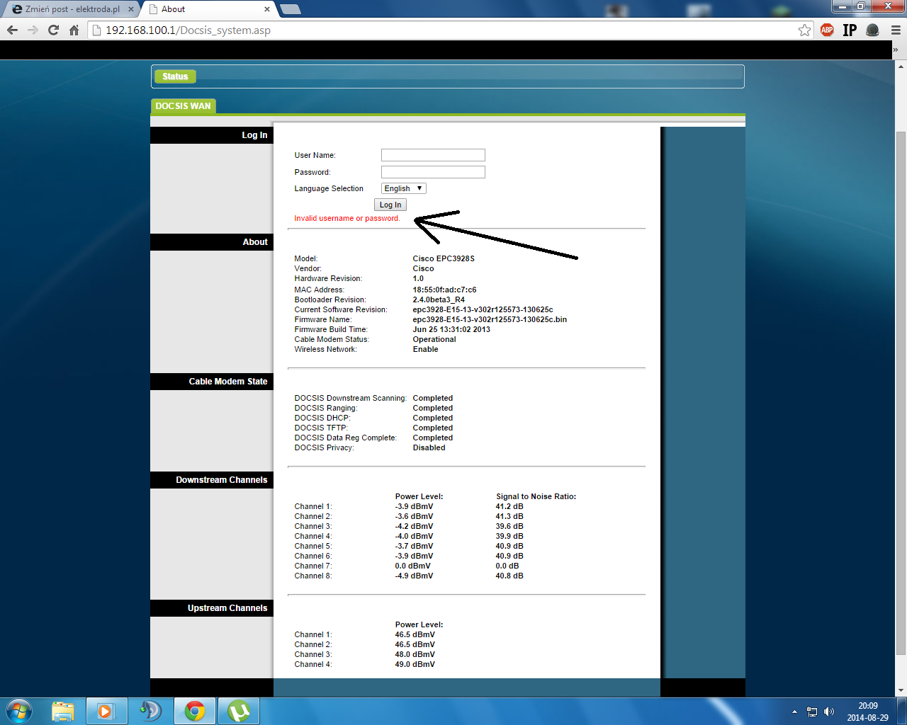

    As in the subject, I have a new internet from Vectra and I have a modem with WIFI. 30Mb / s Internet with a modem with a built-in wifi router. Modem model: EPC3928S (read from the bottom of the sticker) and the problem is that neither the bottom of the modem nor the back has the IP address to which I should go, nor the login and password. Please help!
    If you still need something, please describe where exactly it is, because I have big problems with configuring wifi and reading what is written on it and what it is for, etc., so please be understanding!

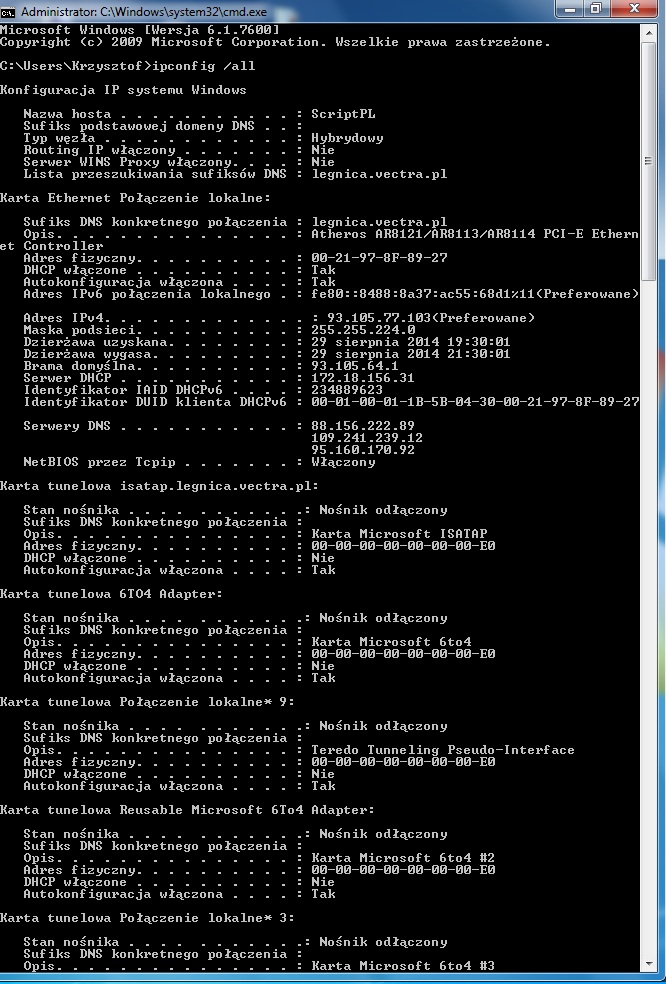

  • #4 13918300
    ValValiantThor
    Posts: 2173
    Help: 160
    Rate: 150
    CMD
    ipconfig /all
    W ethernet
    Brama domyslna (default gateway) to adres routera.
  • #5 13918324
    krzysztofer100
    Posts: 255
    Rate: 35
    ValValiantThor wrote:
    CMD
    ipconfig / all
    In ethernet
    The default gateway is the router's address.
    Check for yourself (I'm not covering anything to make it legible ..)

  • #6 13918372
    safbot1st
    Posts: 21951
    Help: 2719
    Rate: 1585
    krzysztofer100 wrote:
    earlier I found the same address, but instead of "0" there was "100" so even there both logins with passwords do not work ...
    So you have login access under 192.168.100.1?
    Enter in username: admin
    and leave the password field blank.

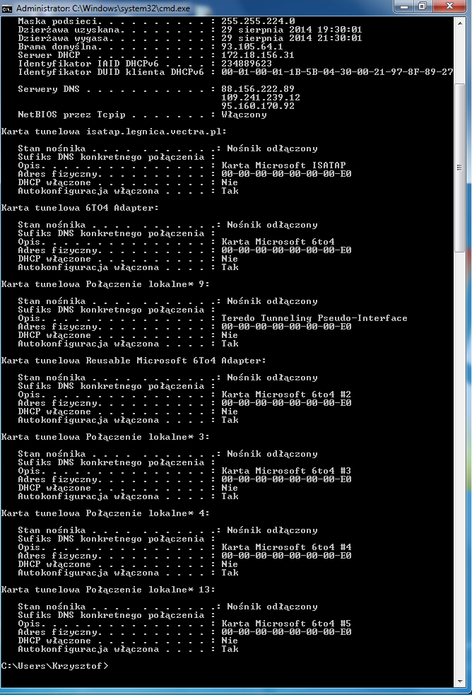

    You just blocked the wireless network connection :D bottom. ;)

  • #8 13918462
    safbot1st
    Posts: 21951
    Help: 2719
    Rate: 1585
    In this forum, I am not allowed to post how to remove the password :(
    https://www.elektroda.pl/rtvforum/topic2441798.html
    Here is a hint and a little more about modem routers from Vectra:
    https://www.elektroda.pl/rtvforum/topic2236742.html
    The topic shows that only vectra knows the password and changes the settings on request over the phone. (eggs) :)
    In this case, we will not solve the topic specified in this way:
    "How to configure WIFI? -"
    We can only run wi-fi to make it work. Configured by the provider.
    Also, in ipconfig you don't have any wi-fi connection at all - no wi-fi card so how are you going to connect to wi-fi?

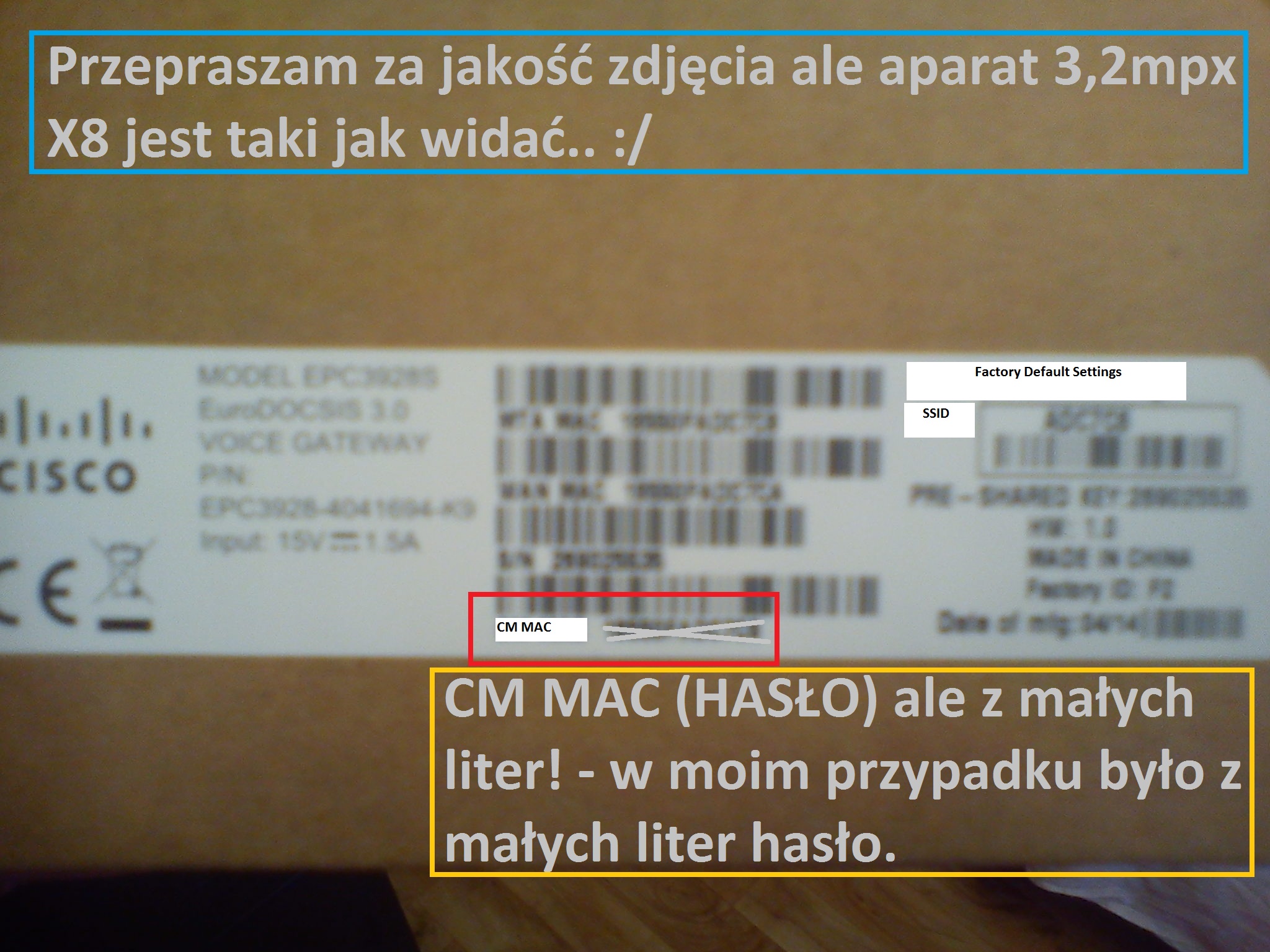

  • #10 13919500
    VooVoo
    Posts: 2177
    Help: 215
    Rate: 266
    The name of the network is the vnet compatible with the modem mac and you need to ask for the password in the Customer Service Center.
  • #11 13920398
    krzysztofer100
    Posts: 255
    Rate: 35
    Welcome back,
    I was at the Vectra point, they gave me the password, the router is configured once and it is not possible to change the SSID or PASSWORD, because I asked. The password is also stated on the modem box, but marked differently (Not "password", "password" or something else), ie "CM MAC" below is a photo, but it has been corrected by me because the quality of the Xperia X8 camera is insufficient to reproduce clear sharpness .. Everything is the same on the other packs of Vectra.
    I close the topic with the idea that it will be useful to someone :)
    Greetings.
