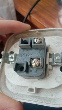

    I wanted to connect a doorbell, unfortunately I'm not very familiar with what I encounter.
    The case is as follows, there are 2 wires in the switch box, and the switch looks like this:
    Connecting a Doorbell: Wiring Switch Box and Wall Box - Two Wires & Connection Scheme
    There are also 2 wires in the box in the wall (power supply). I came up with this connection scheme:
    Is it correct?

    I don't quite understand what you wrote, but the bell switch should only interrupt the phase wire.

    And I thought it was the other way around. The switch shorts the phase wire when I press to ring, otherwise it's a tarabani chime all the time.

    Yes. you wrote ok.
    Earlier I wrote that the bell switch should be installed only on the phase wire and not on the neutral.

    So is my diagram correct?
    Except that there is probably voltage in the wire that returns from the switch to the doorbell (I don't press the switch), because the diode in the tester (screwdriver) is on. It only shines as if weaker than on this wire entering the switch.

    That is OK.

    Is it the fault of the switch and not isolating the phase?

    Is the bell button?

    Yes, bell.

    The neon lamp glows but weaker because a small voltage is induced in the return wire from the connector because this wire runs parallel to the live wire going to the connector - the neon lamp is very sensitive and therefore glows slightly.

    Thanks for the enlightenment :-)
