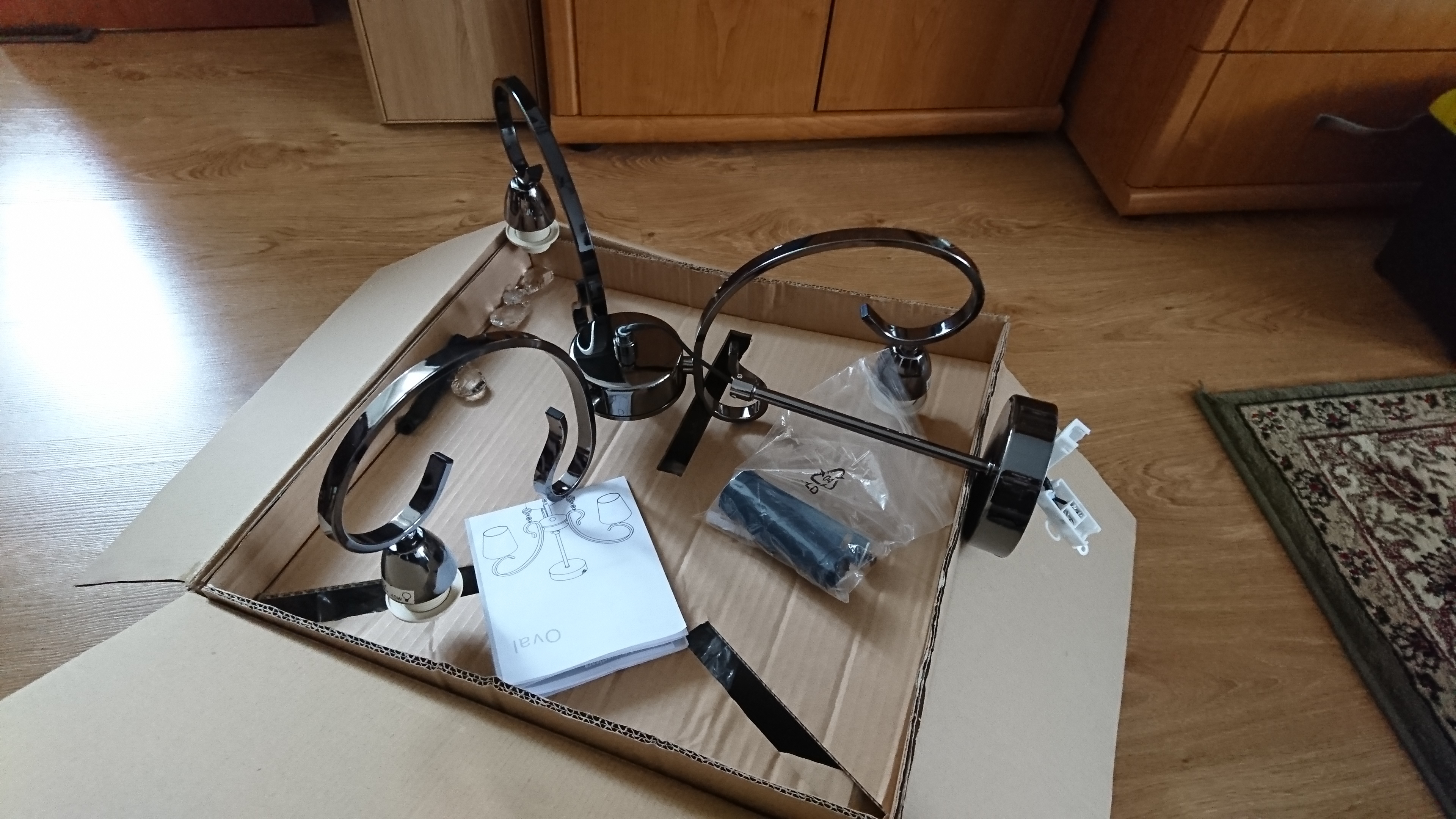

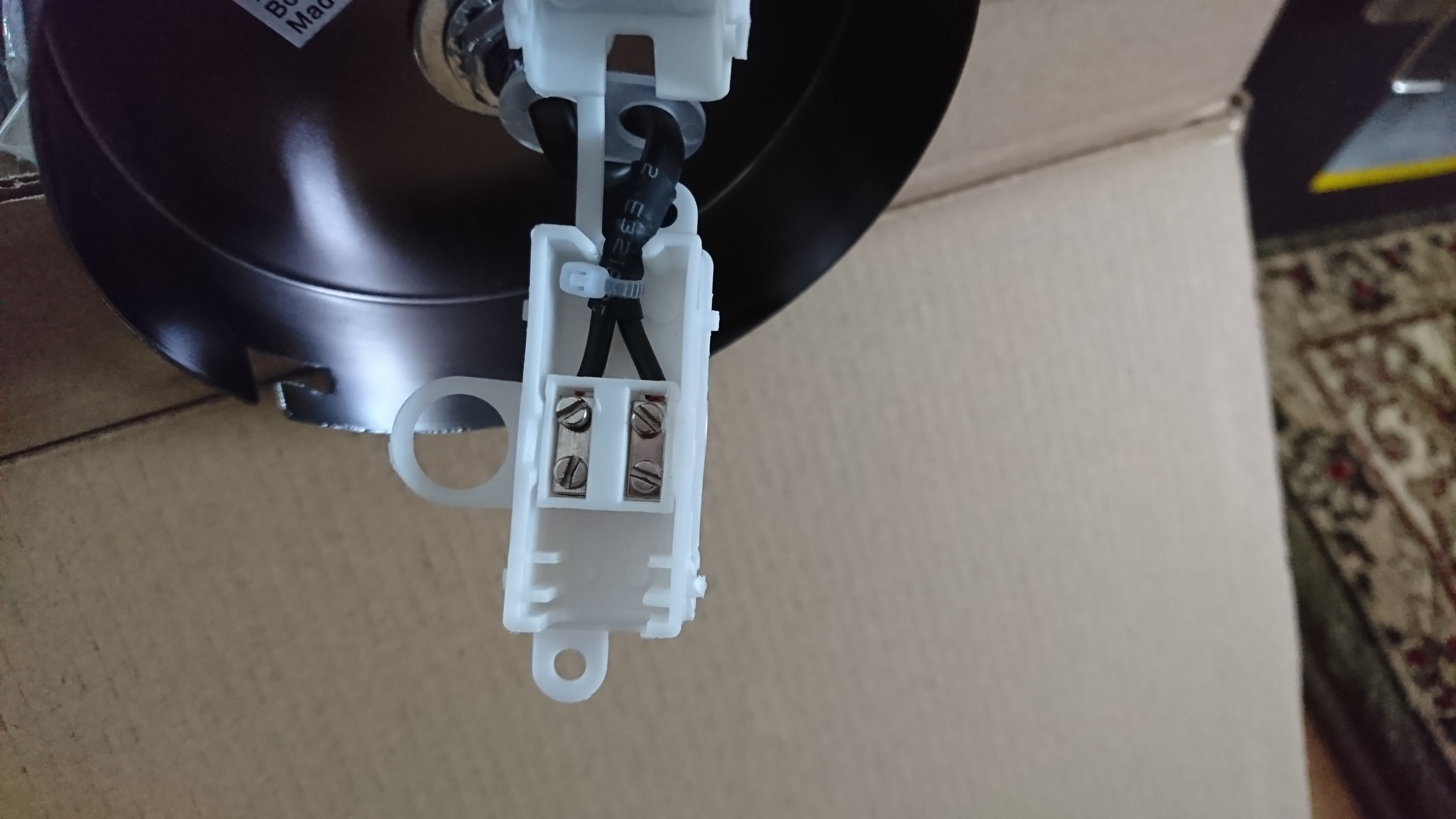

    I bought a chandelier that has a cube for 2 inputs to connect and I have 4 wires from the ceiling (black, brown, blue and green-yellow). Blue is neutral, phase is on black and brown. Yellow-green is plugged into the ankle but on the other hand no more cables come out.
    How to connect it so that it is possible to turn on 1 or 2 bulbs - 2-button switch. I am a complete layman when it comes to electricity.

    How many wires are connected to the cube in the chandelier?

    Metal chandelier, cubes in the chandelier are in wires (two veins). I don't have a meter, just a neon sign.

    Nówka from leroy
    Chandelier 2 Inputs vs 4 Ceiling Wires: Connecting for 2-Bulb Control with 2-Button Switch Chandelier 2 Inputs vs 4 Ceiling Wires: Connecting for 2-Bulb Control with 2-Button Switch ] Link [/url]
    link

    Subject to close. The lamp is factory-fitted for 2 + 1 connection. Thanks to everyone for your help. Greetings.
