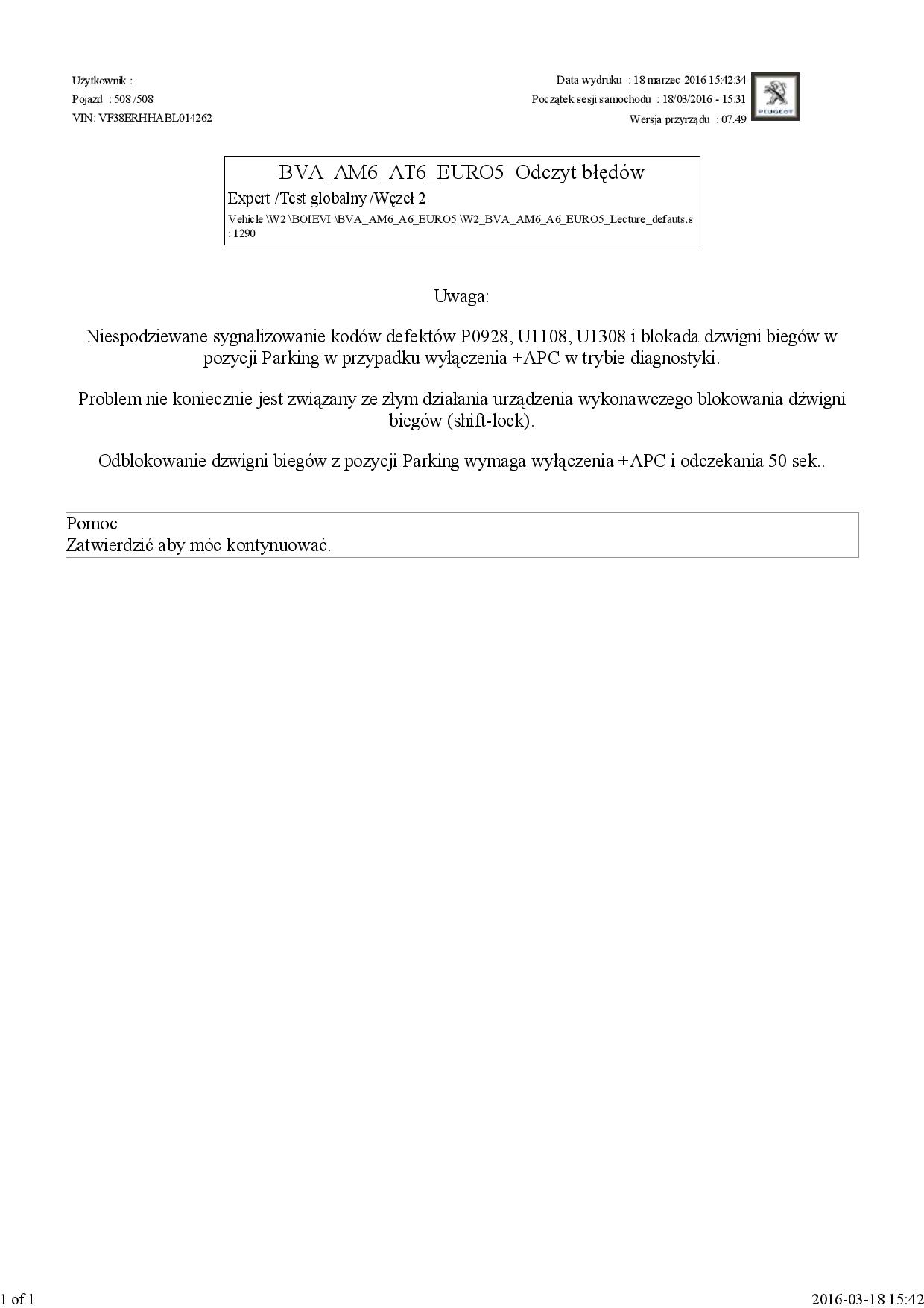

    Maybe someone knows what happened. Yesterday I turned off the engine with the gear lever in the "P" position. After a few minutes I wanted to start the car and it started:
    - an engine fault message was displayed
    - and then after 1 sec. the message "gearbox damaged, repair the gearbox" was displayed
    The car starts without a problem, only when you try to engage the gear in "D", the lever moves with a clearly perceptible resistance as if something is blocking it. Then there is a powerful jerk of the wheels as if there was play on the axle shafts. Up to that point the car had performed very well. Today I will be connecting from PP2000 to it, only then will I know something more "knew the fault code". In addition, after switching on "D", the gearbox only works in 3rd gear in emergency mode. The car has traveled 200,000 km on very long stretches. Anyone have any ideas, suggestions, or maybe already encountered such a case. I personally read somewhere that the flow meter may be the cause and that is why the information about the engine fault appeared first and then the gearbox went into emergency mode.
    Regards and hope for some information.

  • #4 15536769
    dior3
    Posts: 25
    Rate: 19
    Welcome back,
    Yesterday I made a PP2000 scan and after detecting almost 20 fleeting errors from the error of locking the door, blocking the left front wiper and engine and transmission faults that disappeared after a 14-hour stop. I came to the conclusion that it could be either an ABS sensor or a battery on the finish or tarnished contacts on the CAN bus (I had this situation in Berlingo and only then the horn did not work for me. Because after erasing the errors and driving almost 200 km, the errors do not return Soon I will test the efficiency of the battery at a friend's workshop and, by the way, I will lift the car and look at the wires to the ABS sensors. Then I will let you know.
    photos below.
    Peugeot 508 SW 2.0 HDI 163HP AUTOMATIC Emergency mode of the gearbox Peugeot 508 SW 2.0 HDI 163HP AUTOMATIC Emergency mode of the gearbox Peugeot 508 SW 2.0 HDI 163HP AUTOMATIC Emergency mode of the gearbox
    or
    https://obrazki.elektroda.pl/5638641800_1458388659.jpg
    https://obrazki.elektroda.pl/8604236800_1458388661.jpg
    https://obrazki.elektroda.pl/9965556900_1458388662.jpg
    Regards.
