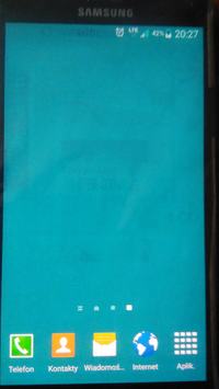

    Hello. I have a problem with the display, the point is that the shadows of the previous open items remain, icons and so on. The phone is after replacing the screen and touch, but unfortunately it was flooded, the guy in the service said it was the fault of flooding, it seems to me that it is the fault of the display itself, not the motherboard. Can someone guide me what to do with this guy? Send it to another site or it has to stay that way? Screenshots are coming out normally, which is how it should be.
    It was flooded before replacing the screen and the touch works without a problem.
    Regards

    If it looks like this, the LCD is probably burned out
    LG G4 Stylus Display - glow from previous activities remains - icons etc.
    It looks exactly the same to me. only that what turns on stays glow whether it's YT or browser everything stays ... the display is like a new original lg at least that's what I was told ... phone received yesterday from repair ...
    so it's definitely not the fault of the motherboard, but the display made in china ...

    It turns out that the fault lies in the display, however, since you have the same symptoms.
    If the phone was flooded before, did they do something with it in the service? Did they even clean the motherboard? Did they just replace the display itself?

    I just gave an example photo from a burned-out display (such things usually happen in post-exhibition phones that have one and the same application running all the time)
    I will ask again
    Did they at least clean the motherboard? Did they just replace the display itself?

    The code works thanks. Screen test first FAIL I can't see anything, I can only see what was turned on, I'll take a picture for you and you'll see what it looks like. The second white screen is supposed to be and is passed.

    If you have any fails when testing the display in this menu, in my opinion you have proof that there is something wrong with the display.

    LG G4 Stylus Display - glow from previous activities remains - icons etc. LG G4 Stylus Display - glow from previous activities remains - icons etc.
    Made with an old phone ... that's how everything looks transparent as much as possible

    You should take it back to the service and if you have a receipt from this exchange, they should accept it, since you have errors in this menu, it must be the fault of the display.
