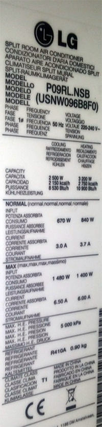

    Hello. I would like to know what fuses to secure the connection of the air conditioning to electricity.
    At present, the air-conditioning was connected to the electricity by a simple plug (air-conditioning, wall-mounted, air-conditioner, but air-conditioning, together with the outdoor unit).
    I did so in order to turn off the air conditioning from the socket in the event of a long absence (especially before storms).
    Currently, I would like to connect the air conditioning also to the socket, but on the way to the device itself, secure it with a fuse / fuses - i.e. a small fuse box. I can't connect the air conditioning directly to the fuse box - technically I don't have that option.
    I'm not an expert in this field, but I like to play with the flow and so far I haven't burned anything :)
    In the event of overvoltage, voltage surges, I would like to protect the air conditioning device against failure (e.g. when one of the devices connected to the sockets in the room short-circuits - I would not want the AC to suffer from this).
    And now a question for you - what fuses to use (type and power)? I will rather be able to connect it (I think so).
    My air conditioning is:
    Selecting the Right Fuses for Air Conditioning Connection and Electrical Safety Selecting the Right Fuses for Air Conditioning Connection and Electrical Safety
    Any advice?

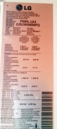

    I added pictures of the outdoor and indoor unit - all given

    Your device has all the security features inside one. Your task is to insert a fuse that protects the electric wire that powers the device.

    From what you wrote, I understand that:
    the air conditioning will not burn or damage because it has all the protection inside the outdoor unit.
    But it can burn or damage my air conditioning cable ...
    I am not an expert, but I know that even the security features inside the air conditioning system may hit the trail one day - no matter what they are .... everything will break down one day. And then I will have to replace, repair the air conditioning unit - disassemble and replace, etc., and I want to avoid this.
    Therefore, I would like to additionally secure the air conditioning - from what I read on other pages, they wrote to connect the air conditioning separately to the fuse box - for example because of the power consumption of the air conditioning (read the air conditioning can be damaged and the air conditioning can damage other devices). Anyway, for my peace of mind, I want to protect the air conditioning with an additional fuse.
    In the air-conditioning, the electric cable supplies the outdoor and indoor unit - the power goes through one cable to two units (the first to the outdoor unit, where the power goes to the indoor unit. power for fuses.

    After all, it is clearly written 6.5 A maximum current in the heating option. You run a new circuit with a 2.5 mm2 cable to the switchgear and protect it with a B10 fuse. I do not understand what you want to defend the climate against. What threats do you see. Because following your train of thought, you would have to additionally secure a refrigerator, dishwasher, washing machine, computer.
