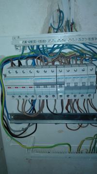

    Hello. I live in an apartment with such a connection box. In the event of overload, the main overvoltage in the cage crashes, and none in the apartment. What's the problem? Anyone see some error? Main Fuse Overload in Apartment Cage Connection Box - Causes & Solutions for Overvoltage [/ img]

    What overloads are you talking about? What is the pre-meter fuse? When was the installation replaced?

    When I connect several devices to one circuit. The upstream fuse is higher than the residential fuse, so selectivity is maintained. Installation for over a year. But the apartment was empty.
    And where is the RCD for socket circuits :?:
    I bet there is no selectivity.
    You will reveal what is the type and value of the fuse that "blows on the cage"
    This behavior only on this one circuit? The rest of the circuits are working properly in the apartment?
    What security in the apartment on this perimeter, and what in the stairwell?
    Where do you get that confidence? Buddy, give details. Selectivity is confirmed not only by the rated current of the protections used, but also by the current-time characteristics.
