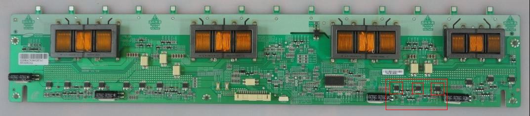

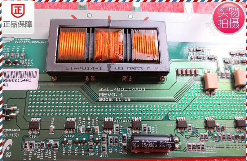

    TV as in the subject, initial symptom - does not turn on. Replaced STR-A6069 chip. There is no backlight after switching on the power supply. After replacing the SEM2107 chip and AO4614 transistors. Inverter SSI-400-14A01 TV turns on for a moment, 24 V voltage is applied to the Inverter but the fluorescent lamps do not light up even for a moment and the TV resets cyclically every few seconds. The TV reset effect is also present when the Inverter is unplugged. My question is what causes the Inverter to be blocked to the point where the fluorescent lamps will not even flash.

    After all, I wrote that I replaced SEM2107 and all transistors.
    After replacing the Inverter, it does not block the motherboard because the Main board has not leaked before. But the TV keeps resetting.
    Added after 44 [seconds]:
    Fluorescent lamps are also checked OK

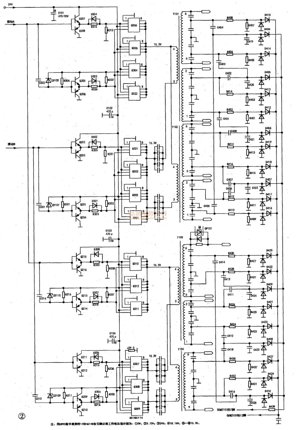

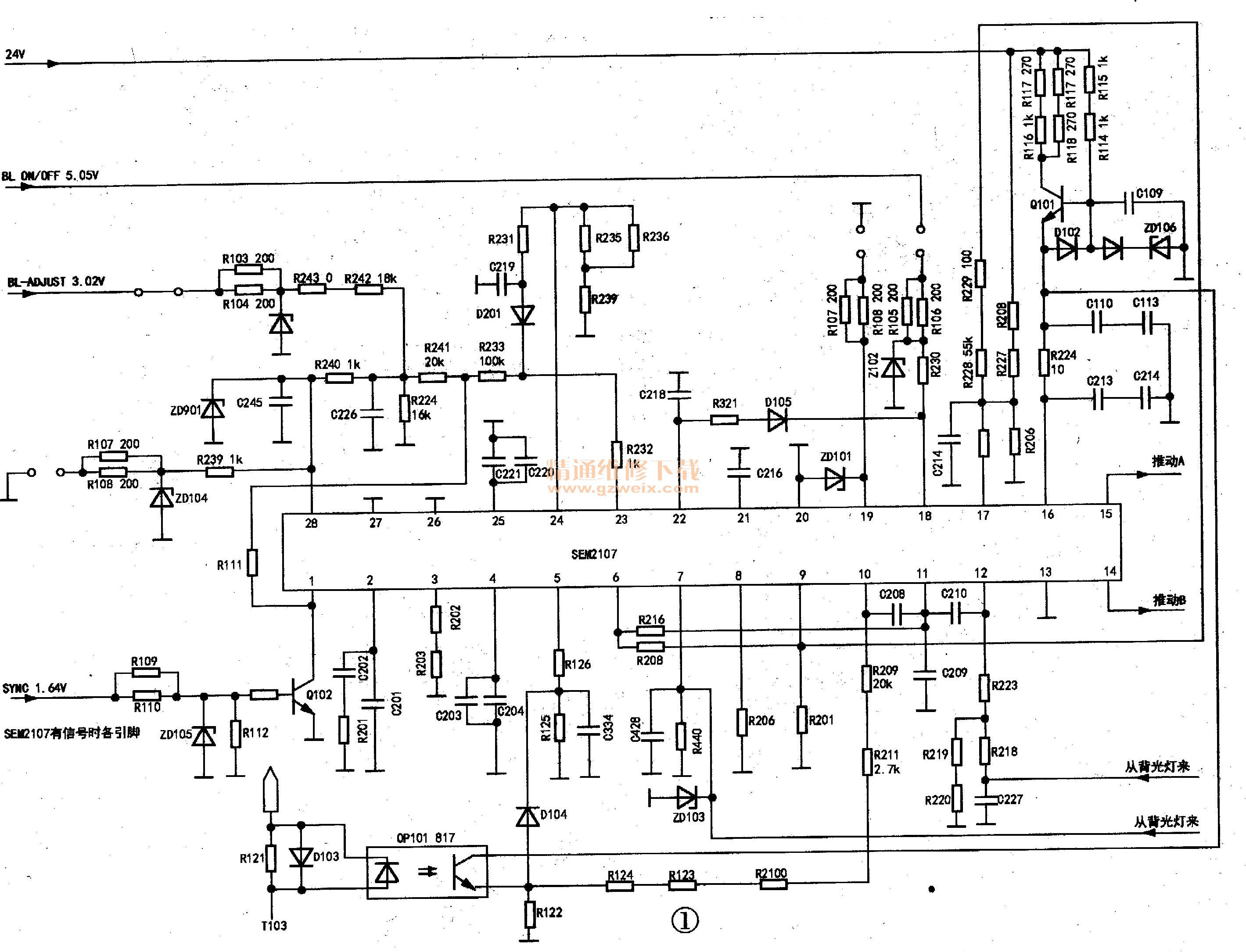

    In the appendix you have a better schematic with SEM2106

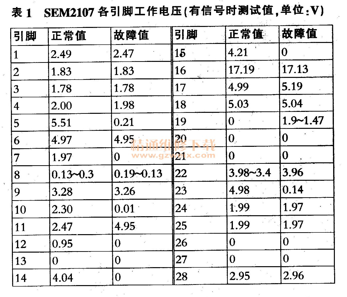

    Inverter voltage 24V OK. The power supply on SEM2107 equals 17V and it is still at this level even though the TV resets. Bypassing the Protect on the SEM does nothing. So what ....?

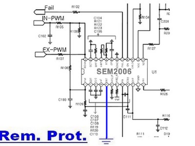

    The method of removing the Protect lock in these ICs must be adapted to the given system, pay attention> they have different numbers of pins ...
    I showed for SEM2106
    Toshiba 40LV685D TV - No Backlight, Replaced STR-A6069, SEM2107, AO4614, Inverter SSI-400-14A01
    For SEM2107 it is SSOP-28 pin housing.!
    View and take measurements on pin "ah, give it up."
    It is important, for example, on a pin. (Vref)
    There is also an output system. on the 4th trafo. with 14 ohm field transistors
    * described on the "Chinese website" Link

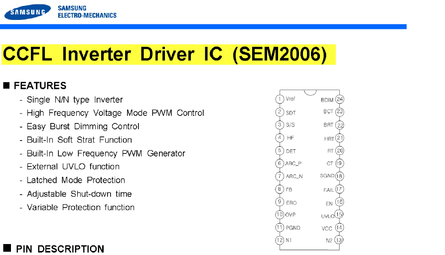

    SEM2107 is equivalent to SEM2106 and has 24 pins !! so the stated voltages are measured on the correct pins.

    Two ver. work of this circuit
    With LEDs for protection
    1. voltage on pin you have approx
    2. role of pin.15 UVLO, what voltage value and compare with datasheet
    3.Vcc usually is 12V, (Tip # 14: VCC: 12.36V) / * (your value + 17V maybe too much)
    see what will happen when you connect the R-150k between pin.14-pin.15
    what then with the voltage on pin.15 (increases)

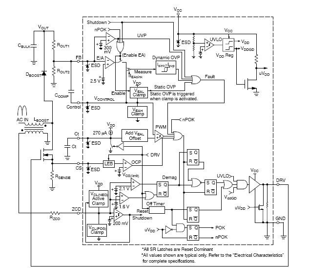

    DPS-219DP
    NCP1607B + 2sk3569
    * SSC9512
    STR-A6069H
    There during work
    POW PROT - 2.92V
    POW SIG - 2.2V
    AC DET - 2.7V
    POW LCD - 3.1V
    Measurement of voltages during operation L6599D, NCP1606B Link
    Toshiba 40LV685D TV - No Backlight, Replaced STR-A6069, SEM2107, AO4614, Inverter SSI-400-14A01 Toshiba 40LV685D TV - No Backlight, Replaced STR-A6069, SEM2107, AO4614, Inverter SSI-400-14A01
    and see v Link
    From the Electrode forum, e.g. Link

    NCP1607B
    SSC9502S
    The Delta company in its dogs is "monothematic", the same IC has almost identical work layouts. NCP1607B / NCP1606B
