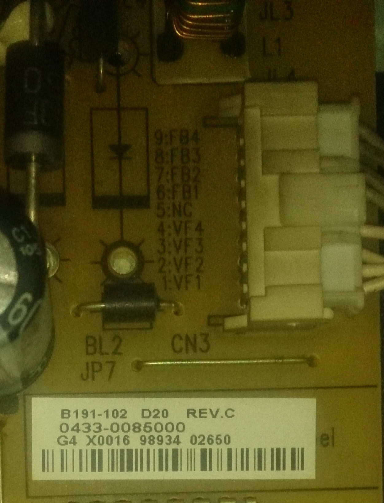

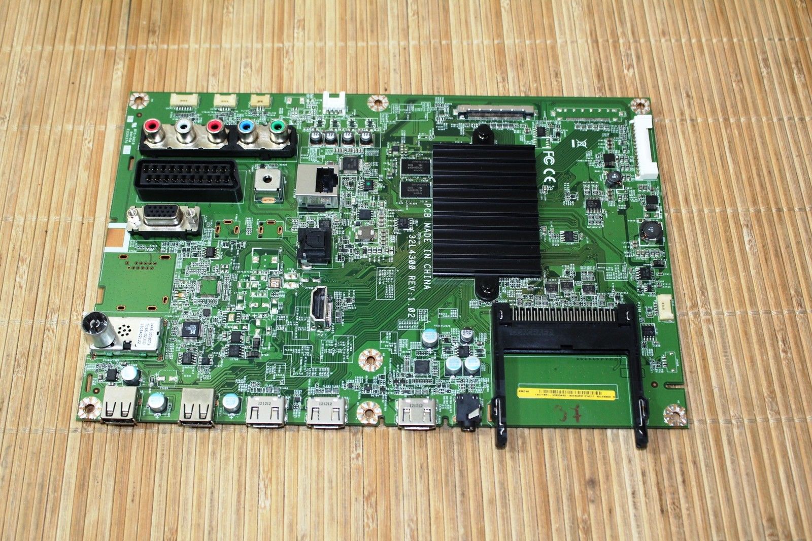

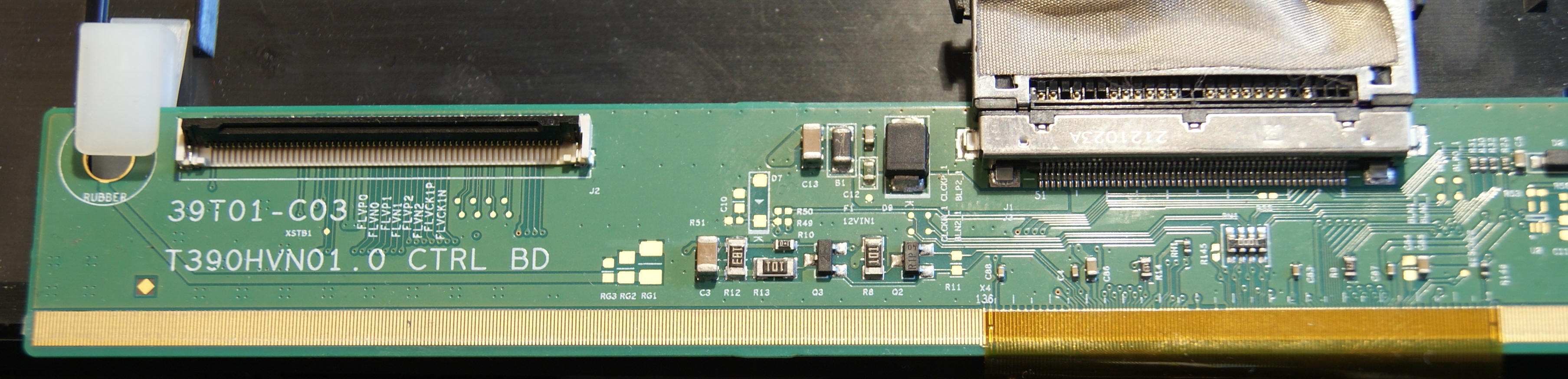

    I am repairing the Toshiba 39L4333 dg, it was in worse condition than I expected.
    Currently, it turns on and off normally, the backlight normally follows the voltage on the CN3 VF1_VF2 81v, F3_VF4 49v, FB1_FB2 43v FB3_FB4 6.1v connector, the main connector is also correct. The matrix changes only the vertical stripes depending on the signal, after connecting the sound is only on HDMI 2.
    I heated the BGA on the main, I check the circuits for which I find schematics, and now I found that the lack of 3.3v on t_con, the second 12v is correct, it looks like the logic has no 3.3v voltage.
    BN91-102 power supply no voltage on T_con TV Toshiba 39L4333 DG
    main 32L4300 rev 1.02A BTC-202A

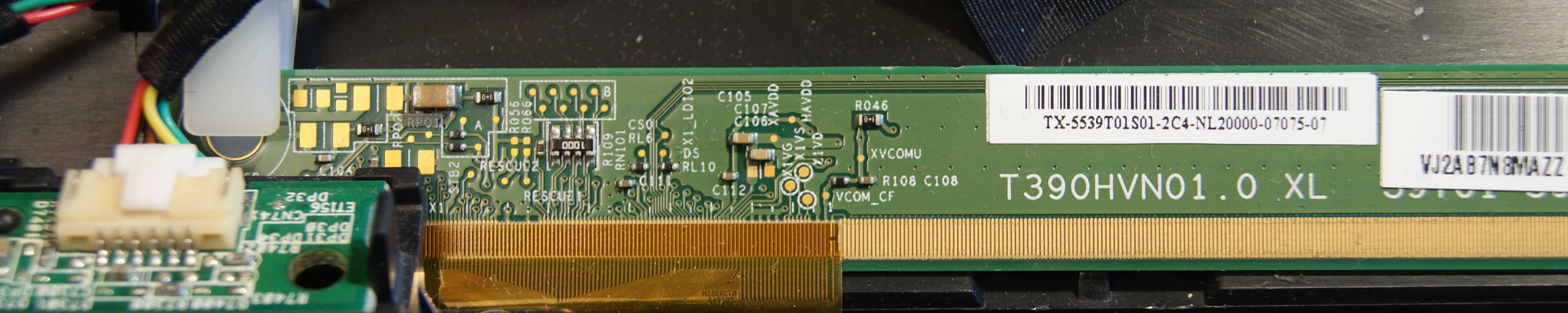

    T_con integrated with AOU matrix T390HVN01 .0
    Opis techn...asheet.pdf (803.69 kB)You must be logged in to download this attachment.
    He is looking for a scheme for the whole.

    On Main (32L4300 Rev1.02A.) They should be
    The IC100 MSD8841CV-W9N * BGA processor costs about $ 160 in China
    sound: IC370 -TAS5708
    HDMI: IC670 - SiI1292CNUC
    TDSS-G231d tuner
    IC760: MSB1233C LQFP48
    SPI FLASH: IC122 25Q16 WINBOND
    SERIAL EEPROM: IC121 24C256

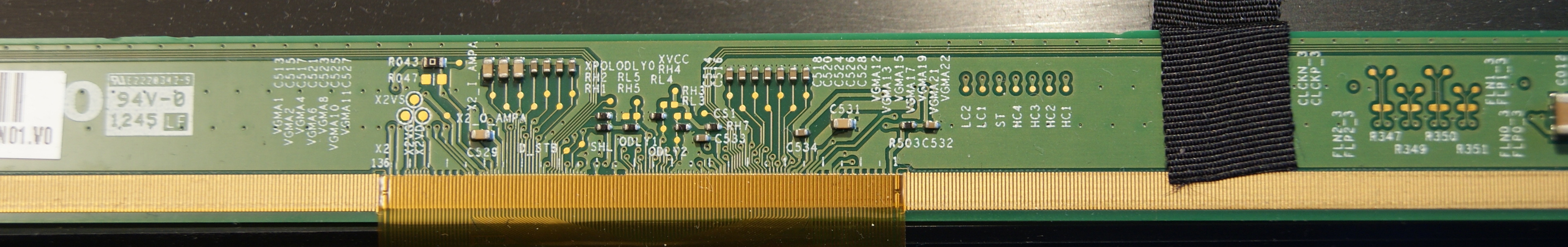

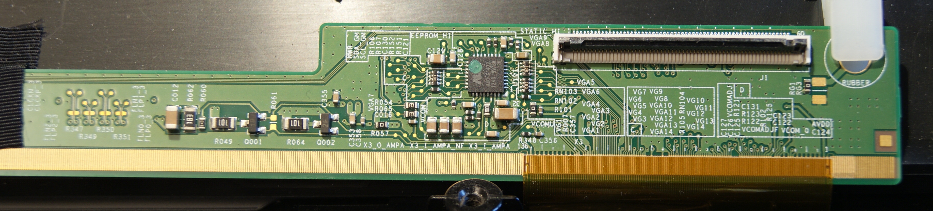

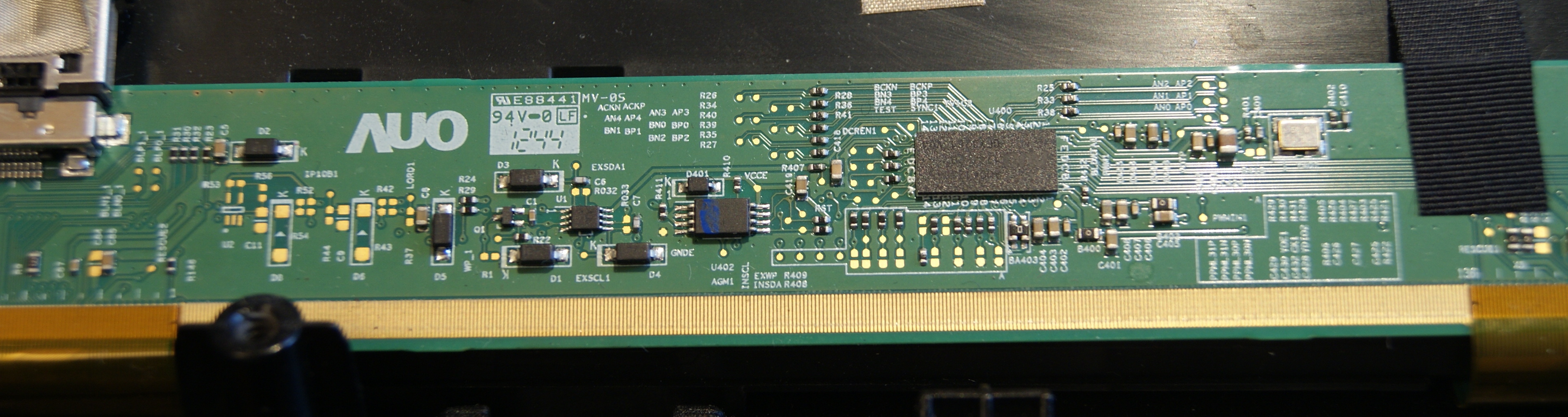

    On this matrix, on the T-con plate, there should be:
    - LVDS AUO M106-11 controller (AUO-12306)
    - AUO P301-40 system
    and he (P301-) with V12IN1 + 12.6V does + 3.3V: V3D3 + 3.3V / * and VGH
    * that's it from a colleague from work
    + 3.3V (pin 13-14-17) .. then, probably, the stabilizer is made for a voltage. power supply of the AUO-12306 controller, values + 1.2V

  • #4 15397287
    ratel
    Posts: 28
    Rate: 24

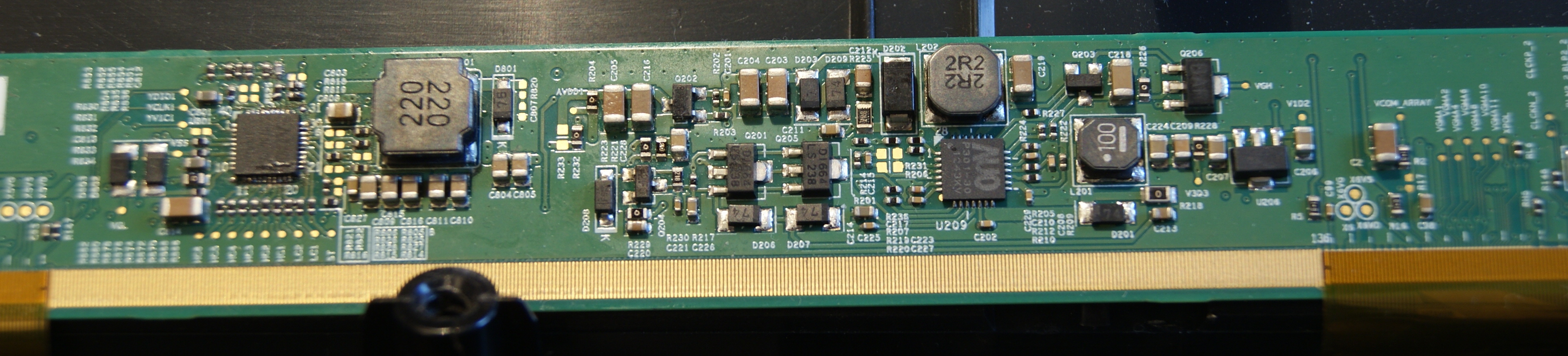

    t_con Everything looks like this for me no voltage on T_con TV Toshiba 39L4333 DG no voltage on T_con TV Toshiba 39L4333 DG no voltage on T_con TV Toshiba 39L4333 DG no voltage on T_con TV Toshiba 39L4333 DG no voltage on T_con TV Toshiba 39L4333 DG no voltage on T_con TV Toshiba 39L4333 DG no voltage on T_con TV Toshiba 39L4333 DG
    I replaced the AUO M106-28 in the QFN housing and the voltage returned on the VSS foot, the matrix responds to the signal, previously it did not respond, but still no image.
    I will check my friend's suggestions at the weekend, but now I think that I am close to the solution, because earlier I blamed Main for the lack of 3.3v voltage.
    With the AUO M106-28 chip
    _ points
    VCCE 2.9V
    VGL 11.2V
    YV1C1 0.4v
    YCLK1 1.9V
    YD101 3.1V
    with the AUO P301-30 system on the 13 * leg 3.2V at 14 * 3.2V and 17 * 1.2V
    _points
    AVDD1 15.2V
    V3D3 3.2V
    VGH 27.7V
    V1D2 1.1V
    VCOM 7V
