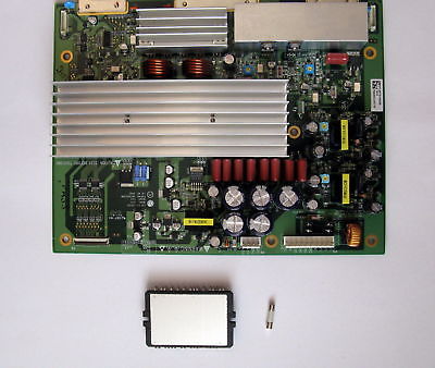

    I greet you with respect.I'm looking for schematic Y SUS code module 6871QYH036D it belongs PDP42V7 LG plasma tv, chassis MF-056.Tensiunile Vs and Va are correct.Simptom: Sound ok, no picture.I found Q101, Q102 and R114 defects ( Q101-Q102-FQP6N70, R114 = 10R / 2W) after their replacement and smd elecltrolytic capacitors (33uF ~ 100uF-220uF) functioned properly 4hours, then returned defect...Thank you in advance!

    It happened to me, and after a lot of research, I definitely found that the panel may have an insulation leakage, so the high voltage occasionally discharges in the electronics and destroys it.
    I think that there's no cure for it, otherwise you can try to replace the plasma panel...

    Thanks for the response, I solved the problem by replacing the module Y SUS.

    hi , on your y sus just replace ipm chip.
