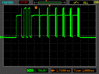

    Sample Mileage Y_out 100V / div

    You have low Vzb (from X_sus), this is how it results from your measurements.
    Read the LG 50PJ350 training manual (also on elektrotanya.com) what and how to do in this case.
    If you write PSU, you are ok, that is
    - on the PFC IC (R2A20117) you have a stable 390V
    - the primary power supply on the IC801 L6599AD produces Vs / Va
    - Infineon 3BR1565JF is energizing
    - Vs / Va voltage controler on IC F4316MSF17 (i.e. MC81F4316M) works
    LG 50PK350 PD01A TV: No Picture, Remote Control Missing, Voltage Issues, and Troubleshooting Steps
    you have damage:
    -or in X / sometimes it attracted Y-sus (mainly field IGBT)
    -Logic
    You can check the scans (alternately disconnecting ... the bottom / top image should appear)
    CHECK before on ohms (described in the manual)
