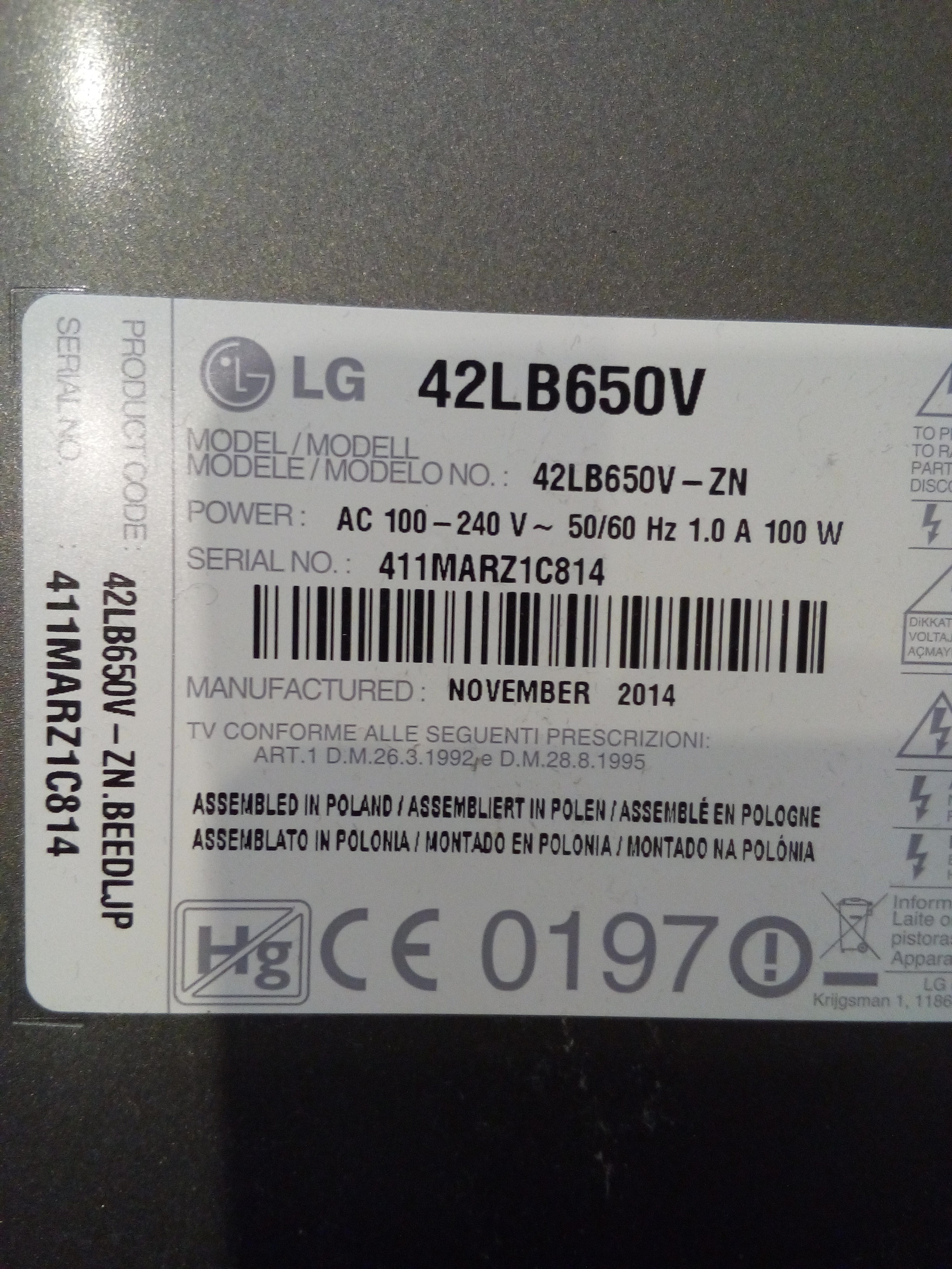

    And such a sticker is on the metal matrix housing with the mark. LG 42LB650V - Black Screen, Audio Issue: No Backlight, Power Supply Board Replacement

    One more number I found on the housing is: MCR65227506
    • LG 42LB650V - Black Screen, Audio Issue: No Backlight, Power Supply Board Replacement 15234671078472082394921.jpg (2.74 MB) You must be logged in to download this attachment.

    Your TV model is LG 42LB650V. So correct the title first. And the matrix model is inside I showed a photo.

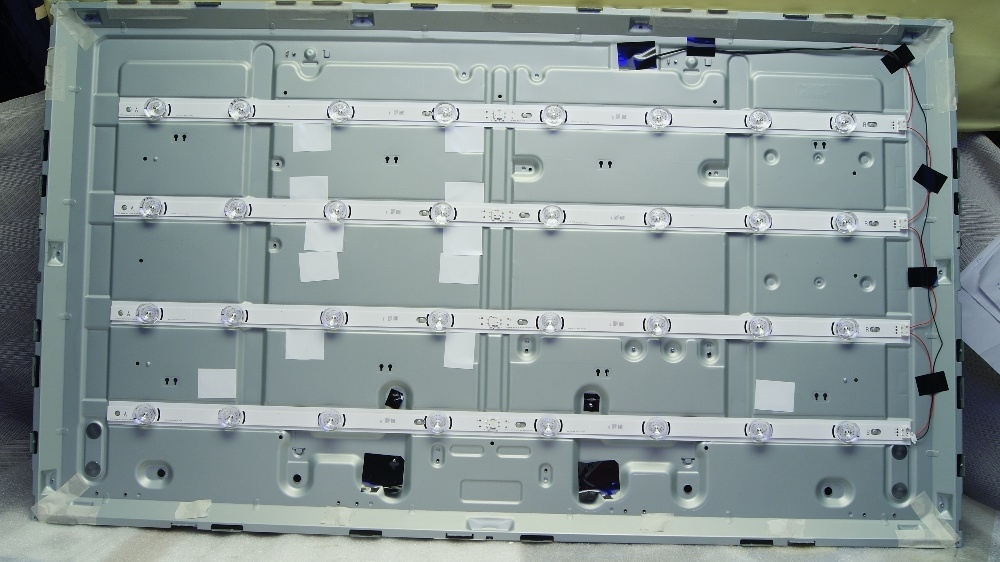

    Somewhere you have a burnt LED on the backlight bars. I would advise you to hand over the TV to the RTV point. I don't know if you can disassemble the matrix and break it down, not a problem to get to the lighting strip.

    Thank you for your help. The last question, what could be the cost of replacing such a strip on the site? Indicatively

    And this is how these strips look after stripping the matrix. LG 42LB650V - Black Screen, Audio Issue: No Backlight, Power Supply Board Replacement Each website counts differently is difficult to say?
