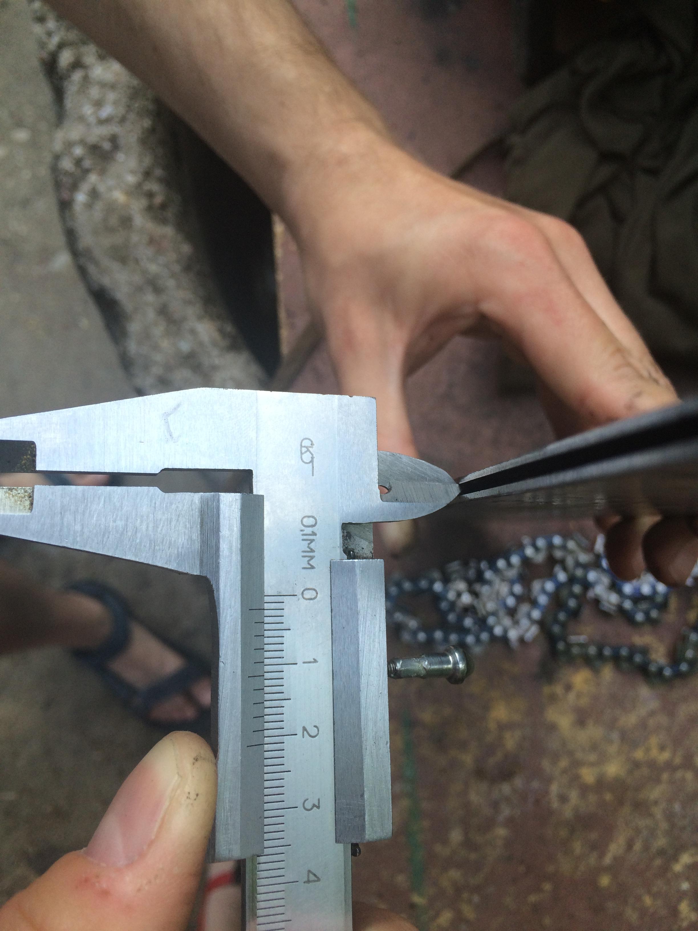

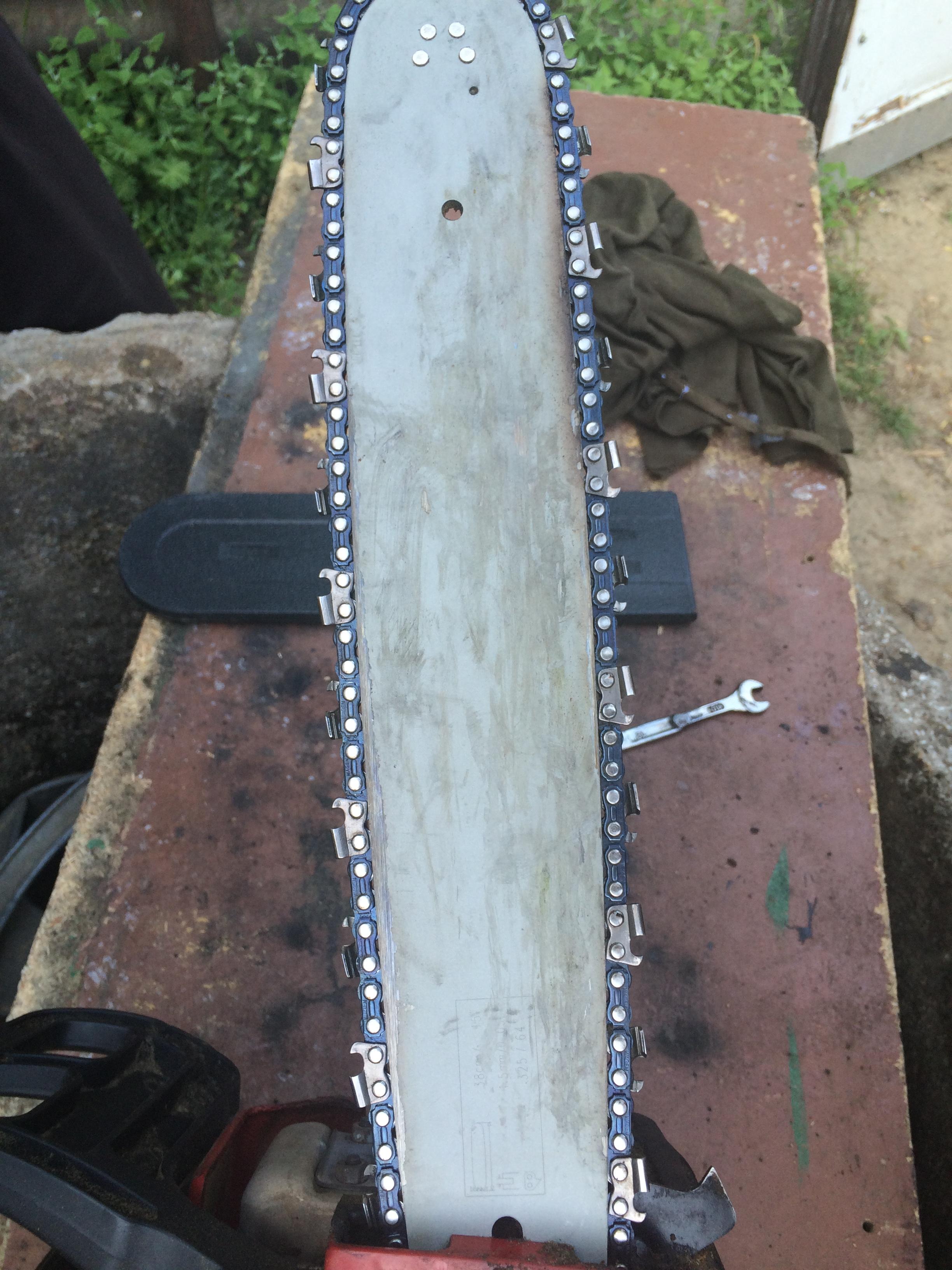

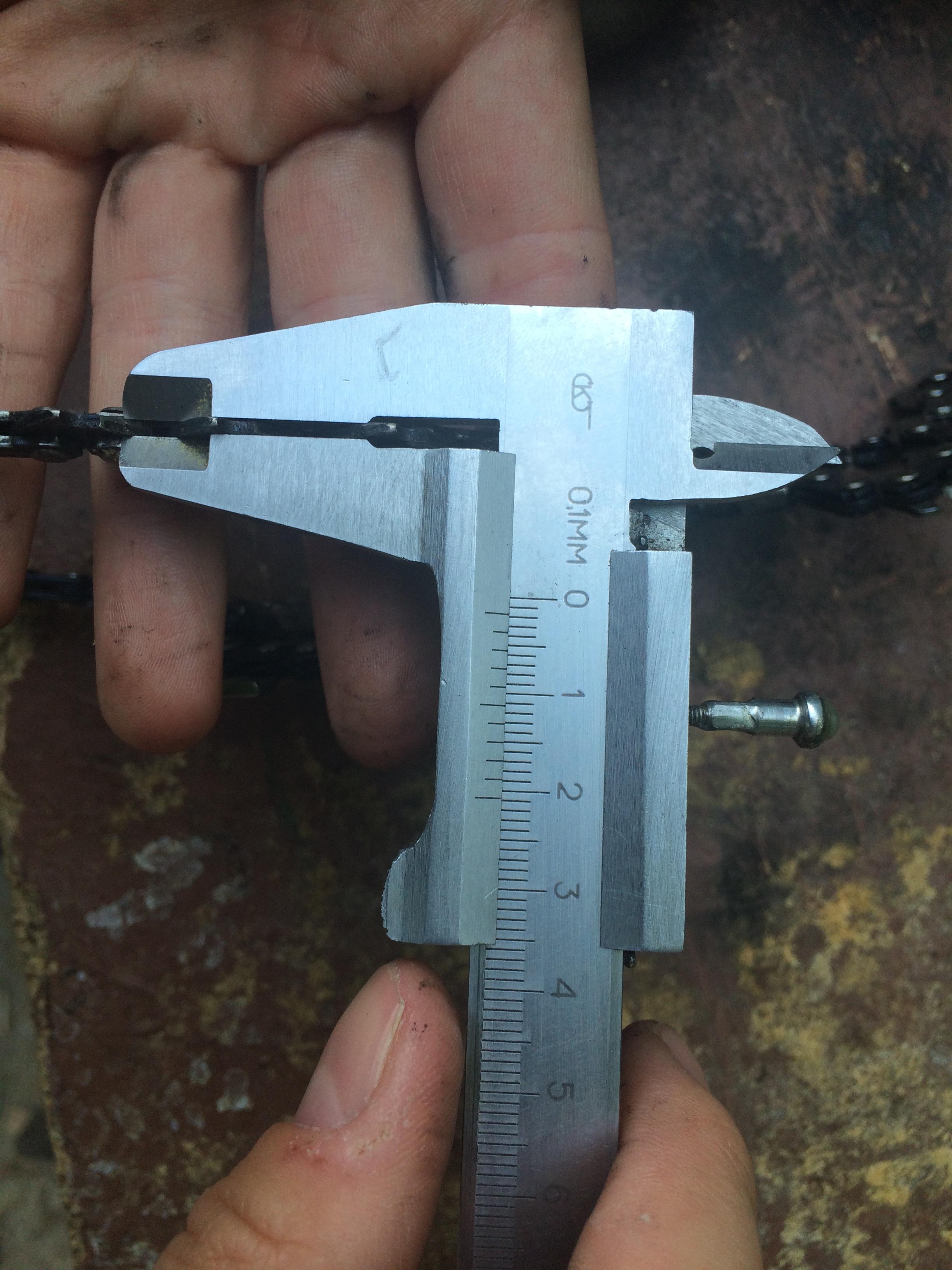

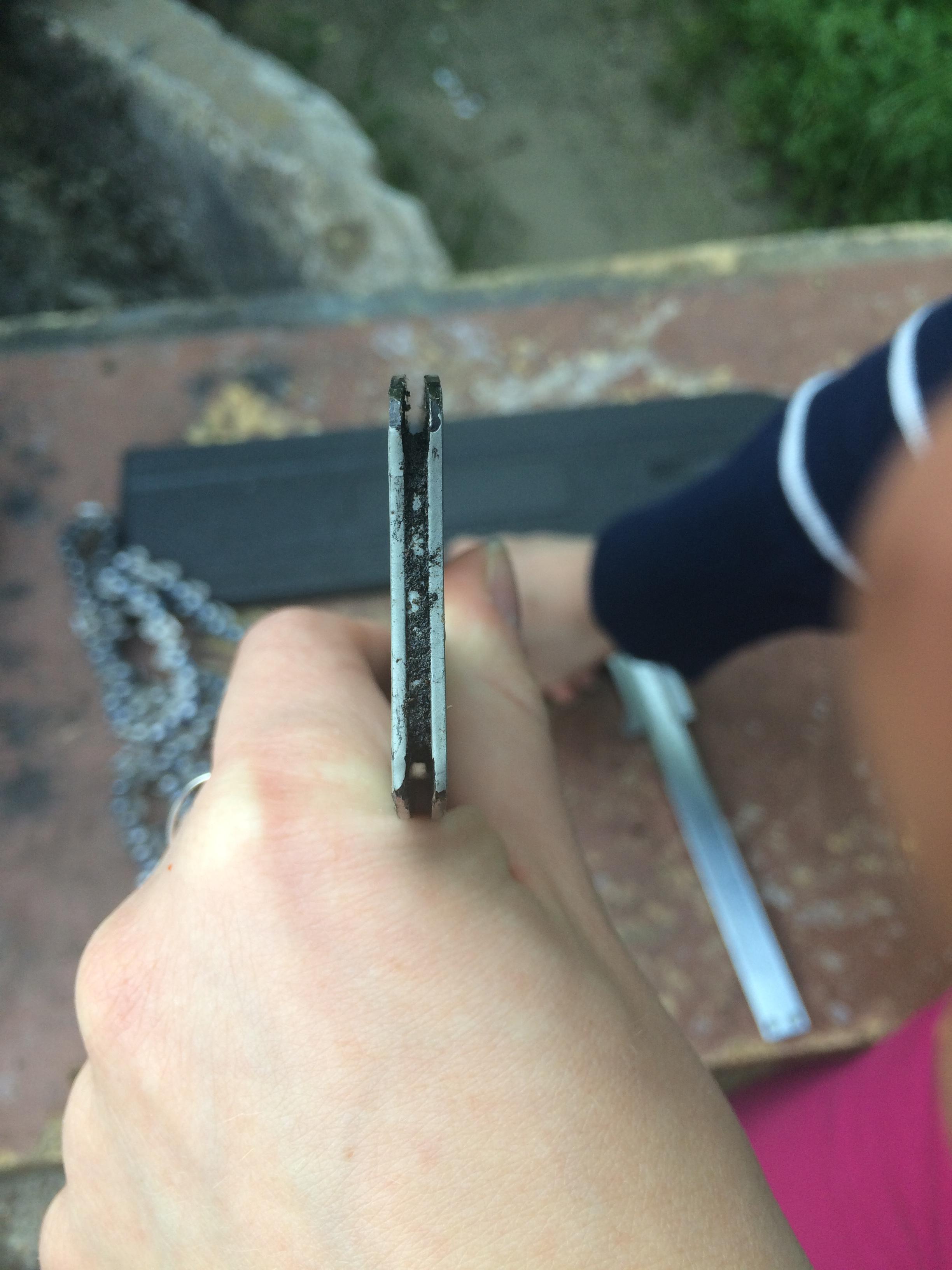

    Apelek wrote:
    What is this caused, what could be done?
    Most likely it was a bad sharpening of the previous chain which was also pulling and thus making the guide grooves in the bar. The new chain may not be sharpened too well (there are such cases), which in combination with a well-made guide gives this effect.
    With the guide, if it is already "worked out", you will do nothing, only replace it with a new one.
    It is very important to sharpen the chain correctly.
    The most common cause of such a "sausage cut" is incorrect sharpening of the chain. The teeth on one side of the chain are more "sawn" and therefore slightly shorter and everything is malfunctioning. This happens most often during manual sharpening with a file because each of us has the preferences of "right-handed" or "left-handed" and when sharpening, always when sawing with a file on the side that is us, as they say "on the hand", there is a stronger pressure on the file when sharpening, at least we try not to do it, because it is more convenient, handy and easier to work according to your "preferences". although we do not want it, it comes out automatically and these are the consequences and the drawbacks of the chain ... :D
    A mechanical sharpener is a good method, but there you have to be even more careful not to "sharpen" the chain and not "overdo it".
    The chain should not be too tight either, it must have a little slack ...

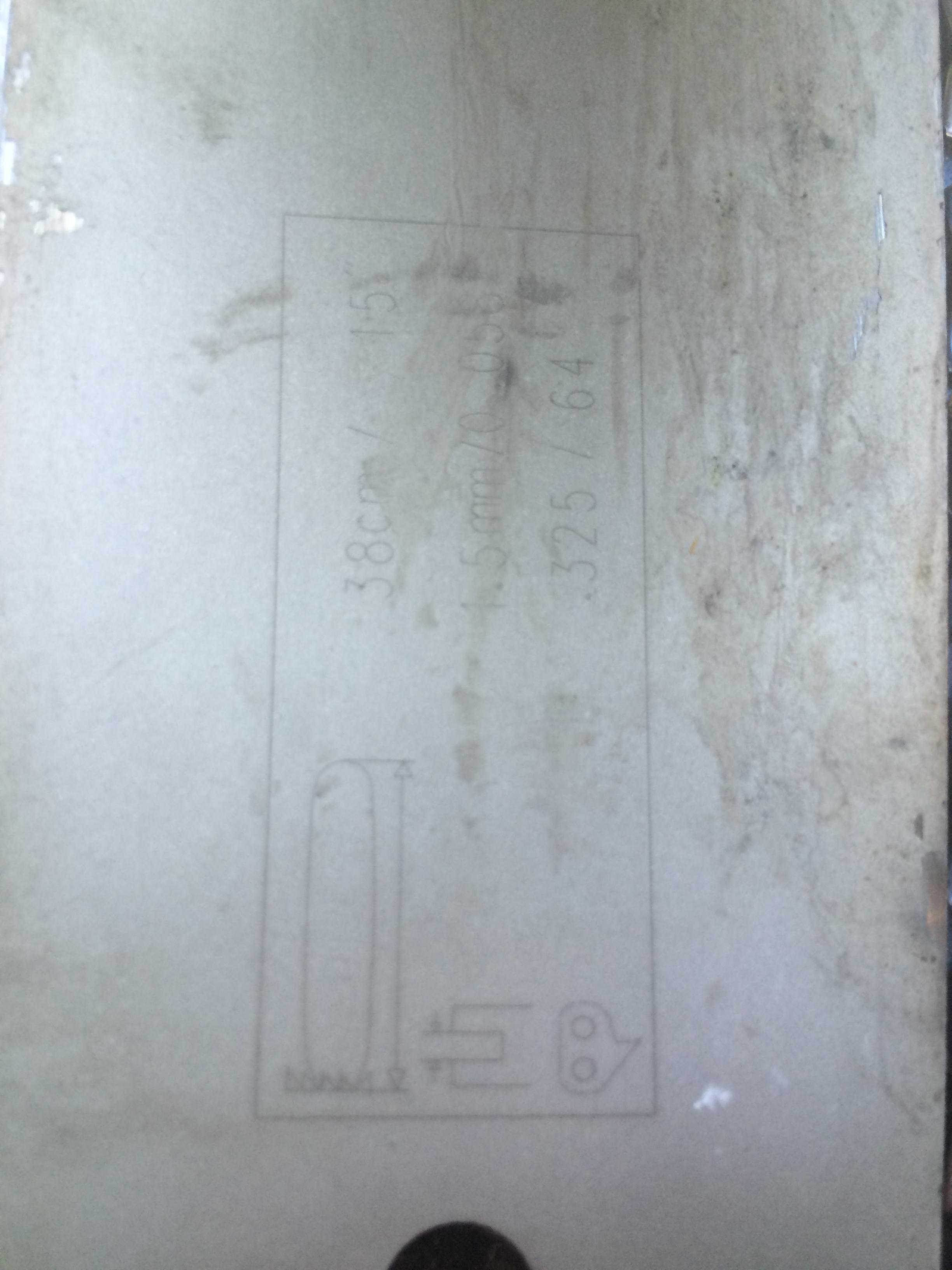

    Measurement results in the attachments.
    While cutting, I noticed the chain popping off the lower guide. And the lubrication pump probably does not work, because the guide is dry all the time.
