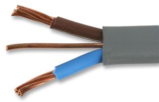

    A distribution box in the attic is not a desirable solution. If I can connect the two cables in the attic box without additional protection, then so be it. This thicker cable (6mm²) looks like this:
    Managing Connection of YDYp 6mm2 Wire and 3x2.5mm² Cable: Fuse Adjustments & Protection
    Seven wires in the conductor, each about 1mm in diameter. Do I need to press a tip on this? So far they have simply been screwed into the connection block.
    Both cables: 6mm² and 2.5mm² are already installed and I would prefer to avoid running additional istalations. The ideal solution for me would be to install an additional switchboard in the garage in case it is to be used by someone other than the householder (I ignore the cost of electricity consumption). Can I therefore do as follows: I connect a 6mm² cable to the B16 fuse in the main switchboard (protected by an RCD), further connect it in a box with a 2.5mm² cable and further in the garage install another switchboard?

    Madżik wrote:
    I connect it in the box with a 2.5mm cable² and further in the garage I install another switchgear?
    For the cable should be unquestionably pressed end.
    When it comes to powering the switchgear from a 2.5mm cable:
    Check in the table what is the permissible long-term load of your cable and such overcurrent protection should be installed to avoid tragedy.
    Greetings.
