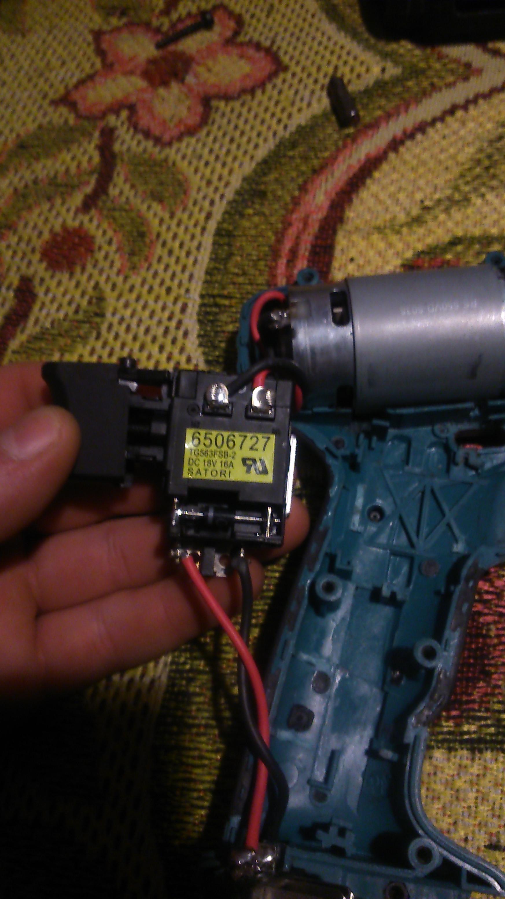

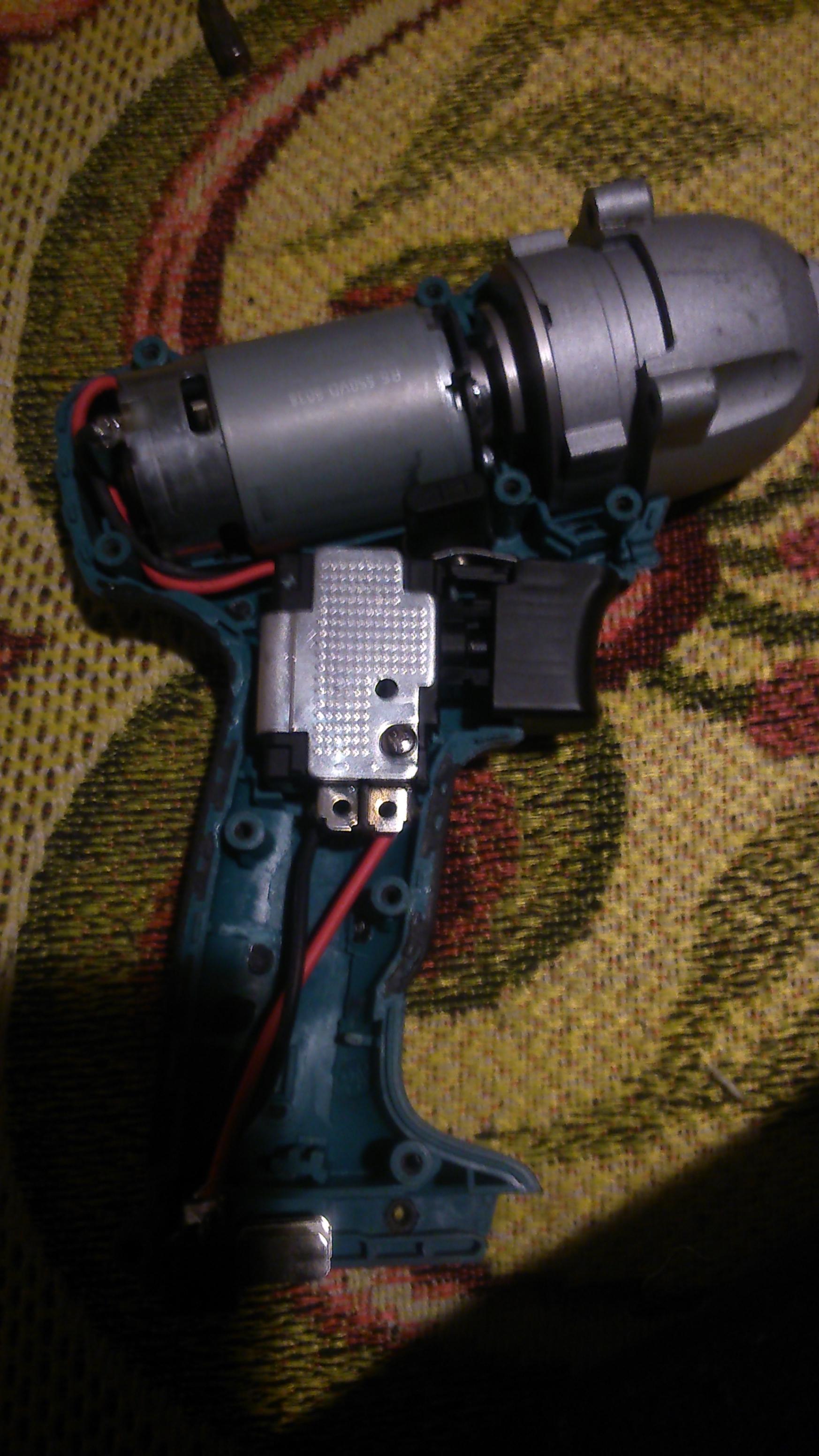

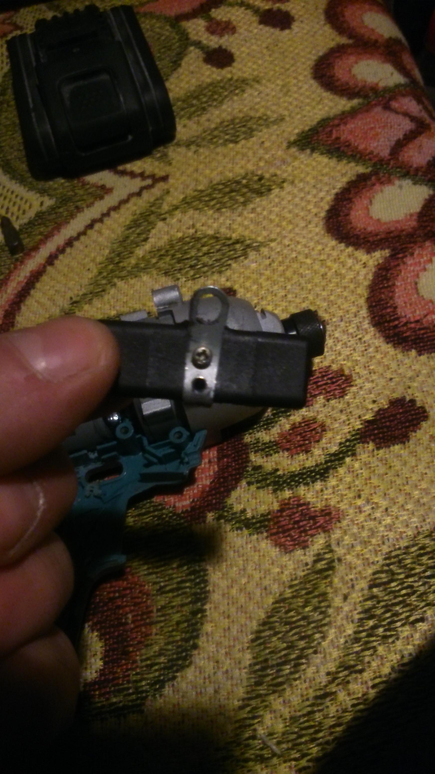

    Below are some photos from my Makita switch installation.
    In order to be able to fit a new switch, you need to make some space. I used nail file cutters and drills for this.
    I removed the unnecessary material so that the casing with the new switch came off perfectly.
    The switch sits rigidly. Works perfectly. I recommend this treatment to everyone.

    I have a question for you busiel323: Tell me if you have this switch also has a crack at the bottom with the push-button switch. Because I see colleague banshee used switch 6506044 and you 6506727, because this valid switch can also be found in a small hammer drill WORX H3 professional, and as you know the equipment works in dust and I would like to minimize the collection of dust inside the housing.
    Mr banshee: What did this left / right rotation switch glue? I look and come and I can not do it either glue or some kind of "welding" of plastic.
    I will add from myself that this switch was available as I searched the portals 2 weeks ago in Chinese on Aliexpress with some other electronics for over $ 20, but I rather do not see the point of re-assembling this faulty Jiaben DLK-2036R. In my case, he did not get a lot of work, the equipment very little used, the warranty passed and, secondly, equipment purchased in the west, because we are not very popular company.
    #24 16888471
    banshee
    Posts: 21
    Rate: 9
    I made the rotation switch with a soldering iron and a piece of extra plastic. At the end I made a hole for the end of the switch to fit.
    The trigger switch itself is smaller in size, but it does not bother me to loosen the screws.
