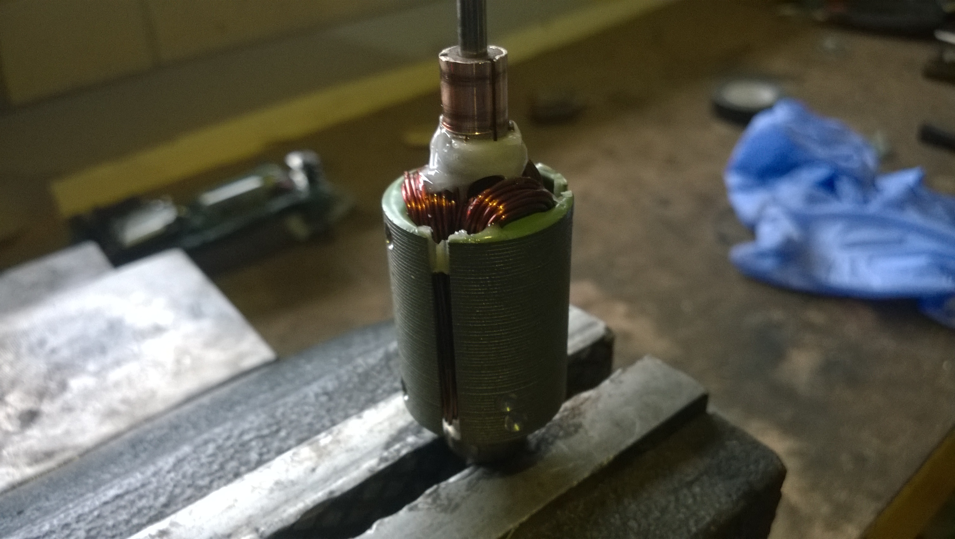

    Hello, I bought an Erbauer 18 V screwdriver as a new one, which took me 2 days to cheer up and the engine gave off smoke. Burned rotor diagnosis. In my search, I supported the Asian side where I bought a motor with the same dimensions for 18 V screwdrivers. The only thing I had to replace was the rack at the end of the rotor because although it had the same number of teeth, the diameter was about 1 mm larger. I managed to replace it, although it was not that easy because everything was delicate and small. Well, after connecting, the engine does not always start, i.e. it starts but only from selected places, if it does not want to start, I have to turn it by hand and it always does not start from the same places , changing the direction of rotation does not matter. There is more than 18 V on the terminals after pressing the button. What to do with it?

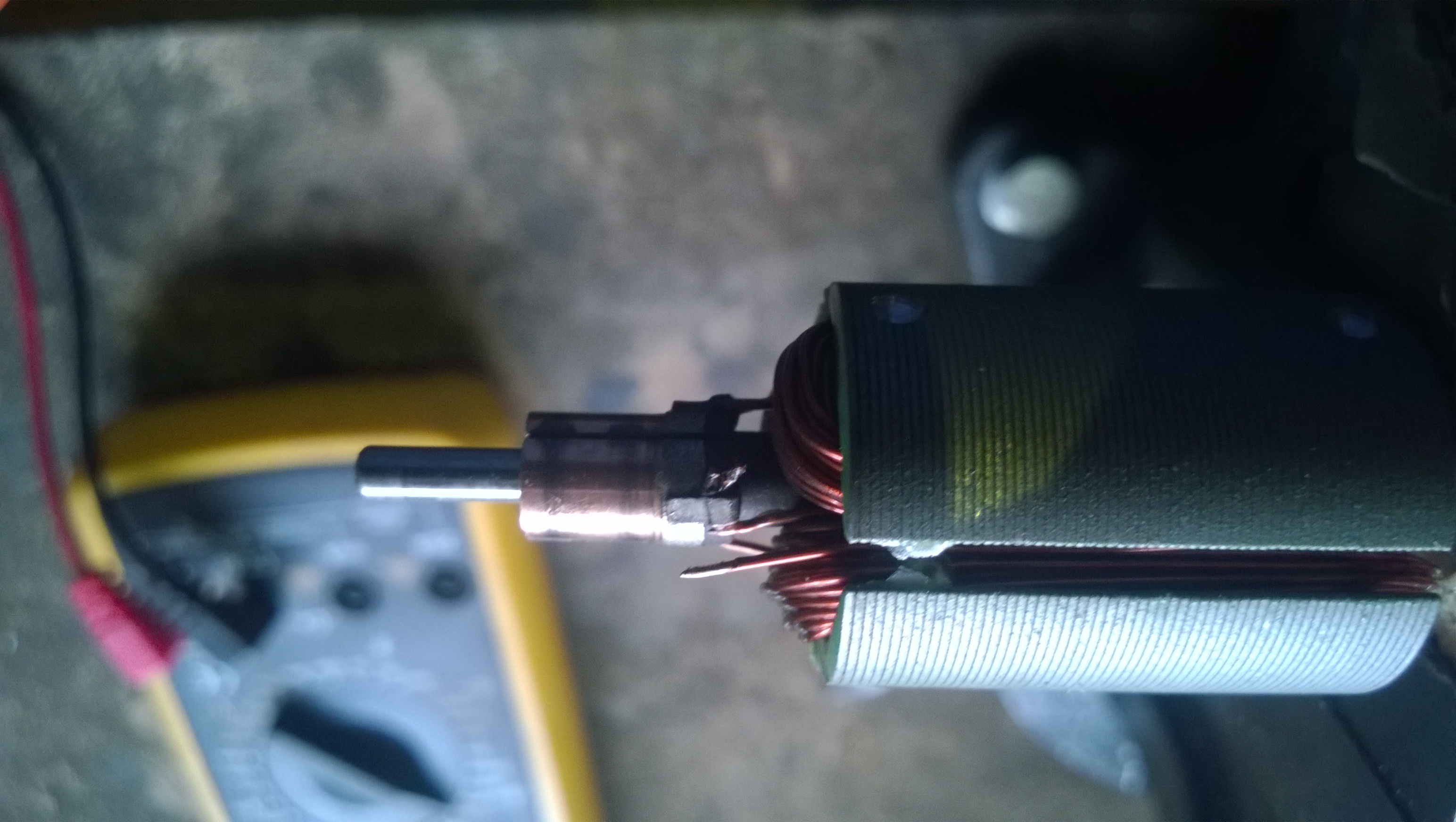

    You just have a break in the rotor winding.
    You can dismantle the motor and check if the winding wires are correctly pressed into individual commutator plots.

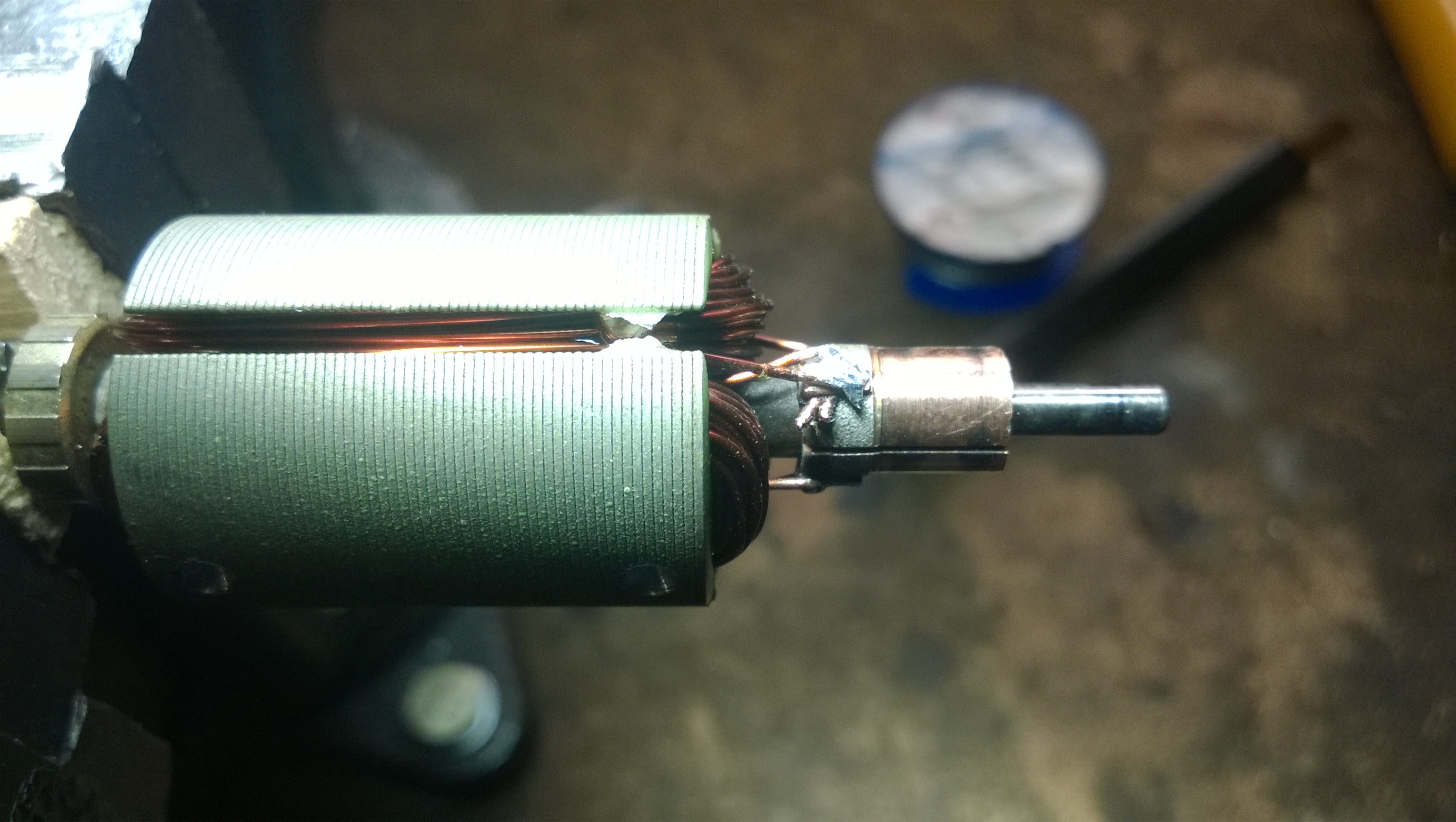

    I was able to fix the engine, I am grateful to a colleague above to direct the case. Despite the advice of a motor specialist, I opened this engine out of curiosity, disassembly was quite simple, simpler than the original because nothing had to be broken, diagnosis lack of continuity on one winding and more precisely no connection of wires to one section of the commutator, I was able to solder and glue it epoxy so that it doesn't spread. I have assembled everything exactly and now the engine is working ok. It is already mounted and the screwdriver is running, I wonder how long it will last. I will have a second engine in stock or if someone needs it, I could sell it. Thanks for the help.

    And seriously this is a commutator motor, not a squirrel cage motor (so he was right) ;)
    Screwdriver motors are increasingly appearing in screwdrivers but for now only on more expensive models.
    With this epoxy glue and exactly the amount I would consider for two reasons:
    The first is impeller imbalance (applies to high speed operation).
    The second is the temperature to which the commutator can warm up when working with heavy loads.

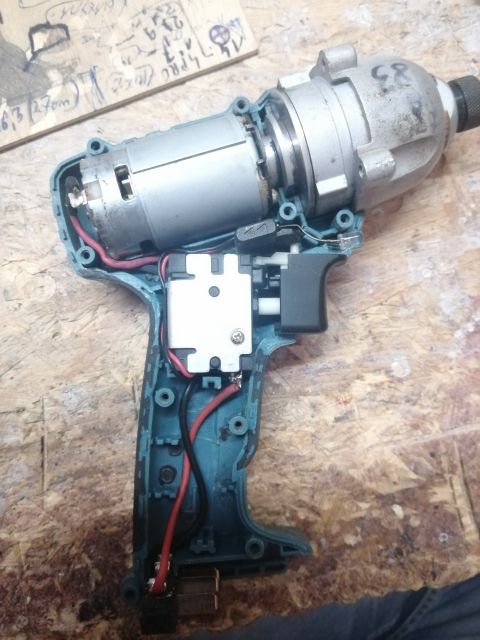

    Two months ago I bought an Erbauer 18 V 2x 4.0 Ah drill and screwdriver. After a few uses, the fur broke. It jumps, rattles and can't be unscrewed or twisted. Anyone else had such a case?
    I took it to a warranty repair, sent it to the service, it came back after a week with the same damage and still all tied up with some grease. Massacre. Today I sent it to the site again and I'm curious if they will do something about it. In general, the equipment looks solid at first glance, but I will not buy such a mess for the second time. Better to pay extra and buy something decent. By the way, PLN 650 is a lot for a screwdriver that breaks down after a few uses.
  • #10 18893444
    budro2
    Posts: 58
    Rate: 52
    You probably bought the screwdriver at Ciastorama and it is a new type of EXT. You did not specify the type because it can be brush or brushless. In brushless brushes that are stronger, the first gear falls quickly because the metal ring of the gear engages with the plastic splines of the body. The electronics are lousy and also break down frequently, and moreover, they are sunken and impossible to rummage in. In the brush, you can put a universal switch or motor replacement. Fur damage is rare and you must be unlucky. There are many defective Erbauer EXT screwdrivers on Allegro, brushless ones that are dead (electronics) and those that pass in first gear.

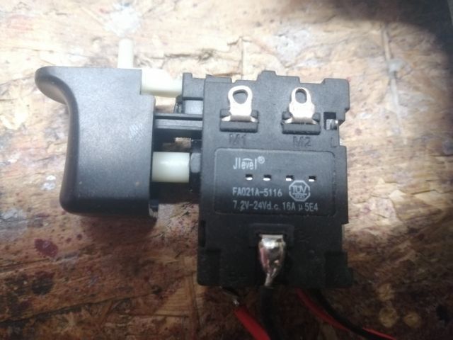

  • #11 18896129
    baranek110
    Posts: 17
    Rate: 11
    Could you give this universal switch replacement?

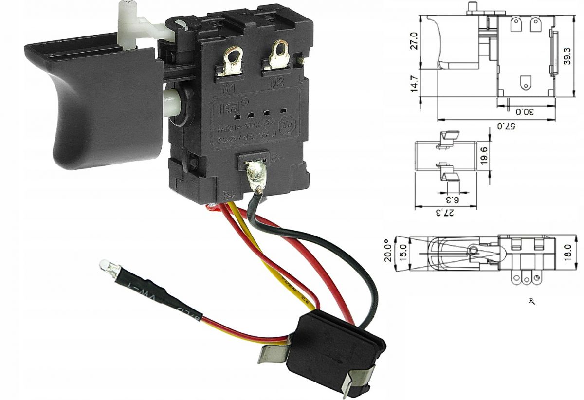

    budro2 wrote:
    It can be with a led: ...
    However, it takes a little work to get the Dremel in. You can also try to replace the key so that the replacement is not visible outside.
    Erbauer 18 V screwdriver- Works once, sometimes does not (interesting, video)
    Switch from Allegro. Little modifications and works perfect. Even better RPM control than the original. I recommend :)
    https://allegro.pl/oferta/wylacznik-wlacznik-...DM2MTc3MjNmOTUyMGQyMDg5ODU0NmQ1Y2QyMGRiMDQ%3D

    The switch as above fits many 12-18V tools with brush motors: Erbauer, Titan, JCB, Guild, Einhell, Worx, Ryobi, Macallister, Blackdecker. Some Einhella even fit the dimensions.
