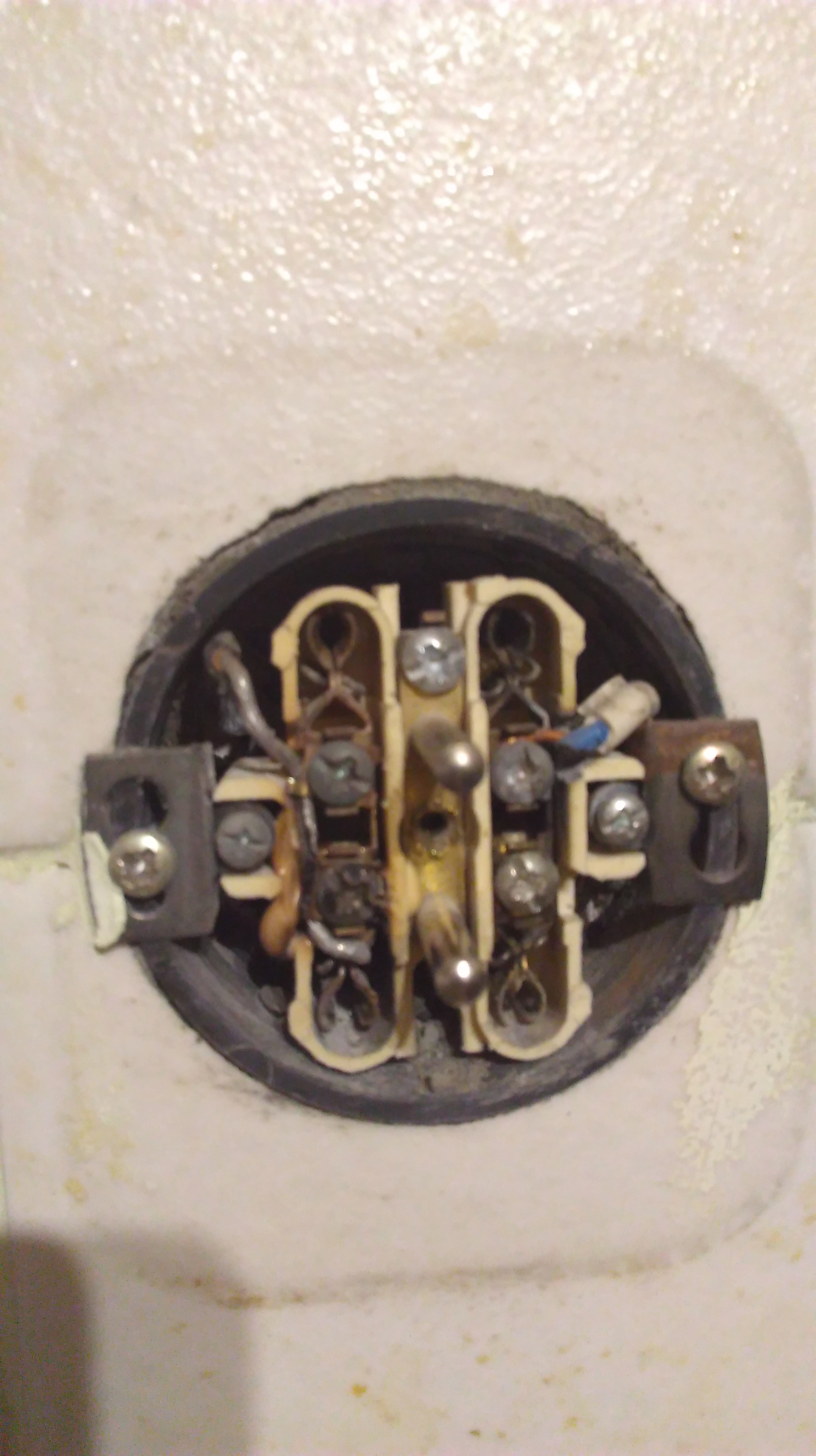

    The middle one is empty. Damage somewhere between the fuse and the sockets. You would have to check each one in turn where it does not pass.

    RAJZON wrote:
    There is no wire at the bottom of the middle one
    But the right one is hot, you can see discoloration of the fuse base contact, the same is true for the right contact of the receiving socket.
    And what is on the PEN - N connector, we do not see it.
    In addition, these new fuses are exaggerated even for copper
  • #33 15789377
    RAJZON
    Posts: 22
    Rate: 25

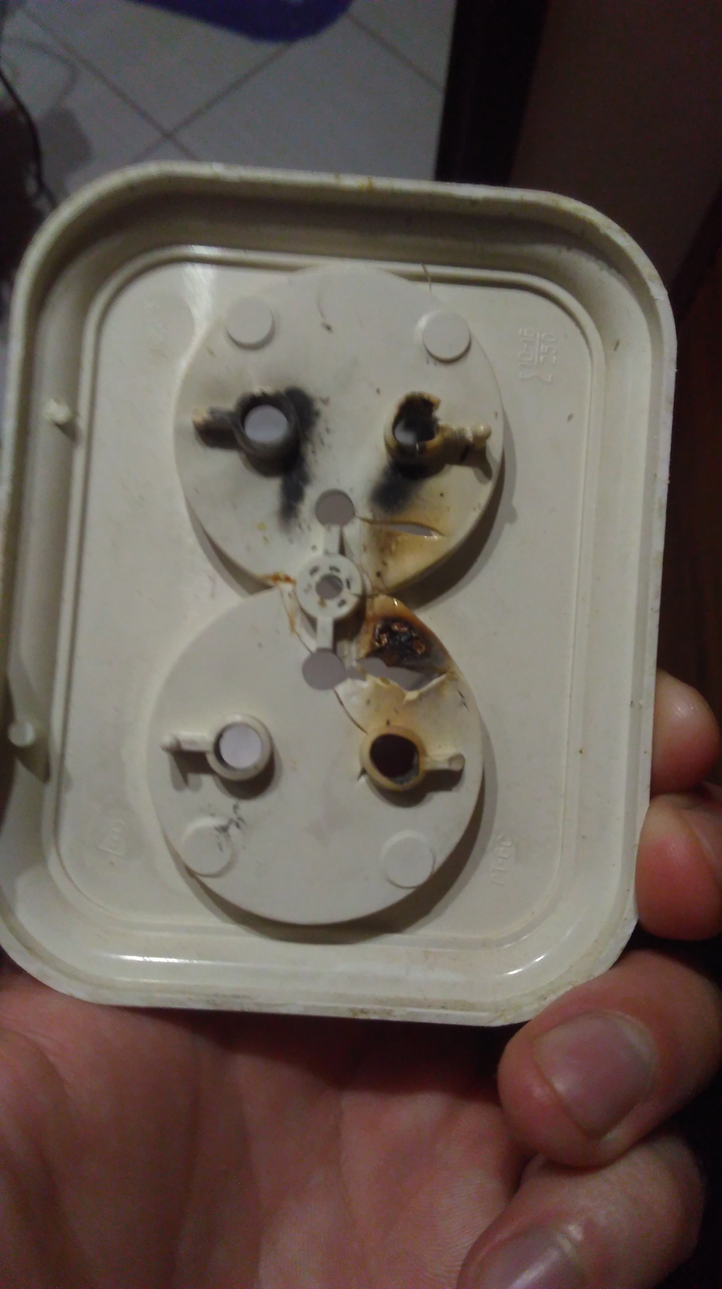

    I think I found it. What's next?

  • #34 15789394
    piotrek22101
    Posts: 3323
    Help: 695
    Rate: 1417
    It sparkled until it was burnt.

  • #43 15791506
    RAJZON
    Posts: 22
    Rate: 25
    There was an electrician. There were burned wires in the box, He made these wires, he also replaced the burned socket and took PLN 140. Best regards. To close.
