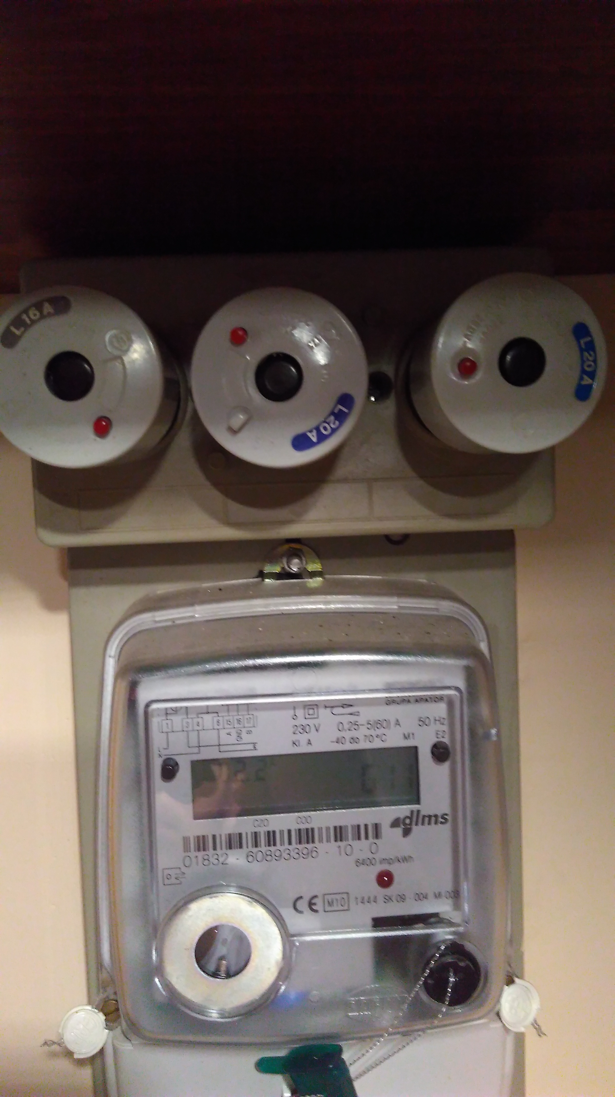

  • #6 15789017
    RAJZON
    Posts: 22
    Rate: 25
    Please, this is how it looks
    Look for an information board in the staircase, there should be a phone number for the electrician on duty.
    I bet the neighbors on the neighboring floors are also without power
    RAJZON wrote:
    Pre-meter protection? On the cage? I don't have the key to her.
    And with fuses you exaggerated 16A, 20A, 20A,
    It doesn't protect you, and it leads you into trouble.

  • #12 15789097
    jdubowski
    Tube devices specialist
    Posts: 21595
    Help: 2511
    Rate: 2798
    A single-phase meter, if the pre-meter protection "went out" you would have no electricity at all.
    With the amperage of these screwdriver switches you bent over, the only thing you can do is swap these "fuses" with each other, and maybe one is damaged.
    If it doesn't help, get an electrician ...

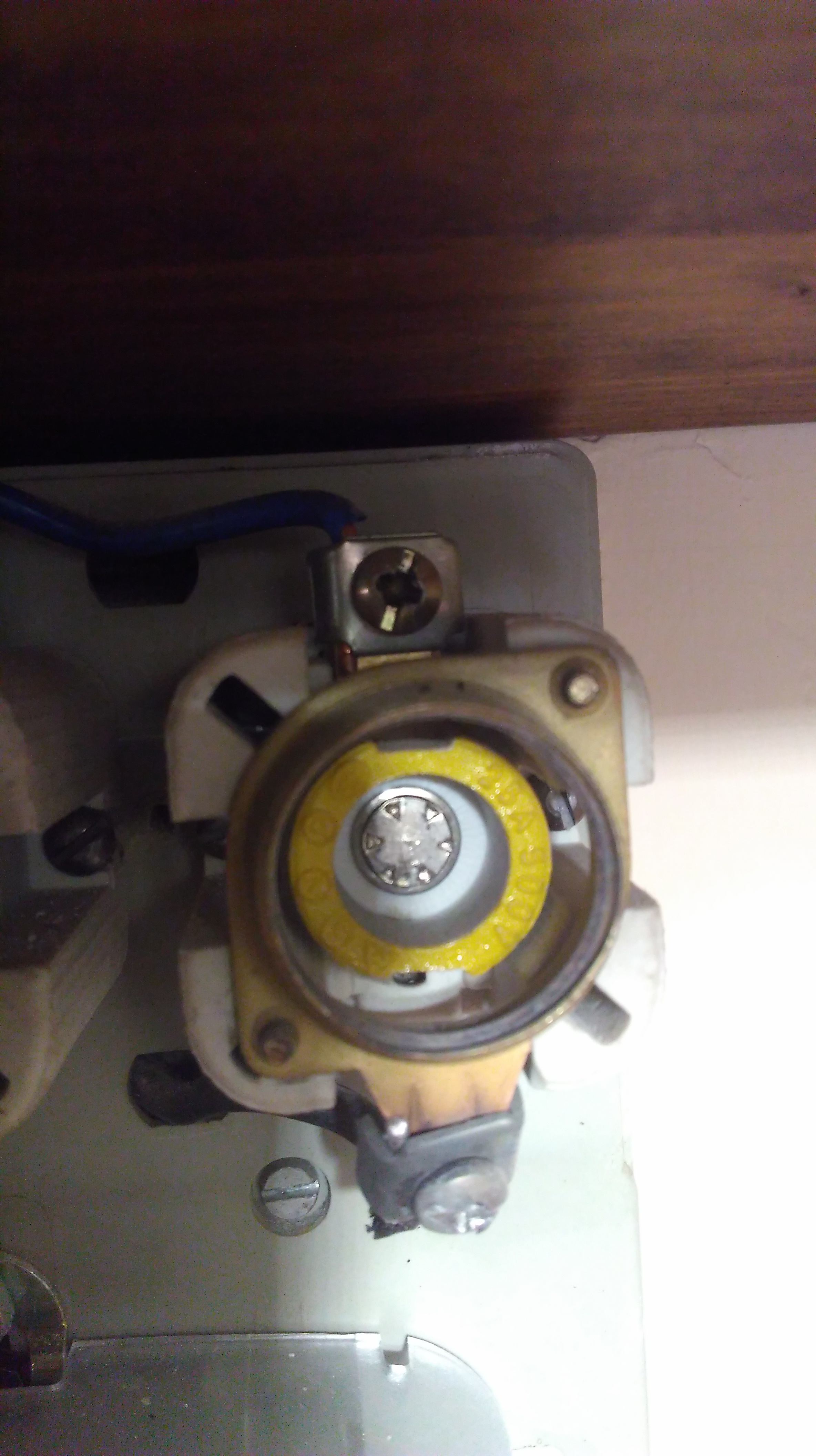

    #14 15789173
    elpapiotr
    Electrician specialist
    Posts: 12201
    Help: 1015
    Rate: 3524
    The failure is not in this socket - you can see that it's a "loop" installation, from socket to socket. Probable fault location - the seat of the board screw switch - no contact on the foot of this "fuse".
    It is also possible that there is no contact on the socket on the bent plate of the socket base (right contact).

  • #19 15789246
    RAJZON
    Posts: 22
    Rate: 25
    This is it?
    • No Electricity in Sockets After Fuse Reset: Iron Plug Incident, DIY Fixes, and Safety Checks 1467748267891-1363489989.jpg (2.1 MB) You must be logged in to download this attachment.
  • #20 15789250
    piotrek22101
    Posts: 3323
    Help: 695
    Rate: 1417
    Yes. On the one hand they go from the cage, on the other they go to sockets, lights, etc. At the bottom of the middle one, I can't see the wire.

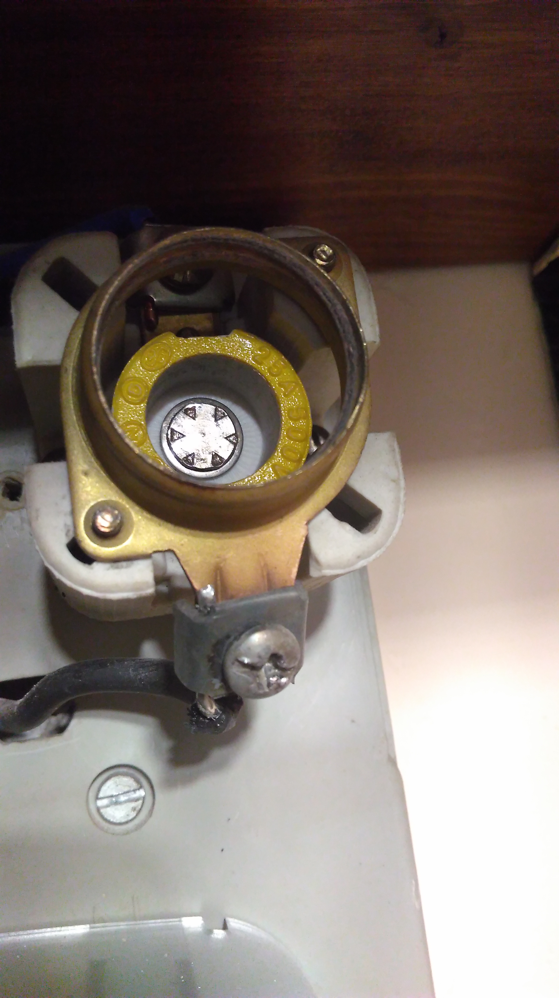

  • #21 15789263
    RAJZON
    Posts: 22
    Rate: 25
    The one from the sockets sticks out strangely, I live in Warsaw and I am wondering whether I should call an electrician but it will probably wipe my money at this time

    #22 15789280
    snakess
    Posts: 52
    Help: 10
    Rate: 13
    Check that the test lamp illuminates the screws (top)
    #23 15789297
    strfind
    Posts: 589
    Help: 25
    Rate: 82
    Take the voltage tester, screw in the fuse and put it at the bottom of this clamp, you will know if it is not conductive by the fuse or other miracles.

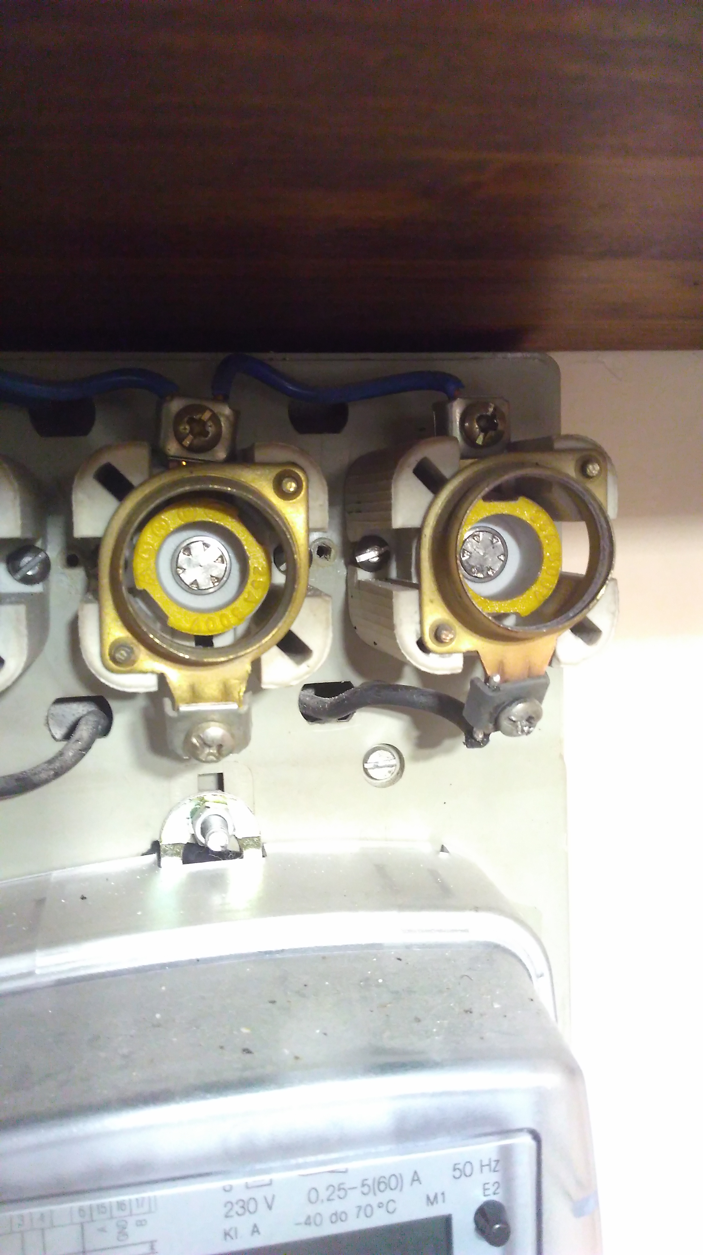

  • #24 15789303
    RAJZON
    Posts: 22
    Rate: 25
    Illuminates on all top, bottom only on the one from the light (left first)
  • #25 15789307
    piotrek22101
    Posts: 3323
    Help: 695
    Rate: 1417
    This means that the fuse is blown / damaged. There should be tension on the foot in the middle.
  • #26 15789313
    snakess
    Posts: 52
    Help: 10
    Rate: 13
    And which one is from sockets?
    Probably the fuse is defective.
    Put that "lights" in there for a test.
  • #27 15789318
    RAJZON
    Posts: 22
    Rate: 25
    Today I bought a new one, changed them all, even the old non-automatic screwed on which was light
    However, it does glow, I checked wrong

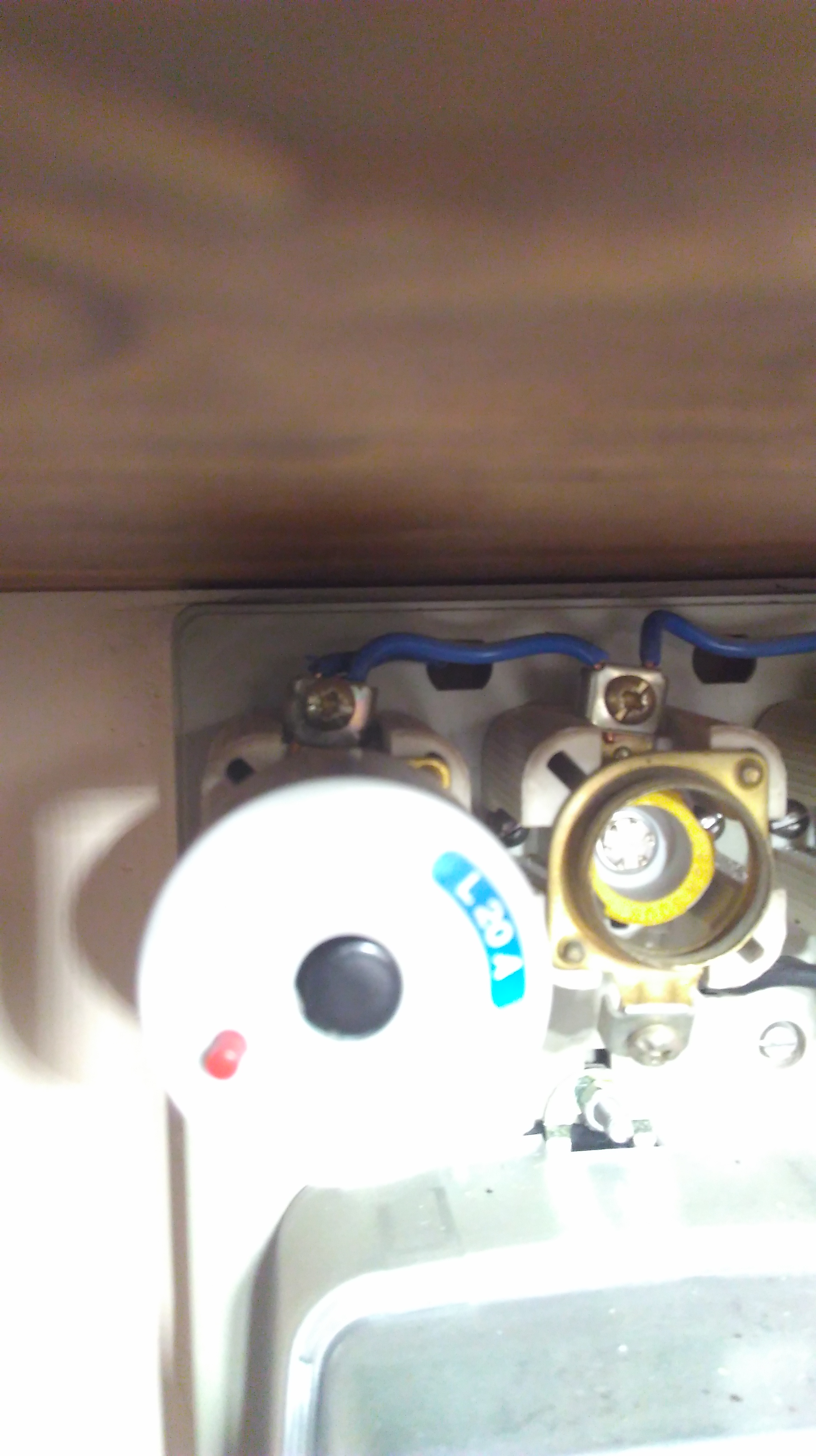

  • #29 15789335
    snakess
    Posts: 52
    Help: 10
    Rate: 13
    There is no wire at the bottom of the middle one.
    Put a few more photos of all the "fuses", not just 2.
  • #30 15789342
    RAJZON
    Posts: 22
    Rate: 25
